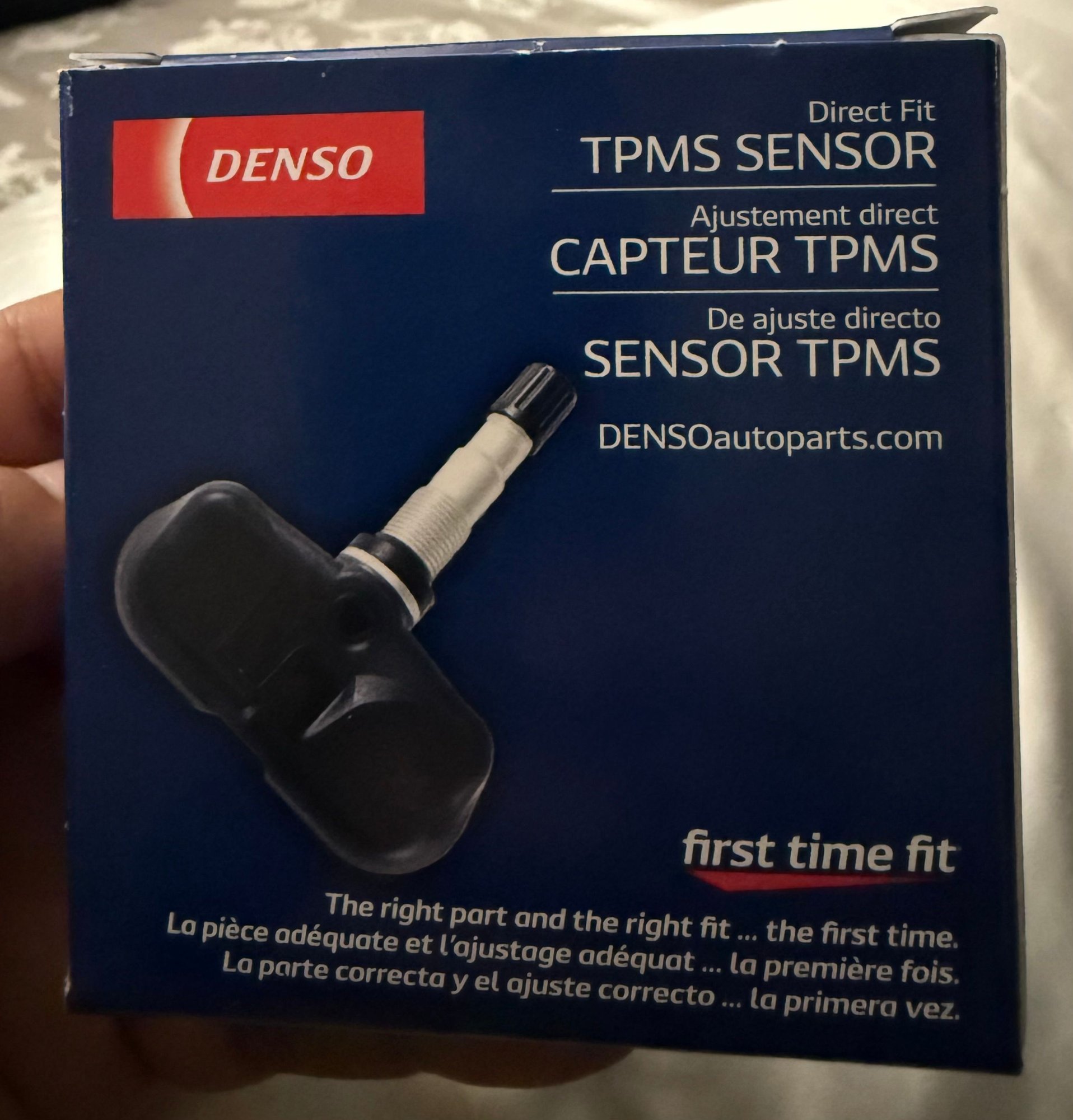

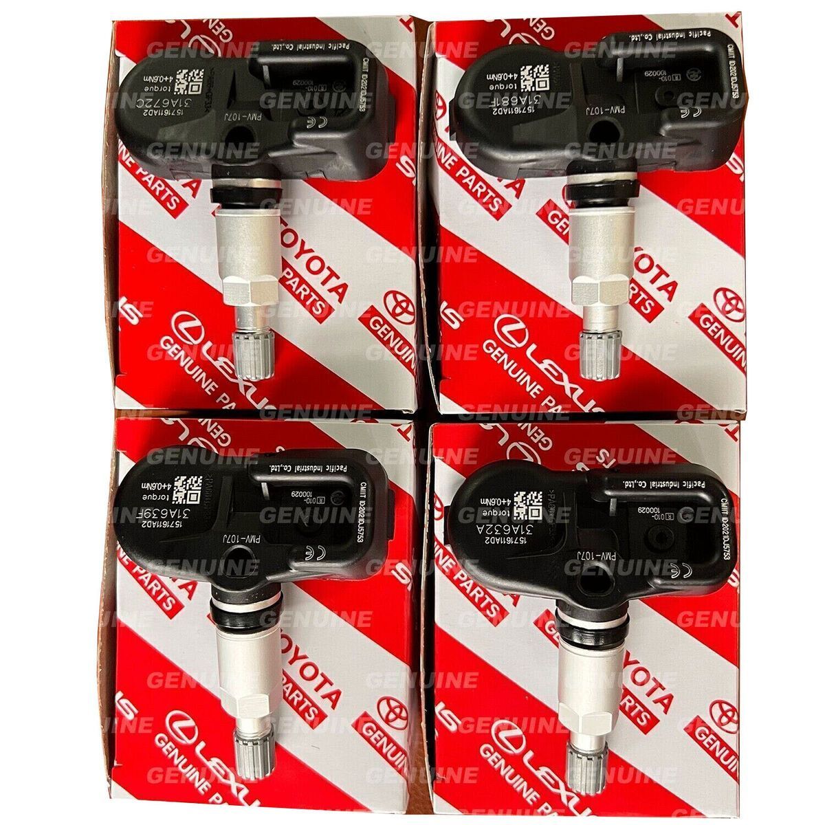

The picture is a Pacific Sensor in a Toyota box. I honestly am not sure what your point is. Dill also repackages Pacific sensors also. I would recommend that the replacements used are Pacific, Dill or Denso but they are all Pacific sensors in a different box. Wouldn’t pay the extra for a Toyota/ Lexus box that’s for sure

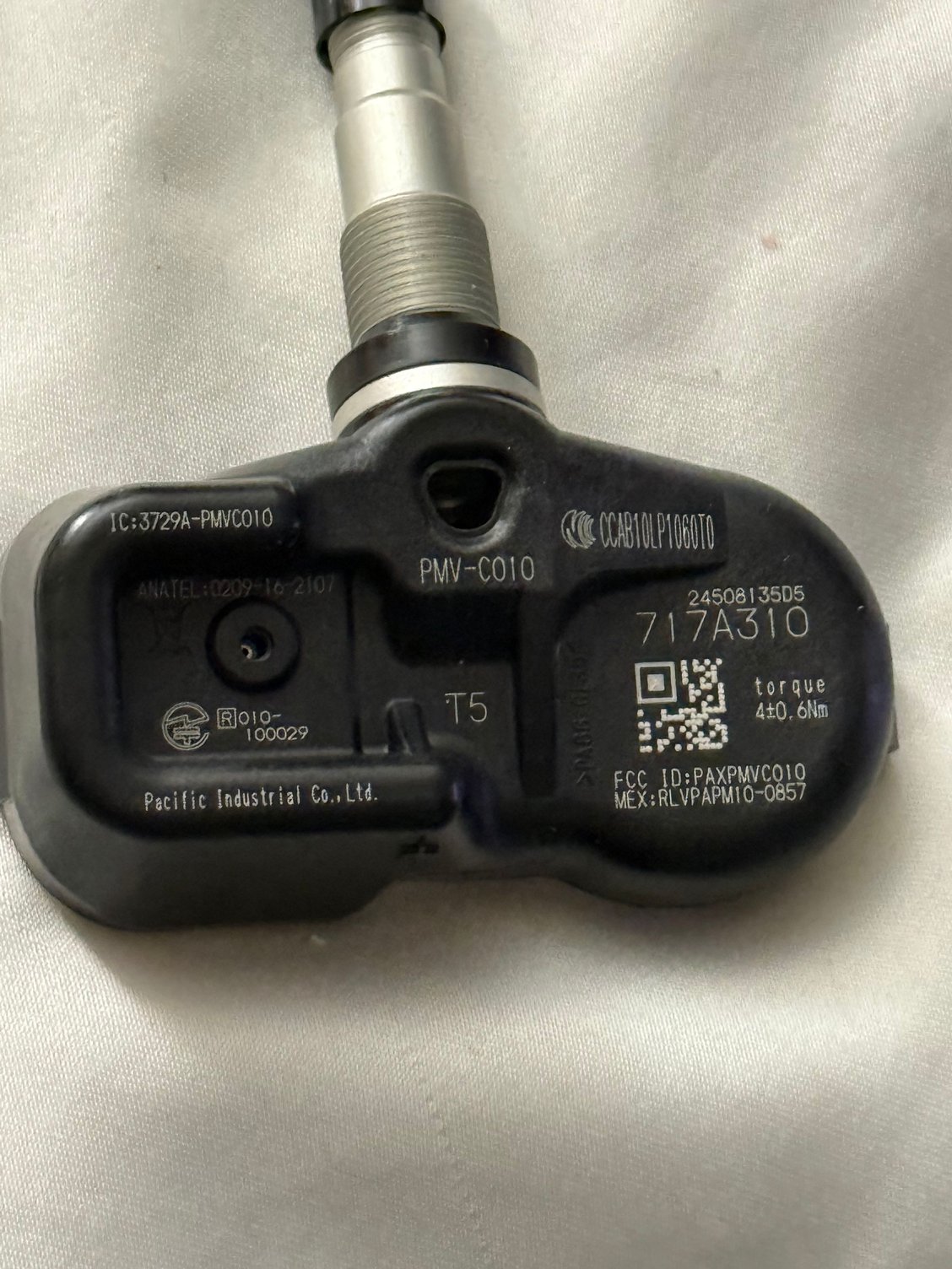

Not trying to keep going back and fourth but I can tell you for sure that if you buy a Dill sensor for our vehicle you are going to find a Pacific stamped sensors inside the box. Just like the Denso one. I’ve bought hundreds and the Dill 1218 is a Pacific sensor.
https://www.dillvalves.com/product_cpt/1218-oe-sensor-2/
And these are pics of an actual “Denso” sensor that I have

For anyone that wants to know how old their Pacific Industrial made TPMS sensor batteries are.
If the TPMS sensors were made by Pacific industrial (for Denso or repackaged and offered by Dill, provided by Toyota/Lexus or Discount Tire, etc.):
The above TPMS sensor has a date code of '13C19' which means this particular TPMS was built in year 13 (= 2013), of month C (= December), on day 19 (=19th).
[This particular TPMS was manufactured on December 19, 2013 which includes its nonreplaceable integral battery]
