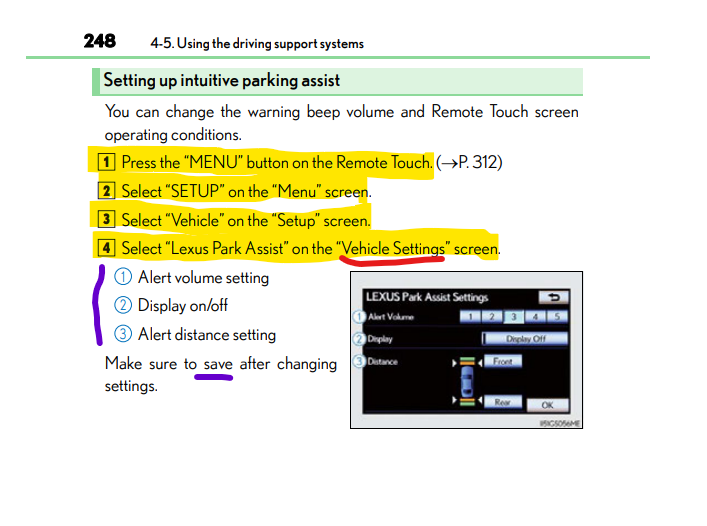

And you checked in settings that the display is on, and sound is up?
Page 248.

You should see the parking sensors on the information display, but ONLY as you closely approach an object (e.g. car, wall, etc.).
You won't see the sensors on the information display while parking unless you get close enough for the sensor sensitivity to alert you.
Have you gone into your 'Vehicle Settings' to see if the IPA display is even turned On? Have you set the sensor distance sensitivity? Have you set the sensor alert volume? If not, why not?

He needs to go into the middle Display into Menu, with the Mouse and find the Park Sensor setting to confirm they are not cut Off.

I believe his IPA settings are in 'Vehicle Settings' and will appear on the 12" NAV screen.
