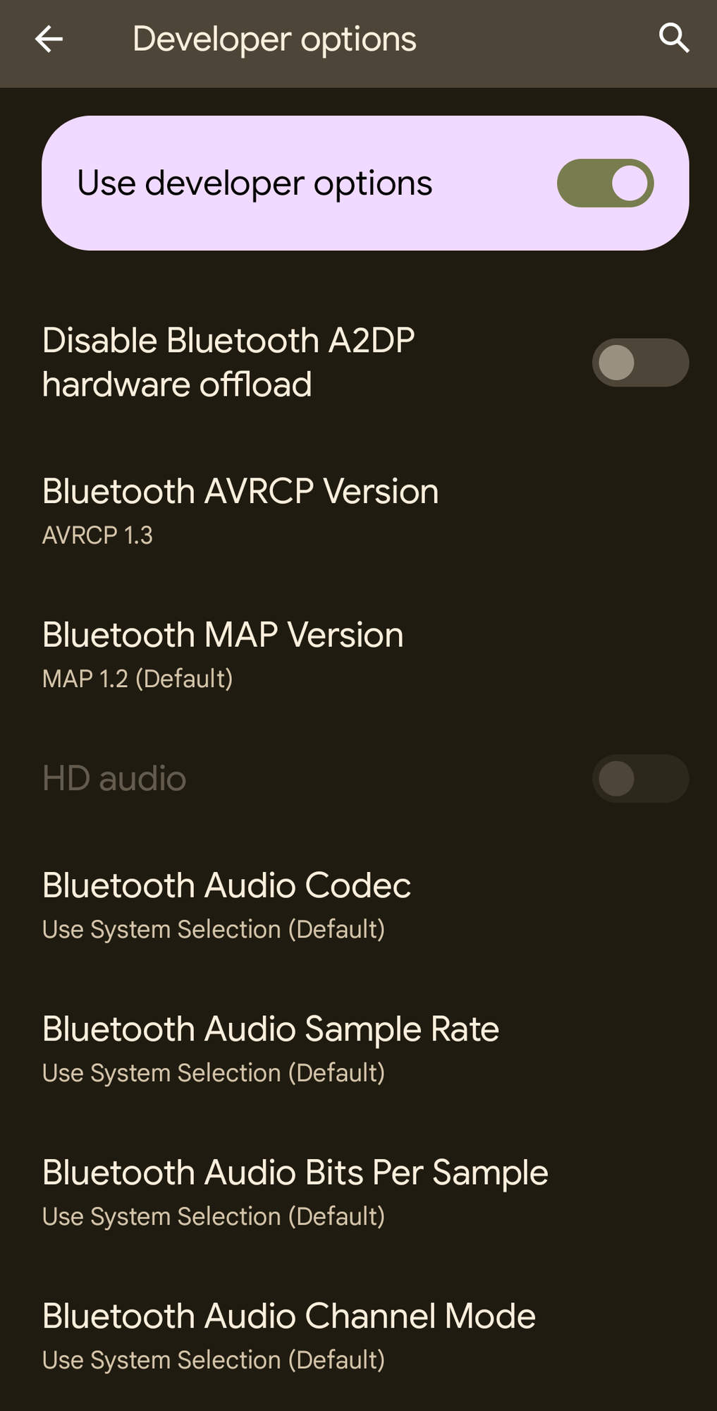

Default try different Bluetooth version
Did you try different versions in Bluetooth version in settings? Try switch to older version to see if it helps.
Like mine, I have to use 1.3 to get my car to show the metadata when playing music thru my phone.
That's really interesting. I didn't know that was a thing. I am currently using 1.4.
I cleared all my Bluetooth devices and re-paired my phone today (after a restart didn't work) AND turned on phone calls and media between the phone and car. He car is still passively connecting though. I did this after restarting my phone this morning before driving and this afternoon before driving.... to no avail.
I also wear a Fitbit sense. It also gets stupid and stops talking to my phone sometimes. This is the 4-5th time this month it's simply stayed disconnected all day because it's messed up again (and this is why I hate updating firmware because it's ALWAYS without bugs, right?). I'll let it be stupid for a couple more days, then I'll just switch to my Tissot for a week. If it clears up then, well, I guess I'm going to work in style from now on.
I don't think firmware update messed up the Bluetooth. Did you try different Bluetooth versions?
If you don't want your car receives phone call, turn it off in the Bluetooth settings.
