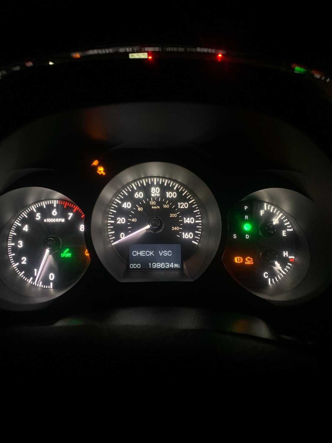

Hello guys I have a 2006 Lexus gs430. I’ve had a vibration at idle for a while and I changed the engine mounts and transmission mounts yet it didn’t help. It only vibrates/misfires in D or R while stopped when I start driving I don’t feel it. And when I put the car in N or P it idles normal. When it’s in D or R and idling it idles at 550rpm which I don’t think is normal. But when put it in P or N the idle returns to 650rpm which should be the normal idle. I’ve driven around with this issue for a while because the check engine light would only pop up when I would leave it in D when I came to stops. (I always put it in N because the vibration is bothering). First time it popped up it read misfire cylinder 4. So I changed all spark plugs and coil packs (OEM). But the issue was still there. (The check engine light pops up if you don’t put it in N for multiple stops). So I just decided to not dig deeper and just kept putting the car in N when coming to all stops. But I eventually got tired of putting it in N and starting leaving it in D at stops. And sure enough the check engine came on again. After a week of not putting it in N at stops I came to one stop and was sitting there for about 2 minutes and the check engine light started flashing. I put the car in N and after 4 seconds it stopped flashing. Now I’m just tired of the issue and want to get over it and fix it. I’m thinking it’s some type of idle sensor but not really sure and hoping it’s not something big. I want to try and fix it myself before I take it to a mechanic. Also every time the check engine light shows up it says check VSC aswell. Sorry if I explained it bad this is the first time I’ve written on a forum. Please feel free to ask any questions. I’ve attached pictures of the check engine and check VSC.
Every time the check engine and check VSC light turn on it also turns off the traction control.
