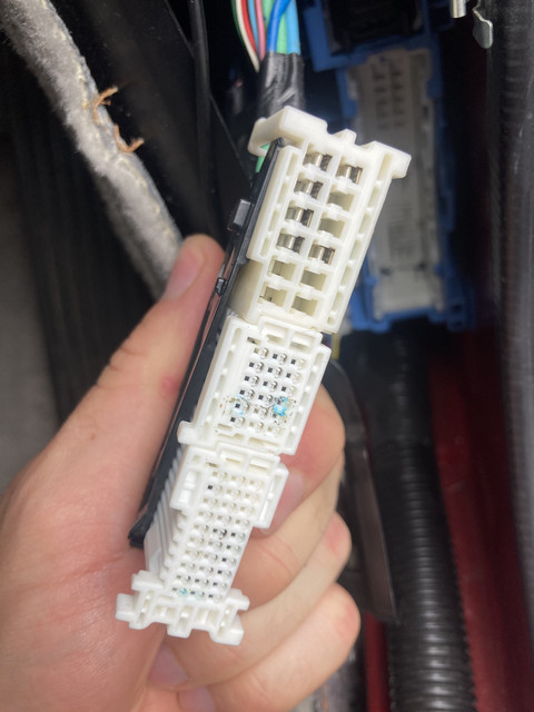

So in my case it is a water causing all the problems.
First time it happened few hours after a car wash but I didn't connect the dots, then it was gone and car was all good for few days till heavy rain came yesterday and car went crazy again.
I had a windscreen replaced recently and it seems like I have a leak somewhere as I've found driver side carpets wet when I've checked them after the rain.
There is a bunch of connections on the pillar next to the gas pedal and you can see what I have found there.
After cleaning the connections with electrical contact cleaner all the lights are gone and everything works as it should. Now I'm waiting for the insurance to sort the leak out.
I think its no.16 on diagram and whatever is right next to it, maybe it's a same thing in yours. Good luck!
