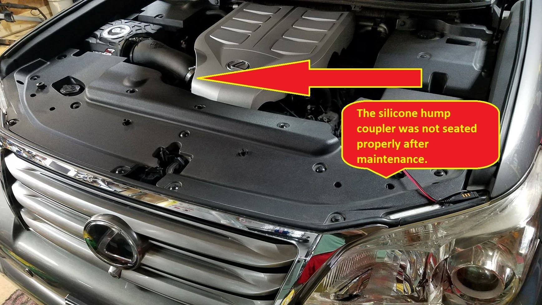

I have a 2010 GX460 with 98K, Driven mostly on the highway for long periods of time and then park in the garage for weeks/months at a time after use. I've only seen the aforementioned group of lights come on 2 times. Once for the secondary air injector (replaced by Lexus) and once because I didn't double check the aFe Momentum air intake hump coupler and it wasn't completely seated on both ends.
