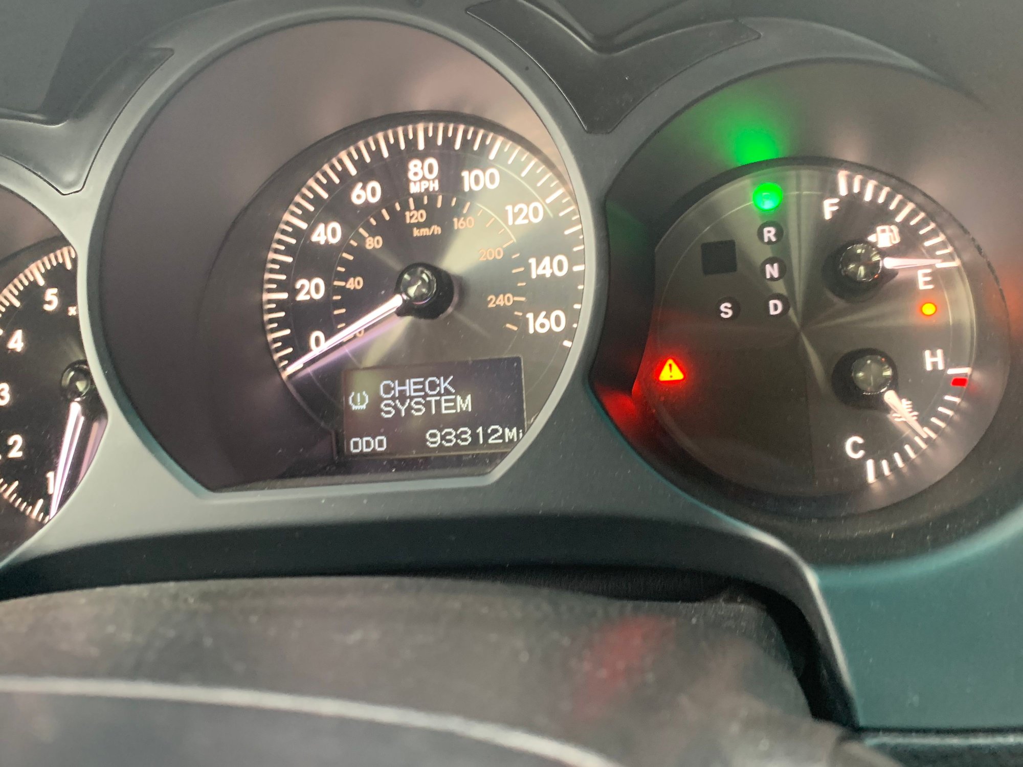

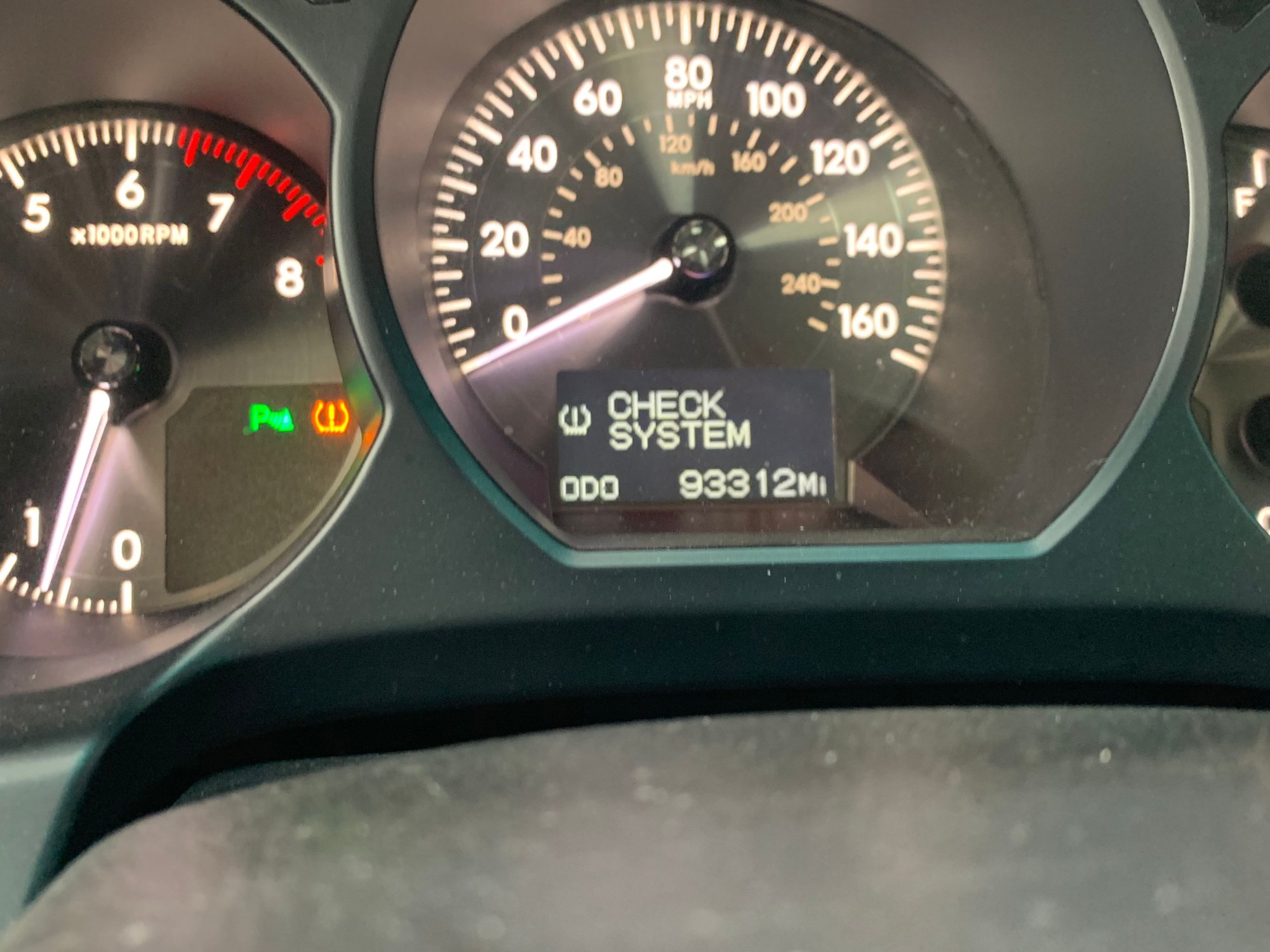

Default I think I have the similar issue.
Originally Posted by SeanTrini
Hello All,
My tun for my car (2006) to get hit with the TPMS warnings. I realize each of the tires, including the spare in the trunk, hav a tpms sensor and each of the senso has a limited life battery. The battery is supposed to last ~10 years from what I read. Considering my car is 2006, does that mean all the 2006 models will need to replace the sensor if not done already?
I recently bought new tires so i had Costco re-checked and verified the tire pressure are correct in case one of the valves may go bad during the install. Costco is saying the sensor is bad. So I guess I will proceed with the replacement. The local dealer is charging -90 per sensor but it only cost -25 per OEM sensor on eBay. Anyone purchased purchased from eBay and not having issue? I worried they are perhaps old stock and the battery in those eBay sensors won’t last another 10 years (or at least few to several years). Costco is quoting -50 per sensor. Also I assume I’ll need to replace the sensor for the spare too? So 5 sensors total.
I did verify the button under the glove compartment is correct.
any wisdom/insight you can provide is greatly appreciated!!
I would like to know. What's that caution ⚠️ light for, because I have that light in my 2007 Gs350
You may need to cycle through the MID/Info screen in the gauge to see what message is coming up with the caution light. It could be anything from low tire pressure or a malfunction that's not major.
Thanks for the information, as you mentioned. I did check the info in the dash, all I could see is the Tire pressure info.
Tire pressure info? It probably saying there is something wrong with the TPMS like a bad sensor or low PSI.
