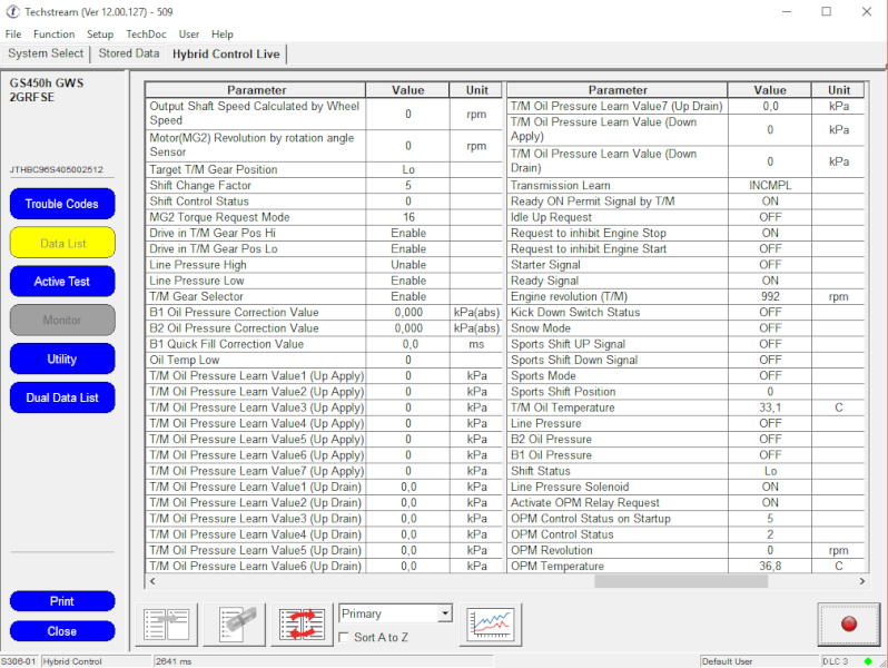

The oil was 36,8Celsius when I did open it and let it tickle. For now nothings has changed, still the P0867 Oil pressure code and nothing has made any sense. I do hope when I change those 3 sensors in the gearbox then everything will be better. Maybe I'll even do some pictures and make a DIY when this helps so anyone who faces the same things will get help.
Let's hope for the best. The gearbox does not make any noise neither does it act up. I do hope that the sensor aren't giving any readings and that's why it is like that.
PS: Techstream T/M Oil pressure readings are all 0 so I think the sensors aren't cooperating anymore.

Clear the code, it might not go away by itself.
Also, you can try going to hybrid control->utility->reset memory. Transmission learn is "incomplete", not sure if it will become "complete" without doing that.
I'm not sure if it's a good idea to do that given the pressure sensor situation, though - I think it switches between the two gears while doing that, and that might leave you stranded.
In other words, if you'll be doing this, assume that you might not be able to move the car afterwards... and don't do it if you can't afford not to.
