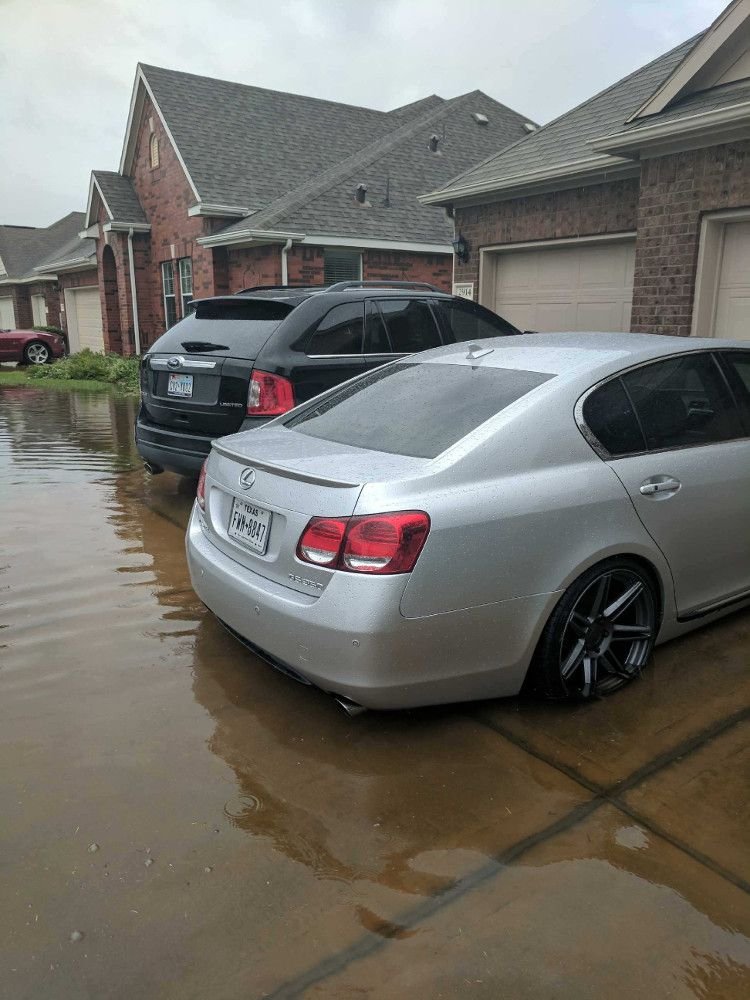

The moon roof still works so it's not that fuse. Did you happen to get a chance to check your engine bay fuse panel? I'll probably just call the insurance company later today if I can't figure this out since I am sure they are slammed and I'm probably going to have to wait a while before anything can get resolved. Just odd to me that some standing water up to the rack would have disabled it, the rack was not even fully submerged from what I can tell by the debris line under the car.
It was up to just the very bottom of the rear door seal and got in enough to soak the carpet but not enough to get on top of the weather tech floor mats. And the car sits at a slant in the driveway so it was even at a lower level up there. This pic was after the water had receded the day after it was up enough to get in the house and that little bit in the car.
