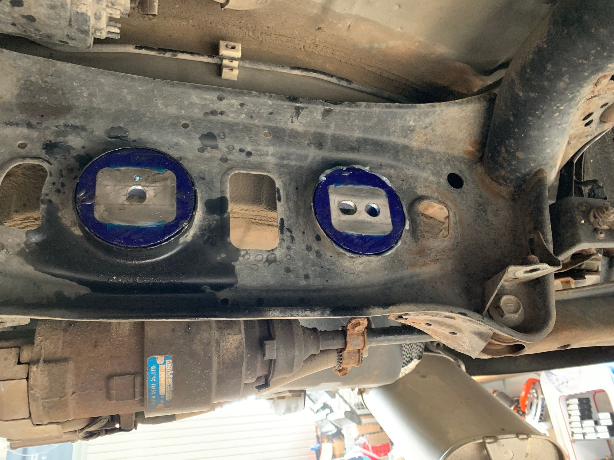

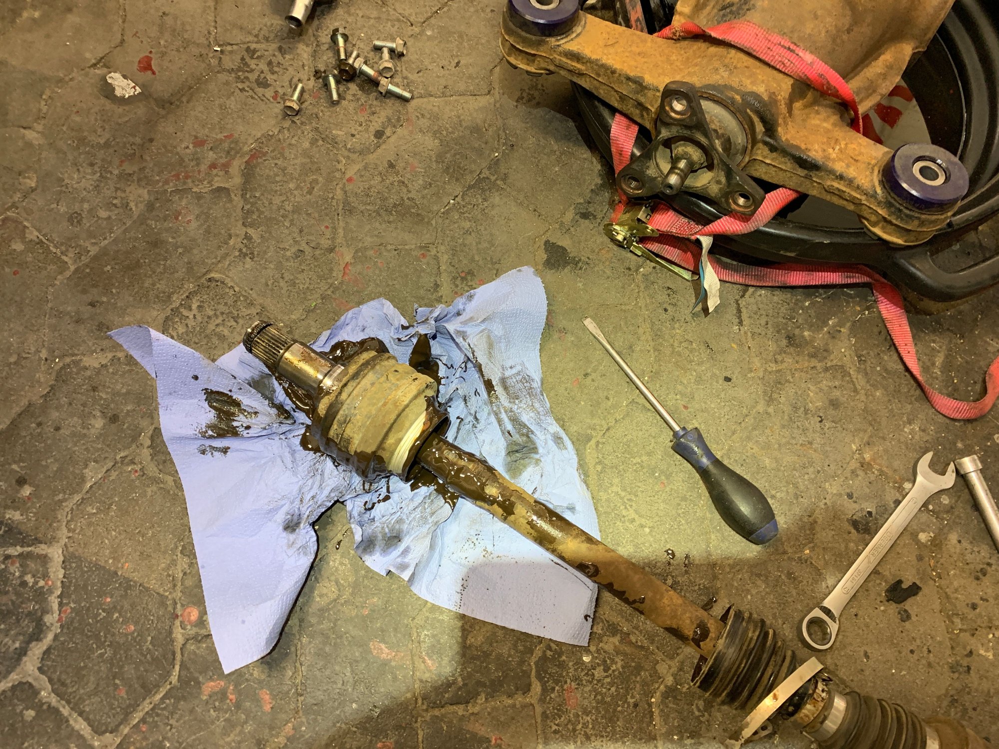

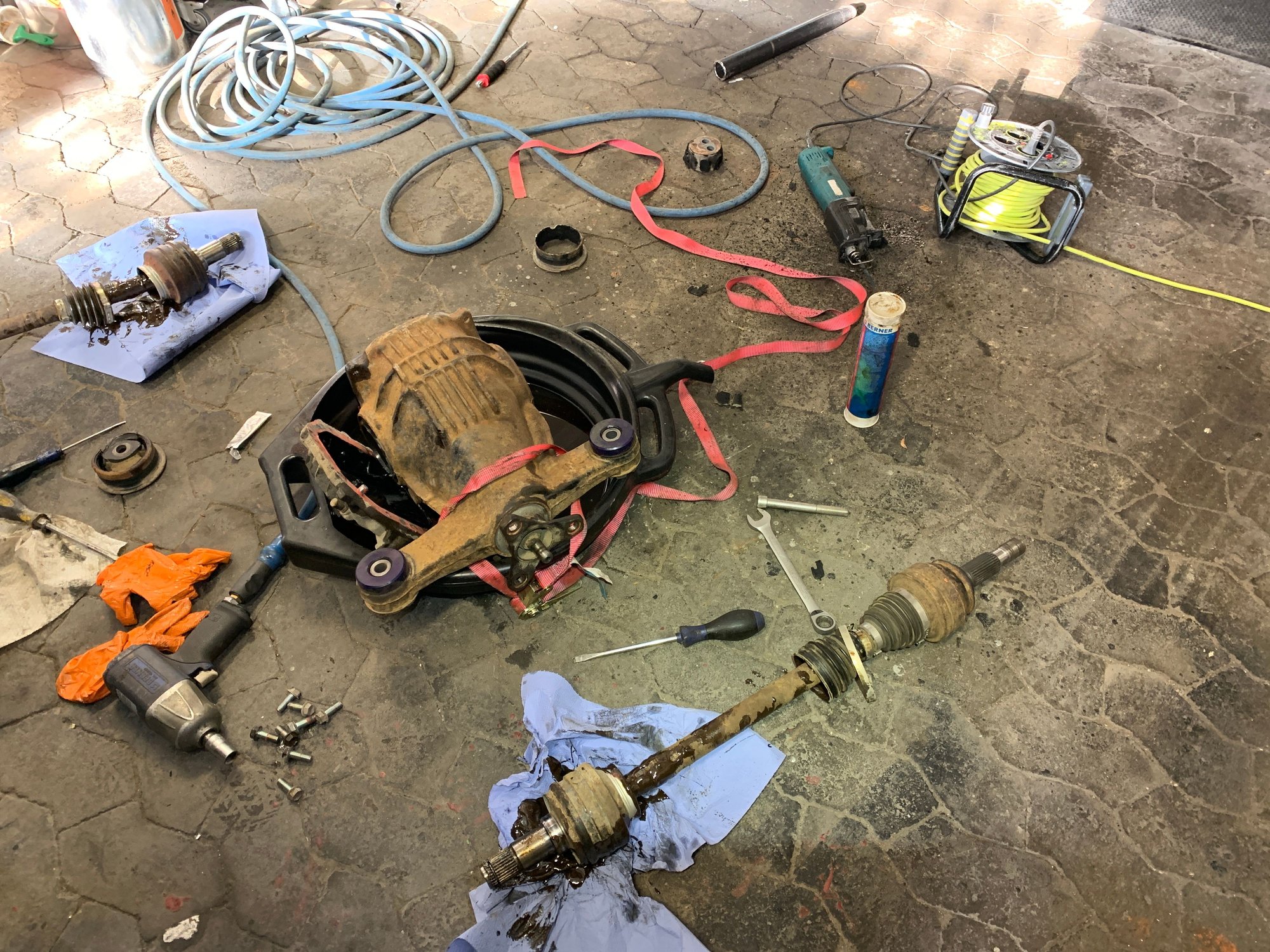

Hi
i inspected yesterday at all. I open also the Diff and the drive shafts. By the drive shafts are the fat in the booths like liquid. I wash them and add new fat. Also i add the SP Bushings.Tomorrow i install the new Diff and we would see what happens. Cross the fingers.

I got today the "new" Diff. So definitely is the old one broken. You can hear it here the old one:
