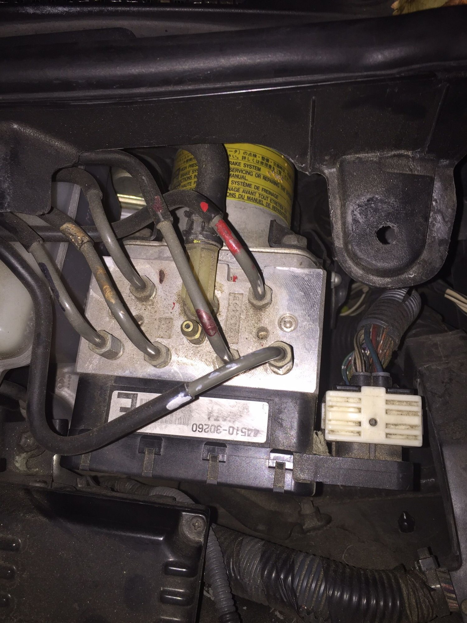

I have taken my 06 GS430 to Lexus and one other shop and they have both said I need to replace the ABS actuator pump ($3K + Labor !!!!!!!!!)... I have searched HIGH and LOW for this part as well as used; NO LUCK. My question is, can this part be rebuilt? Also, is it possible for it only to be the fuse that has gone bad? There is a constant buzzing sound coming from the actuator while driving and shortly after car is turned off. ANY help??[B] My part # is 44050-30670
I have attached a picture of my part

According to the pic of your actuator the part number is 89541-30260.
If that is the actual pic of the one in your car, then it is the same as a 2006 rwd gs 300.
Go to car-part.com type in your info. There are plenty on there for $150.00 and up. Good luck

Yes, this is the actual pic of the part that's currently in my car. You think the Gs300 will work??

Heres one with your exact same part number 44510-30260
Only problem its overseas
http://www.buyitmao.com/products/39503011225
