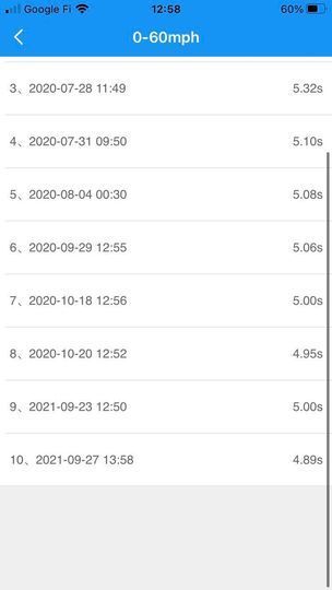

Lol I clearly said, "I haven't done much research", believe what you want. I'm just basing what I said off of a couple CL posts saying the same thing I am. Everything else I said is just fact, most of the fast builds are NOT running aftermarket solenoids, but hey maybe you know something we don't.
My dragy times and Dynos have been posted, with Invidia midpipe and Sector7 tune, I dyno'd 299whp, similar to stock LS460s. With that same set up I run consistent 13.2s in the quarter. You can find it all in the Dragy leaderboards.
My 0-60 improvements, 3-6 were all with the same mods, so using times to say a part or tune helped, isn't always accurate, a slight change in ET, could just mean you got a better launch, or your KCLV improved.

Nice job, I'm impressed....but it is still not all that quick.
