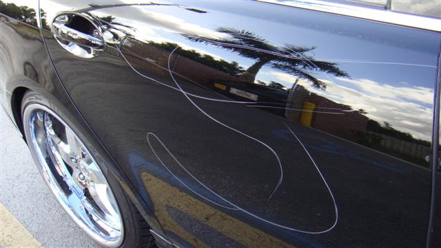

The main part of the scratch was on the rear pass. door.
It took me 1 hr to color sand most of the scratches out and polish it out. Some scratches are deep. So later I will have get it repainted.

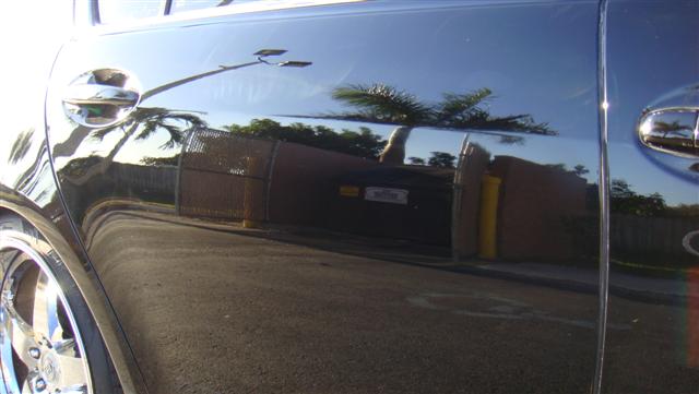

After compound and polish
So glad I took autobody class yrs ago And autopia.org was a lot of help.

Thanks, this what I did.
I wet sanded as much as I could.I used 1500grit sand paper.
Then 2 passes with menzerna power gloss compound using a porta cable rotary polisher and L.C. yellow foam pad.
Then used l.c. green pad,2 passes with that and menzerna intense polish.
2 more passes with l.c. orange pad.
Then finished with a porta cable 7424 D.A. polisher with sonus blue pad with sonus final polish.
