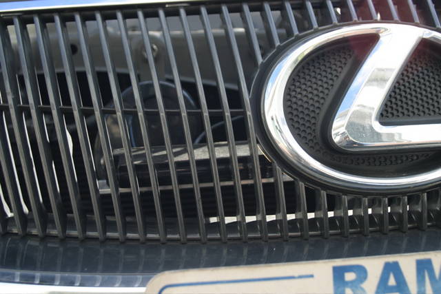

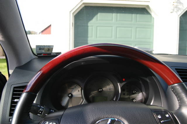

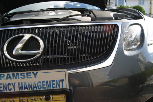

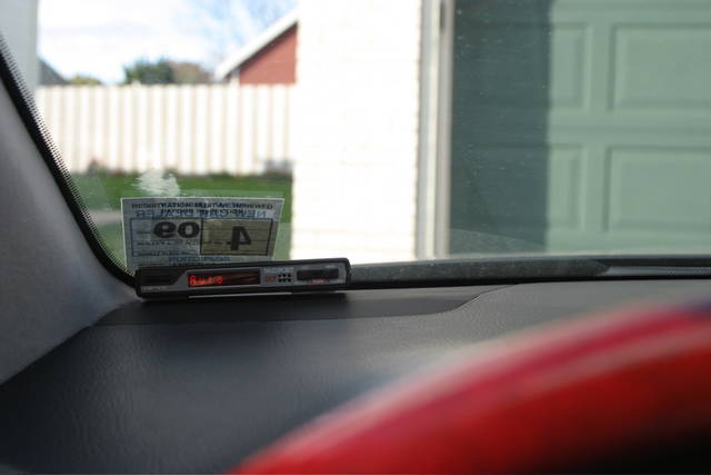

will take pictures for you in the morning when it is daylight out. I dont have teh laser shifters only detectors front radar and laser is in similar postion behind grill and head unit is on dash against windshield. Will post detailed pics tomarrow.

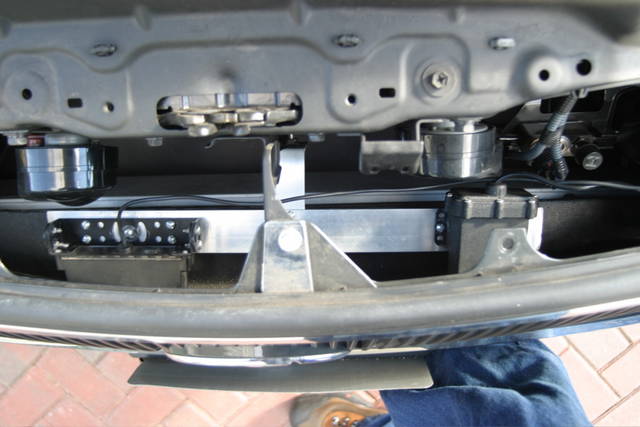

I need to shift the bracket with the sensors over since the laser is behind the emblem at bit.
