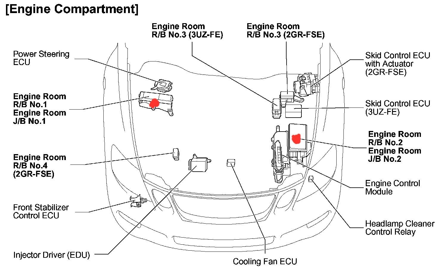

Im definitely thinking they intentionally pulled a fuse, or a fuse is blown? Could anyone point me in the correct direction of which fuse(s) I should check and which fuse box?

Questions:
- What year and model?
- Is there any other function on the car that doesn't work, or codes?
- Before replacing the passenger headlight assembly, did either of the headlights work or was it the same exact issue?
- Do the fog lights work? DRLs? tail lights?
- Did you check volts and resistance on the relay? The fuses were getting power with the car on?
- Is it intermittent? When you unlock the car do the headlights flash?
- The giant connector for the headlights that sits under the front bumper, did you replace the harness from there on to the headlights? Or the complete harness that leads to the body of the car?
- What part number/link for the harness?

questions:
- what year and model? 2006 lexus gs350
- is there any other function on the car that doesn't work, or codes? No
- before replacing the passenger headlight assembly, did either of the headlights work or was it the same exact issue?
Functioned correctly
- do the fog lights work? Drls? Tail lights? Yes
- did you check volts and resistance on the relay? The fuses were getting power with the car on? No
- is it intermittent? When you unlock the car do the headlights flash? On passenger
- the giant connector for the headlights that sits under the front bumper, did you replace the harness from there on to the headlights? Or the complete harness that leads to the body of the car? Just giant connector sits under front bumper. Giant connector headlight
- what part number/link for the harness?
