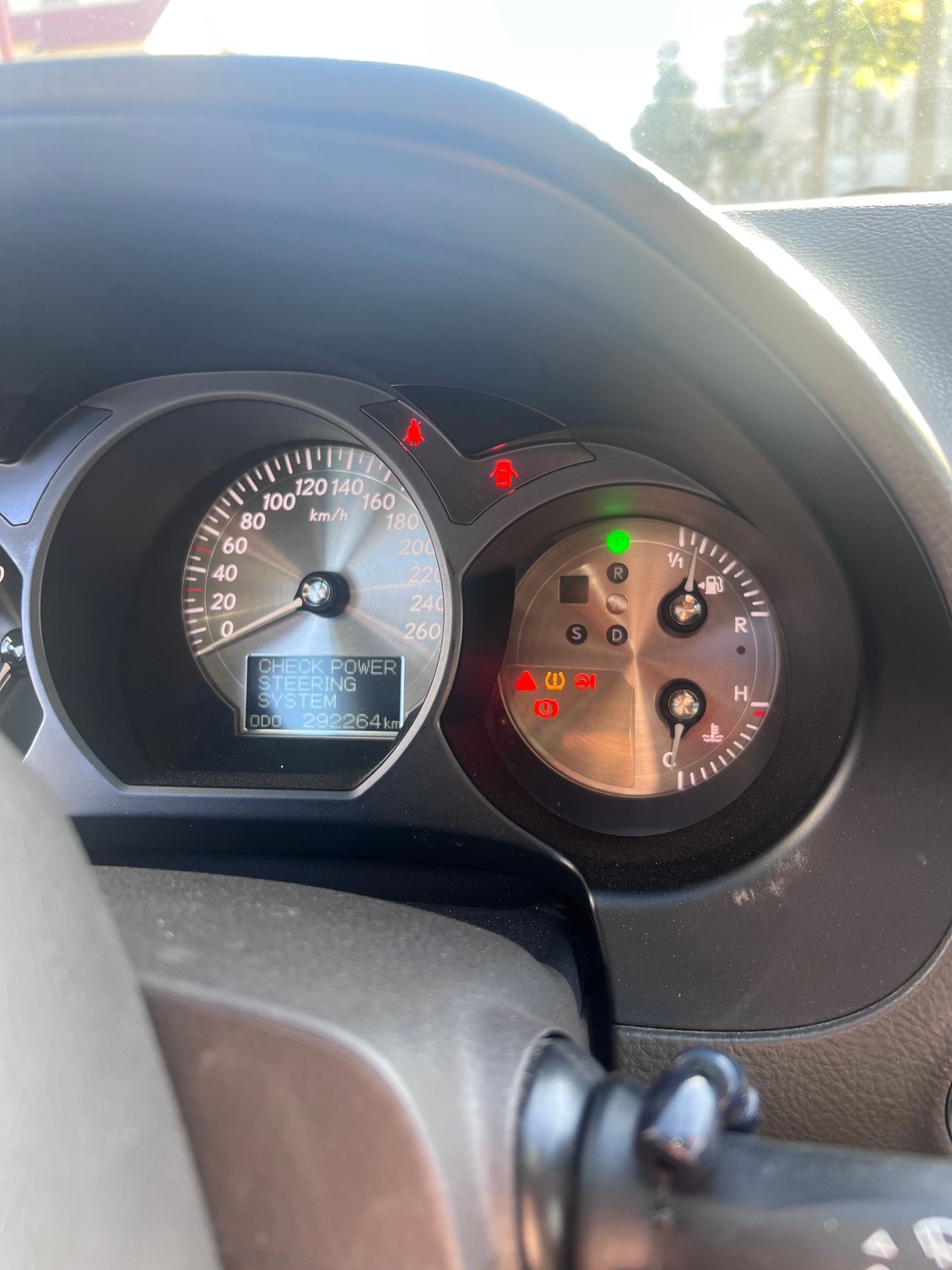

Hello guys so I have a problem with my steering wheel. In a rainy day I drove my Lexus gs450h 2009. After a day I trying to turn my wheel and he’s hard as rock. And a check pops up (in the photo). So in my opinion I think it’s an ecu steering.
if it’s the ecu steering can someone help me where can I locate it? To find the serial number. Thanks

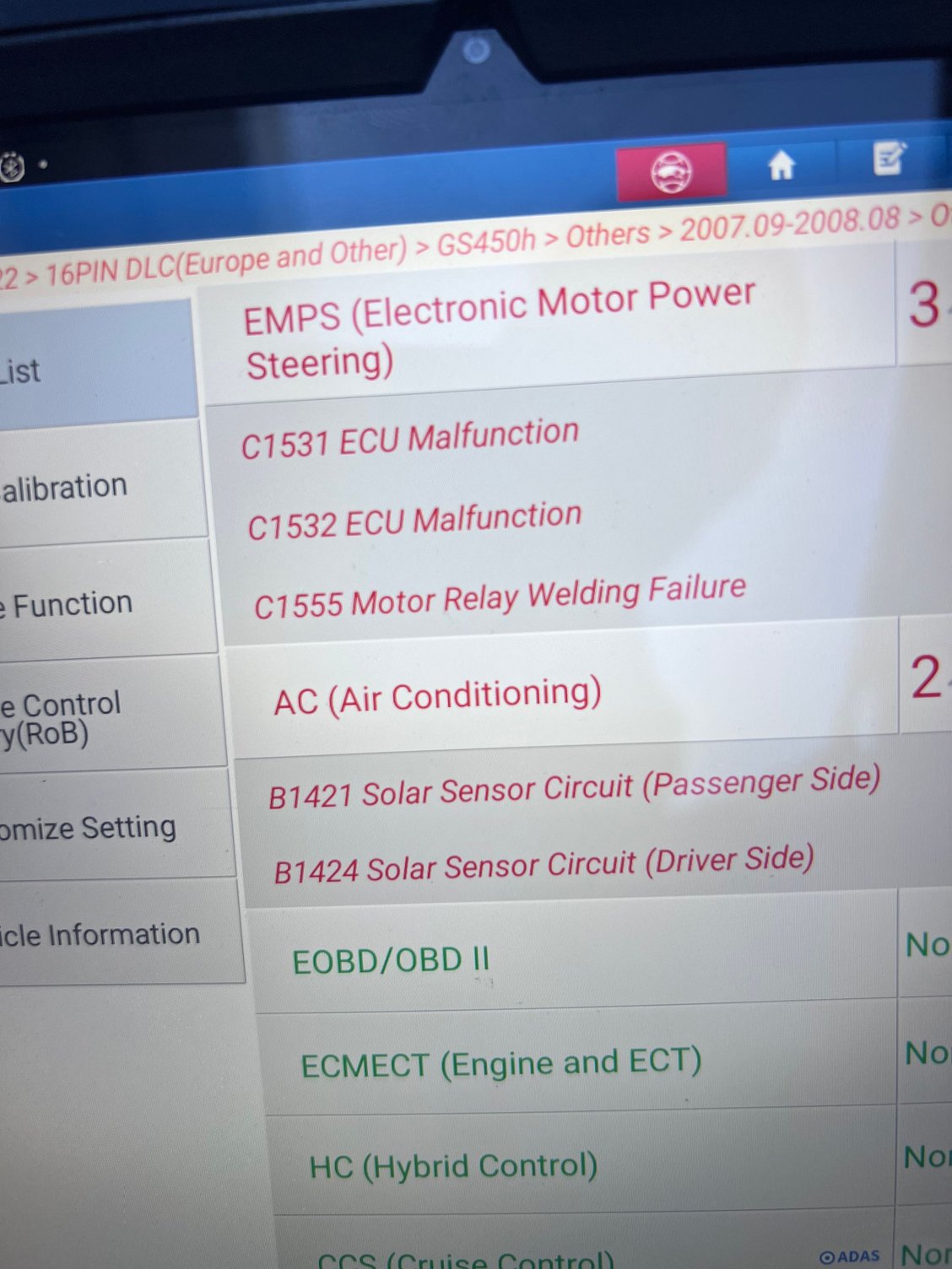

So I went to mechanic and this is the problem
Old Jan 21, 2025 | 09:56 AM
skur's Avatar
skur
Joined: May 2022
Posts: 194
Likes: 52
power steering ecu

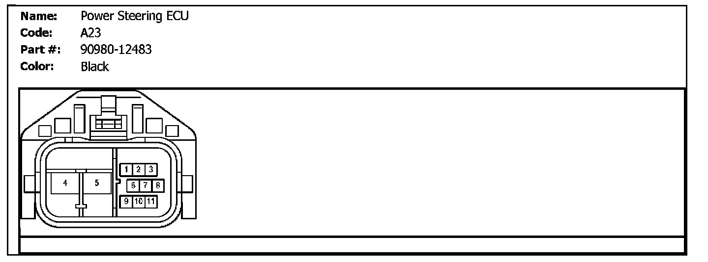

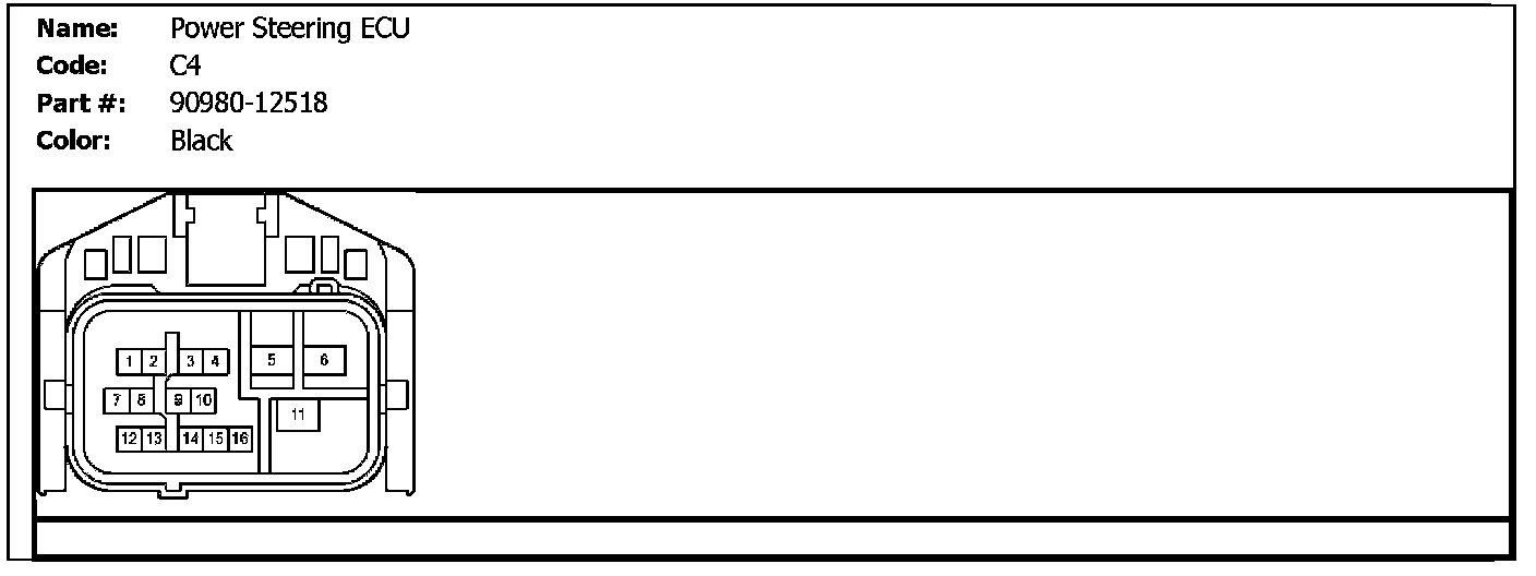

Just to continue this same thread and not start a new one: Is anyone good at hunting down a part number? I found that my harness that goes from the EPS ecu to the rack itself doesn't have continuity in a few wires and just need a new harness. I can't seem to find just the harness if anyone could assist? 2008 GS350 RWD.
Old Jan 23, 2025 | 08:00 PM
skur's Avatar
skur
Joined: May 2022
Posts: 194
Likes: 52
Which connector matches the one that broke? It varies depending on the engine you have.
After finding that I would go to parts.lexus.com and put in your VIN (I can't do it because idk what your VIN starts with). Look through the WIRING & CLAMP diagrams. This shows all the harnesses in the engine bay. Knowing the connector size is a good start.
