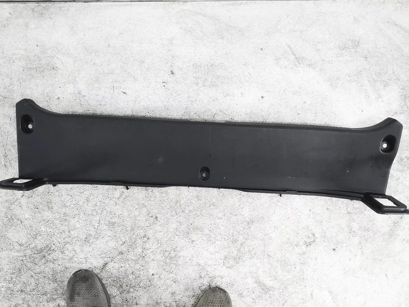

Good afternoon fellow Clubmen,
Can someone please assist me in knowing what hardware (screws or clips) go on this rear trunk molding. In my build I am now cleaning and tyding up the trunk and there are NO hardware holding anything there. If you also know what hold the carpeted side trim, that would be a plus. The Online schematic are very basic and show the major components but not minor nuts, bolts and clips. If you have a link, that'll be swell as well. Before posting here I do a search, but when I cant find the parts I depend on the Club.
Thanks!

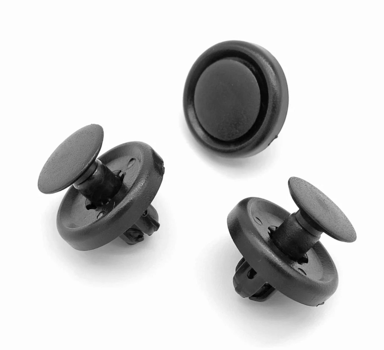

It's held in with the same barbed trim clips that hold the trunk lid liner but with a plastic retainer. The retainer piece on mine cracked with age, so I just replaced all 3 with these generic trim clips.
