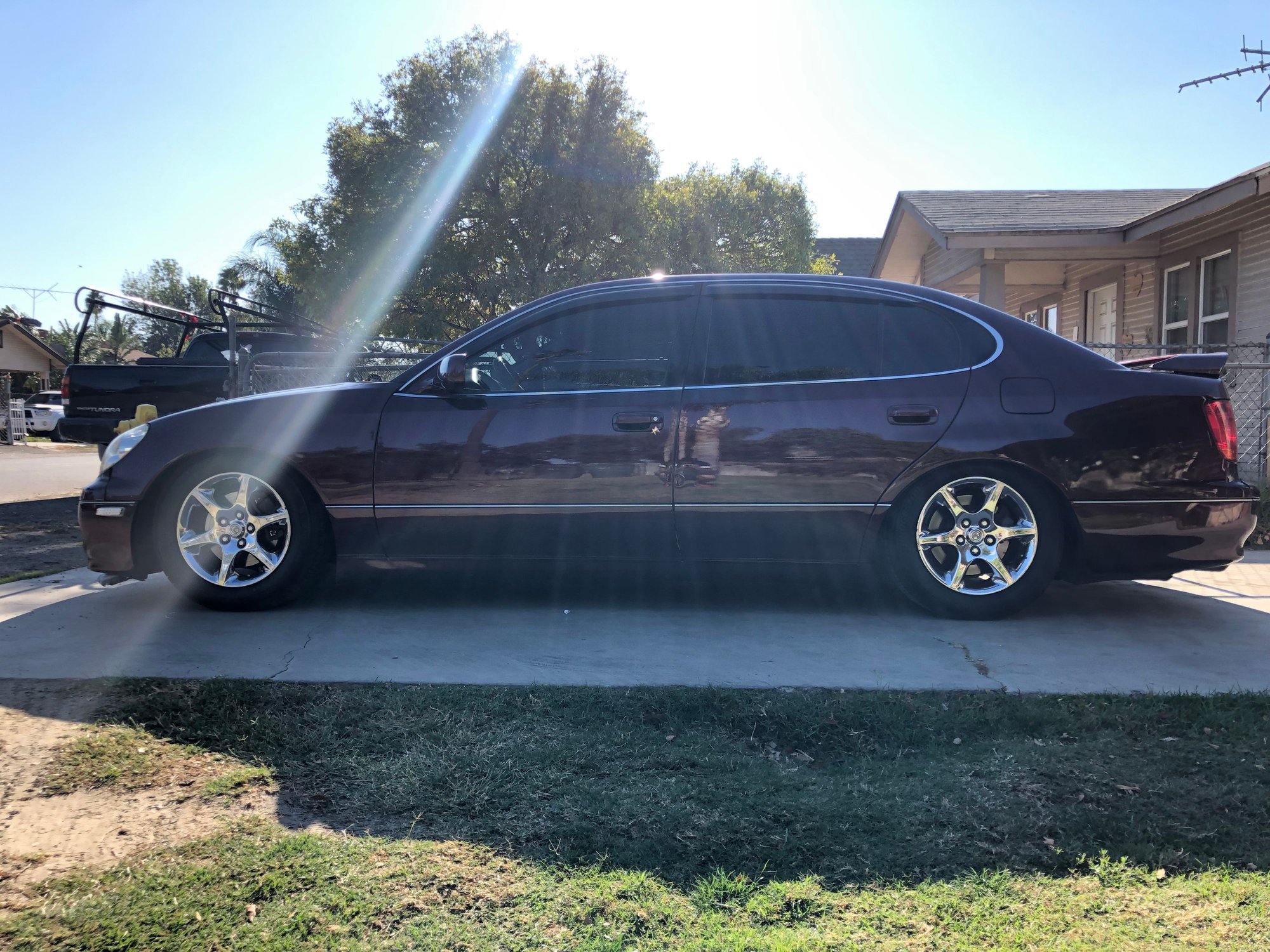

Should I go full straight pipe or just go with a resonator delete? Is straight pipe obnoxiously loud?

Regardless of whether this is a GS300, 400, or 430, if you straight pipe the exhaust system it will not sound good. A few teenage boys might like it, but everyone else in the world will hate you. This isn't just about volume, but the quality of the sound as well.
It looks like you have a nice ride there. Please don't add to the variety of clapped out second gen GS's of the world. If you're going to mess with the exhaust start with quality aftermarket mufflers, then work your way towards the front if you still want more.
To answer your question directly: Yes, straight pipes are obnoxiously loud.
