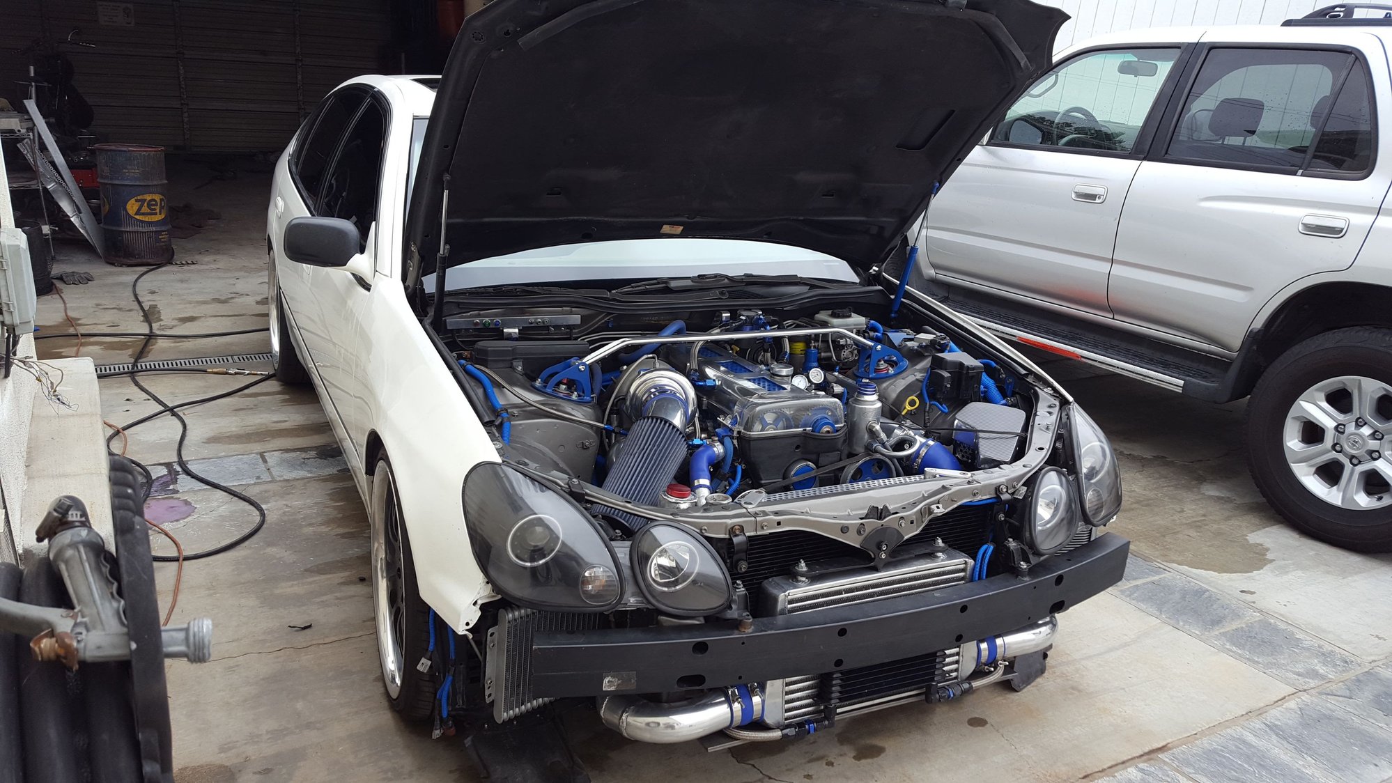

Can anyone tell me if my 2jzgte need a programmable ECU just to start it for the first time after build. What I have changed. 67 mm single garret turbo. Ported n polished intakes. After market intake with top feed fuel rail and 1050 cc injectors. A set of mild cams. Ported and flowed the oil pump. Fuel cell with 10 AN feed line and 8 AN return. AREOMOTIVE fuel pump and regulator. It almost starts but it just refuses to run. Someone told me it will never start with the stock ECU. IS THIS TRUE AM I WAISTING MY TIME TRYING TO GET IT STARTED.. ANY IMFORMATION OR ADVICE WOULD BE APPRECIATED.

Your car looks nice and clean. Are you trying to start it with an Aristo ECU? If so, and if it is indeed an immobilizer-enabled ECU without the accommodating keys, you will not be able to start it. You'll want to locate an non-immobilized Aristo ECU or you will have to talk to a locksmith or Lexus about a possibility of linking your keys to the immobilized ECU you have.

But if you are on stock GS300 ecu and key, I'd start with double checking the fuel system and get a pressure reading. You did a lot of fuel system mods at once and it's easy to have made a mistake somewhere. Another thought, those injectors are huge and maybe you are dumping too much fuel straight into the cylinders fouling the plugs out? If you have a scanner handy, look for rpm signal etc. On that note.. if you are on stock GS ECU and running a GTE throttle, I don't think that the car would run.. I'm sure there would be too much missing information for the computer. I don't have an answer for you, just some logical things to consider off the top of my head.

It's the aristo ECU and it is set and ready for my keys. It coughs pops and almost runs but won't. Pull a plug and it is geting fuel. 43 psi fuel pressure

You're trying to run 1050cc injectors and a 67mm turbo with a stock map?

I mean, yeah. Management [of air, fuel, and ignition] is a pretty key part of taking drastically more air and fuel. You don't have to bin the whole project, but you do need to complete the process with an appropriate engine management system.

You should be over 500 whp at near 20psi. Boost in the teens for over 500 bhp, easily. Timing will be key, so again, you need an engine management system in place.
How much power did you think you would get? Have you not looked at other 2JZ builds with 67mm turbos and 1000ish cc injectors?
