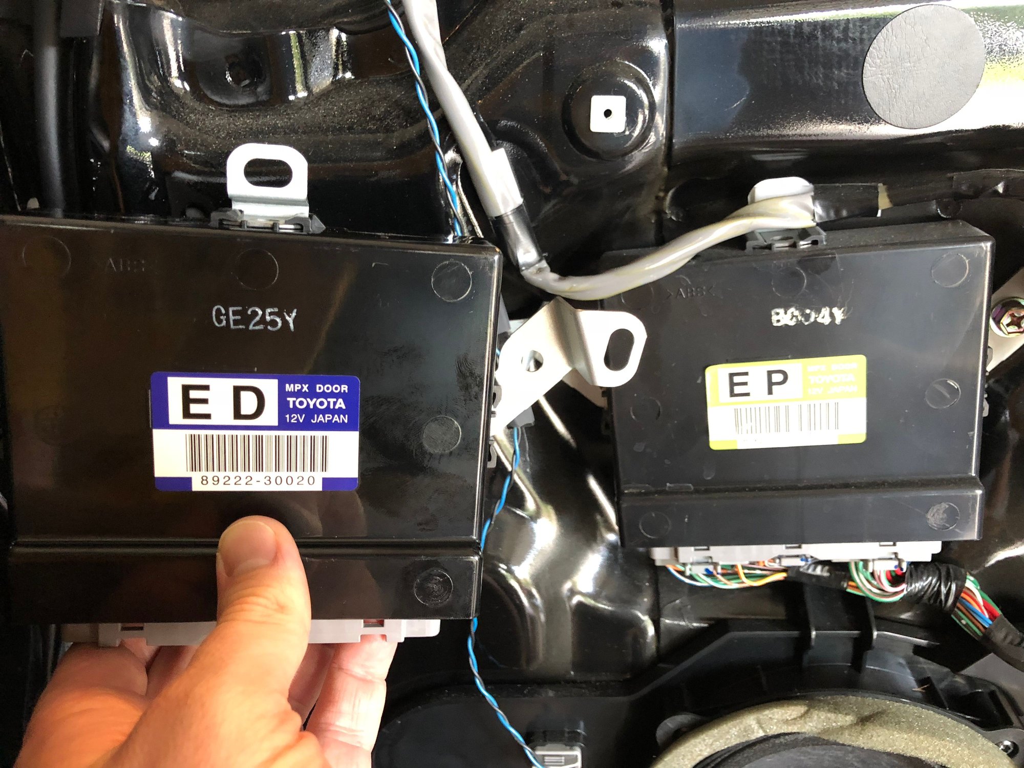

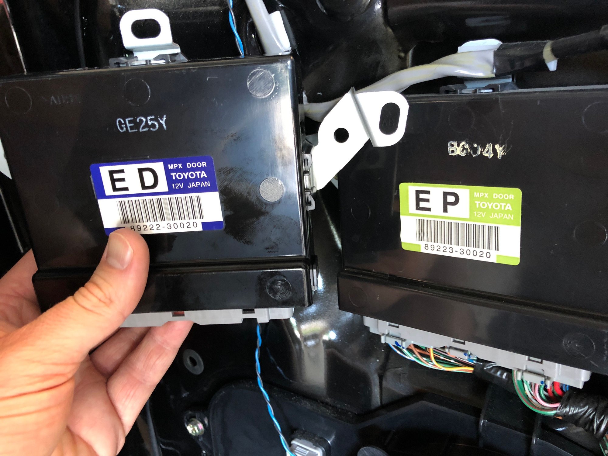

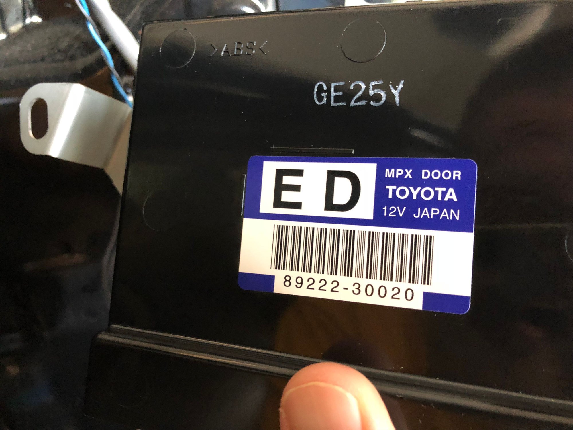

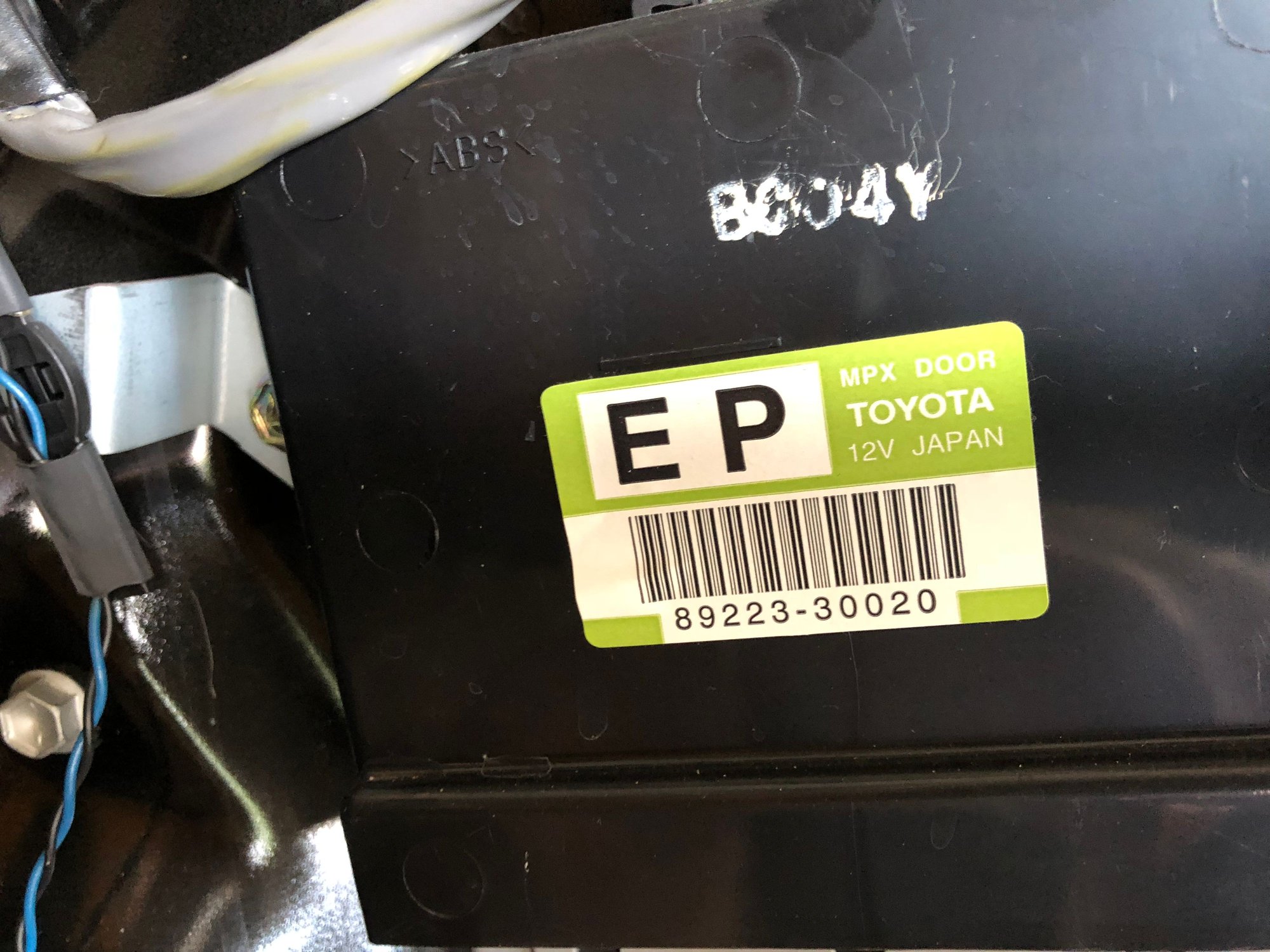

So I replaced the driver’s side master switch with a brand new oem part. The issue still persists. I now had planned on switching out the passenger front mpx door computer module, however now that I have the door apart, the unit that is in the car currently is different from the bed unit I bought to replace it. The new module was listed for a front passenger door, but the label and part numbers are different. The part number for the new unit is: 89222-30020 with “ED” in big letters above whereas the module in my car had a part number of: 89223-30020 and “EP” written in large letters above it.
Did i I get the wrong part?

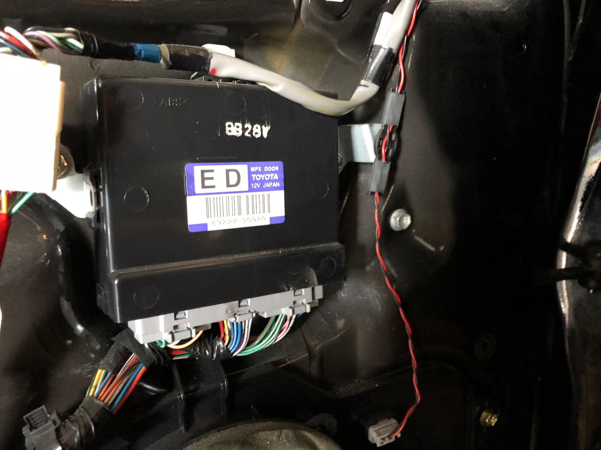

I ended up removing the driver’s side door panel again to see which module is over there. Sure enough, the original driver’s side computer door module matches the new part. I have begun to have minor issues with this window too, so I’ll go ahead and switch it out. If it works, then I’ll order the correct part number for the other door, if it does not work, then it’s off to the Lexus dealer we go.

Happy to report that the driver's side door window is working flawlessly after replacing the driver's door computer module. I just ordered the correct part for the passenger side (make note for anyone else who needs this that the Lexus parts catalog has them listed backwards) door and hope to install it next week. One window down, one to go.
