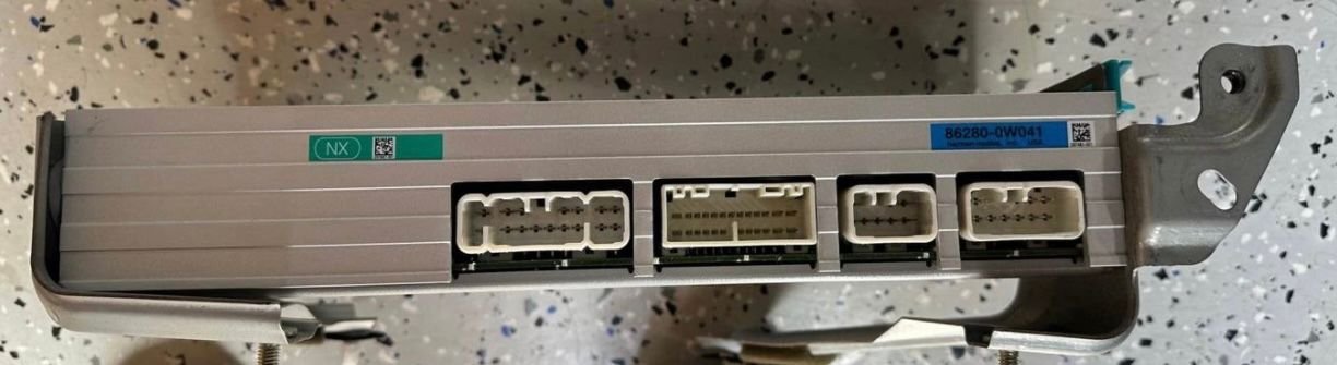

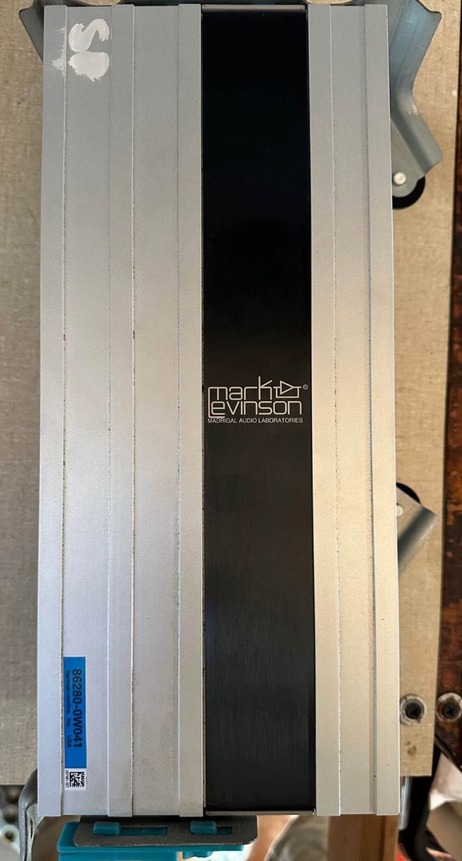

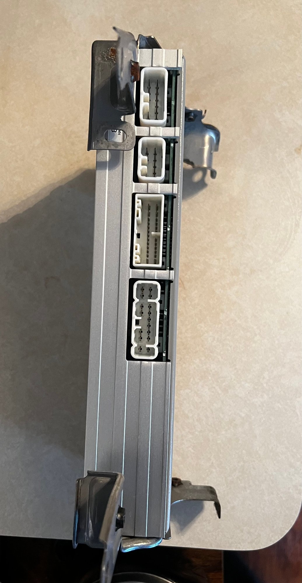

“I trolled my local craigslist and found a 86280-0W040, which is from the LS430, went to meet the seller, plugged unit in and speakers came back on. Apparently there is some compatibility between these units. I am assuming there is more interchangeable then this”
I got a 2006 gx470 (86280-0W141) and swapped my amp with a 2001 LS430 (86280-0W041). My radio was not working but the speakers would sound for navigation. I plugged in the LS amp and it works now! I hope this helps others with similar problem.
