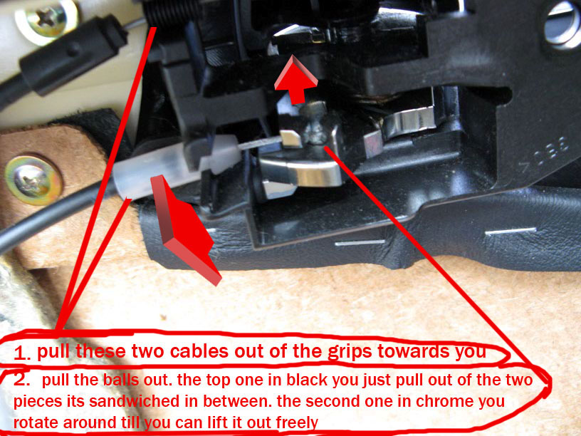

-At this point the panel will be still attached to the door by connectors for the puddle light at the bottom, two connectors by the window controls, and also by the two cables that the inside door handle operates. For this step i suggest getting a stool or someone to hold the door panel up while you unclip these various things.
-Unclip the connectors and for the two cables, (one has a silver end and one a black end) look at the pic for directions.

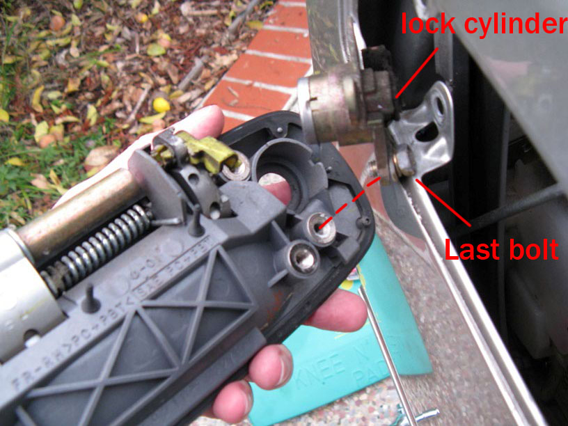

-Now you have the door panel off and its time to get at the bolts holding on the door handle from the inside.
-There are i believe three 10mm bolts holding on the handle to the door and one holding the lock cylinder to the handle
-You will need to cut through the plastic piece to gain access to at least one of the bolts.
-The other two are behind the circular black plastic stickers by the edge of the door by the latch. Peel these off and get at the bolts behind there.
-Once you have the three bolts unscrewed the handle will still be attached to the door by a long rod or bar clipped in to the handle and by the lock cylinder mechanism. At this point you should be able to pull the handle away from the door a little bit with a little jiggling as in the pic.

-I suppose you could also detach the rod from the plastic handle part and unscrew the last bolt holding on the lock cylinder with your ratchet from the inside of the door through the holes but this did not work for me, my ratchet was too short
-With handle pulled out away from door pop out metal rod and unscrew last bolt, see pic for visual.

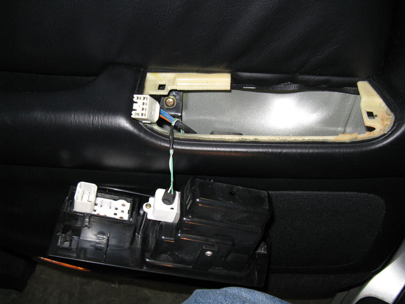

For the rears:
-Unscrew the screws (there are less than in the fronts), there is one screw hiding behind the inside door handle like the fronts, and also a hidden screw underneath the window controls. The plastic control panel just pops out, held in by clips at either end if you lift it up. There is one connector and one light bulb. Disconnect the connector and pull the light bulb straight out.
-Disconnect the two cables, and all connectors just as you did with the fronts
-Now you should have the panel off the door and be ready to start the fun part

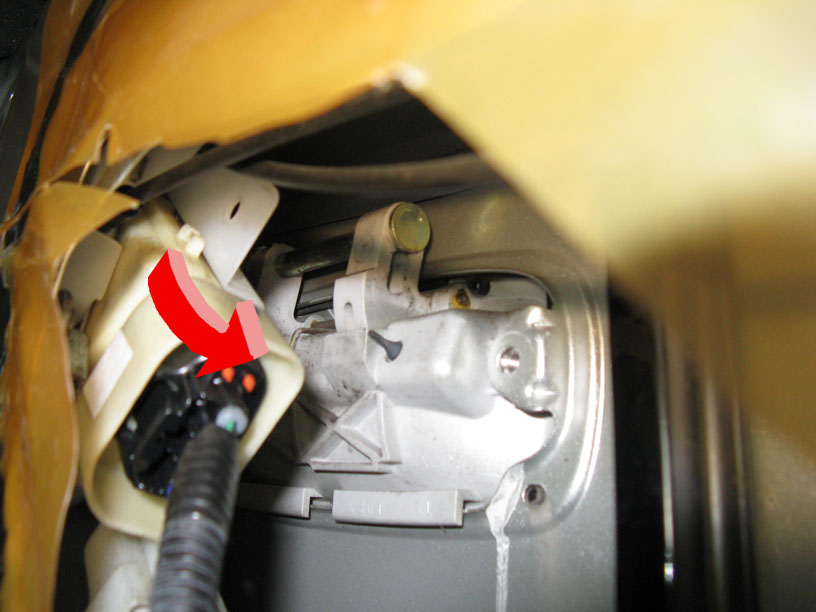

-To get the door latch out of the way of the saftey lock hole start by using your torx t-30 screw driver to unscrew three screws by the latch and one t-30 screw behind the plastic.
-Once you unscrew these four screws the whole latch mechanism should be movable with your hand if you reach in there
-At this point If you just try to yank the mechanism out towards you, there is a protruding metal part (its like a flat piece of yellowish metal) that will catch on the inside of the plastic door handle and you wont be able to move it out of the way to access the last bolt.
-Reach your hand in there and feel around. stick your hand all the way back there to get familiar with the problem. At the very far side of the latch mechanism You should feel the metal part of the latch mechanism making contact with the backside of the door handle. If you put your head right up against the door you should be able to see it too.
-The pic here with the red arrow unfortunatley doesnt show the metal part i'm talking about because its way in the back
-So what you need to do is push down on this part while your pulling and get it to go under and clear where its making contact with the backside of the stock door handle. I cant remember if i was lifting up the door handle from the outside to help it clear or not but you can try that too.
The first side it did was kinda just miraculous and came out in 5 mins and i wasnt really sure what i did, the other one took about 25 minutes of figuring out exactly what needed to be done.
-Once you get the latch mechanism to clear the door handle it will drop down lifeless and defeated and you can gain access to the glorious final bolt

Now the actuator unit is freed and pulled out of the door. Here we see through the child safety lock hole. A clear shot of the door handle rod which when engaged, presses down on the metal contact. Also you can see the second screw on the door you will need to access if your replacing the handles.
4.
