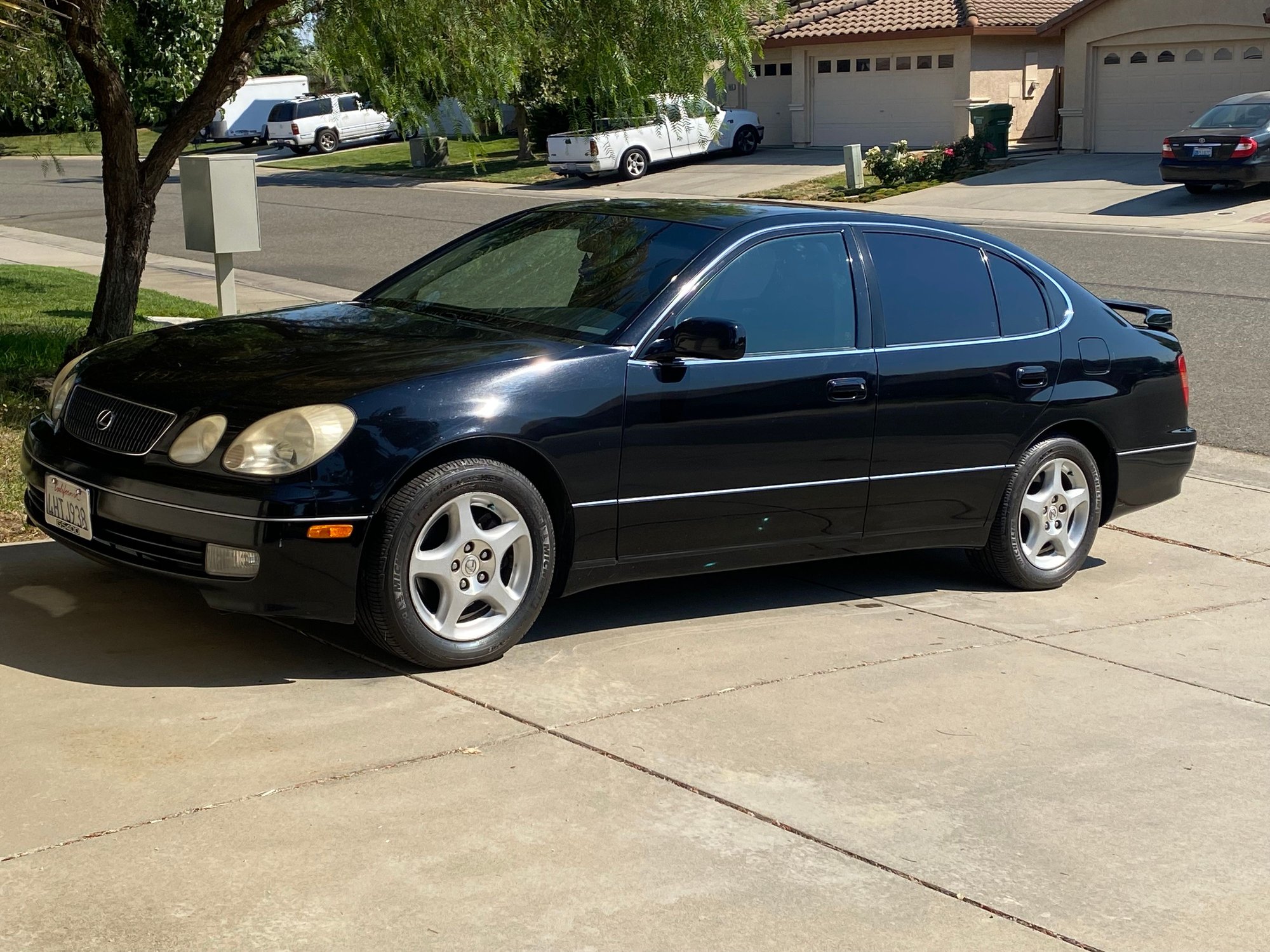

My 98 gs400 has been running very good the past couple of years (mileage 390,000 lol) I had to get a smog check and I wasn’t worried about it until they told me it didn’t pass. So they “tried to fix” what they could to get it to pass. Long story short they ended up telling me that they don’t know what to do with the car and I should sell it. Basically gave up so I was obviously offended keeping in mind it was runnin like a champ before I took it to them. The mechanic even offered me $500 to take it off my hands and I did notice the rear tires had been in use of some rubber burning of some sort. (Mfs love to do donuts in cars that ain't theirs) So I just drove the car home and ever since I brought it back and doesn’t stay on and grey smoke comes out of the mufflers. I’m more than prepared to just replace the whole engine. I managed to find a used engine with 65,000 miles on it. Was hoping if anyone knows a shop that knows what they're doing when it comes to lexus
engines.
Im located in NorthernCalifornia Sacramento area but I’ve heard about bay area shops as well. I probably didn’t describe my situation very clearly either but any advice/ guidance is greatly appreciated it.

I think it was an emission issue but on the smog paper the person who tried to work on it emphasized 4 times “grey smoke comes out of exhaust request for tear down”
On another note it wasn’t able to stay on ever since I picked it up from the shop. I switched out the old battery (which was purchased and installed by a technician from triple A. Turns out the battery wasn’t the correct size
Now with a new battery it actually stays on and functions exactly how it did before I took it to the smog shop
(And also NO MORE GREY SMOKE which seems weird to me) I’m just surprised no one noticed that the battery wasn’t the correct one. I also blame myself because I should triple check everything that is done to my car especially when everyone tries to pull fast ones.
Now I don’t really have to worry about the car’s condition as much as I was and just on how to pass smog 🙌🏽
