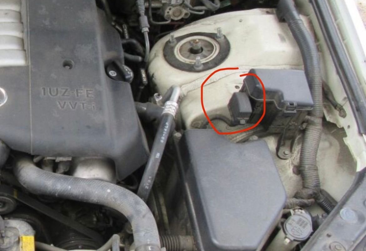

ok thanks. In the engine bay there’s this little spot that I thought could be to put that device for codes there. I’ll attach a picture. What is this for?

I think that's a DLC 1 connector. Found this thread in the LS400 section: https://www.clublexus.com/forums/ls-...rt-a-obd1.html

When you plug a scanner in it has a nasty habit of canceling the VSC memory. You will have to reset using jumper in the engin bay little box that you circled above. It only takes a few mins to do, search this site for info
