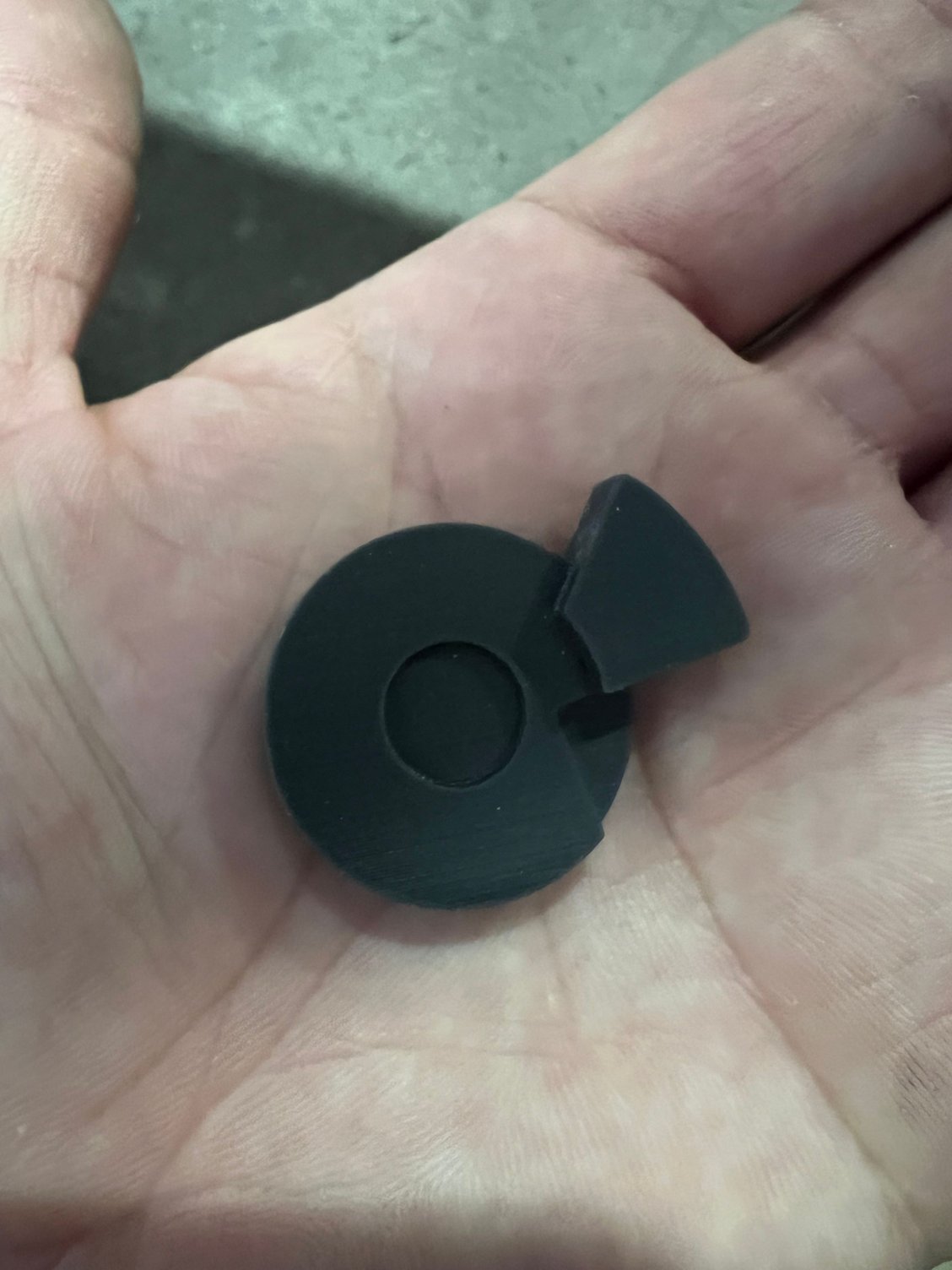

Old Aug 20, 2023 | 09:01 AM

It’s supposed to open the throttle all the way when you step on the gas instead of opening it around 20% like stock

This aftermarket part will be a mechanical override for the Toyota's Electronic Throttle Control System-intelligent found on the 2JZ-GE engine.
The OEM system uses a servo motor and gear drive system to control the throttle plate based on the command of the Accelerator Pedal Position Sensor.
The system has a fail-safe mode of operation in which the throttle cable is able to open the throttle up to 20% when fully depressed to safely drive the vehicle to the nearest repair station.
For 99% of the owners of this car this factory system works fine, and I doubt that you will find partners to modify it.

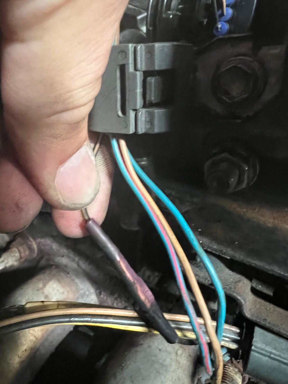

My black wire was cut in half under the loom
i reconnected it & all is fine now
