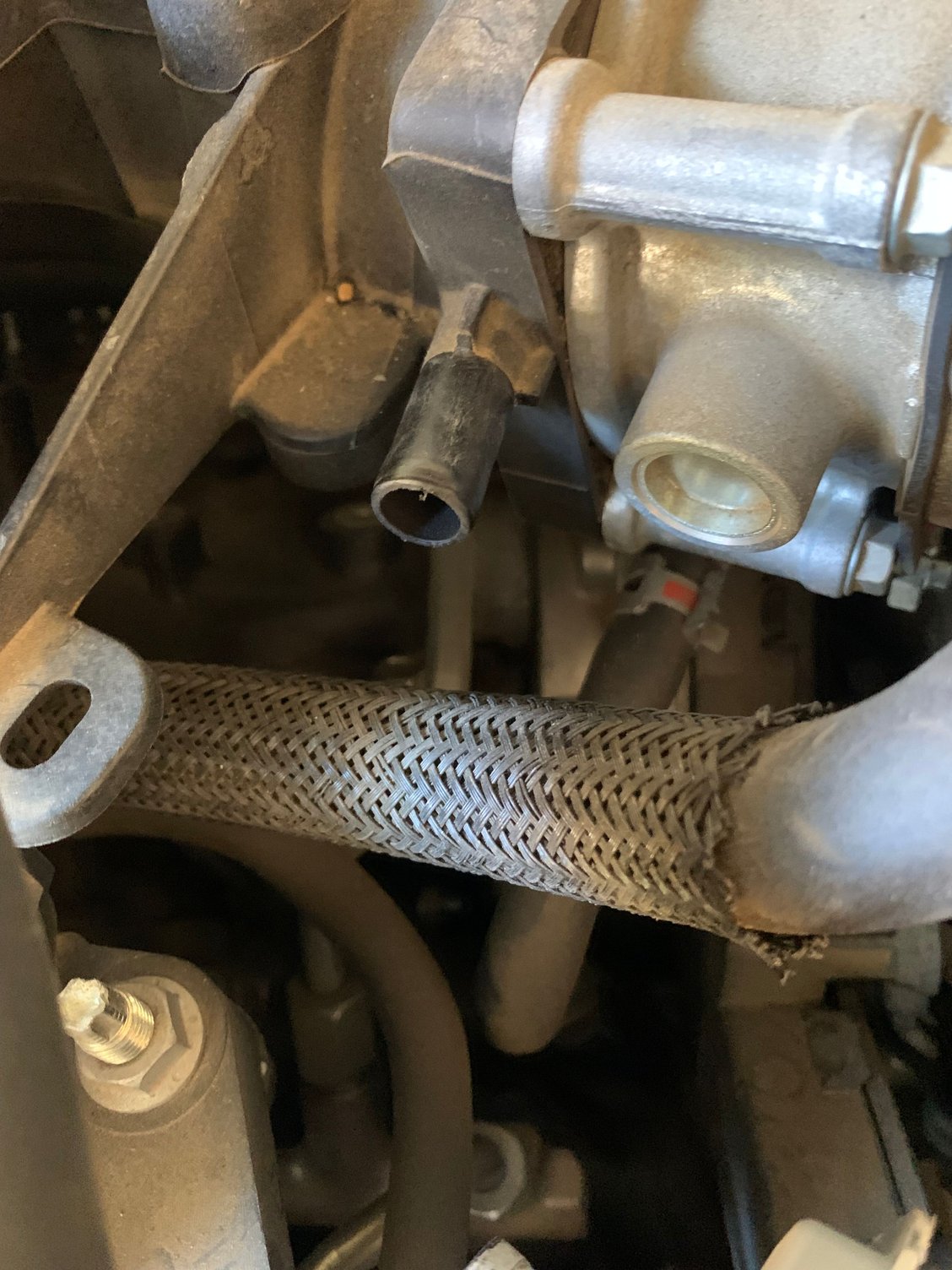

What was the code so we can see if even associated with that hose?

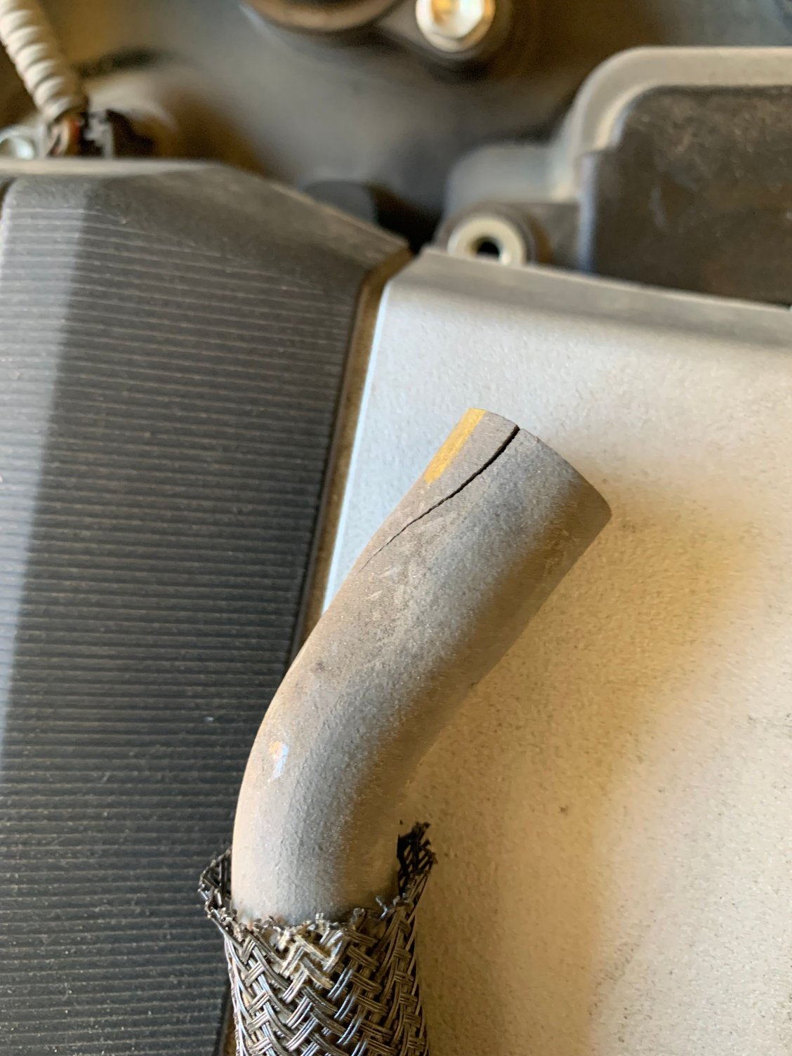

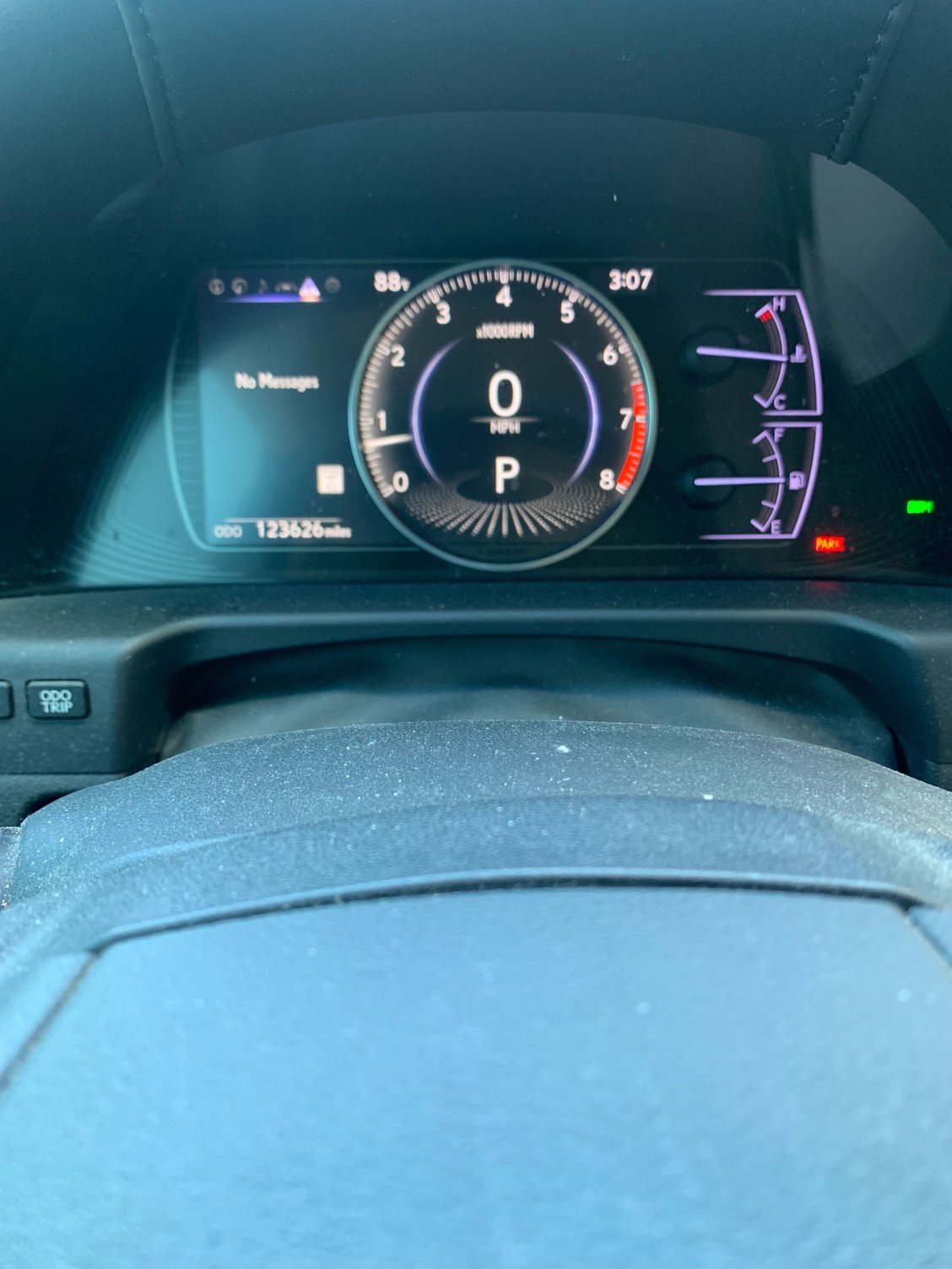

Had codes deleted ! I’m maybe 400 miles in since code has been deleted and no check engine lights as of yet!

Thanks this should help all ES350 owners to check that hose

There was a leak for sure.
If you don’t want to replace the hose, cut that part and connect it again.
