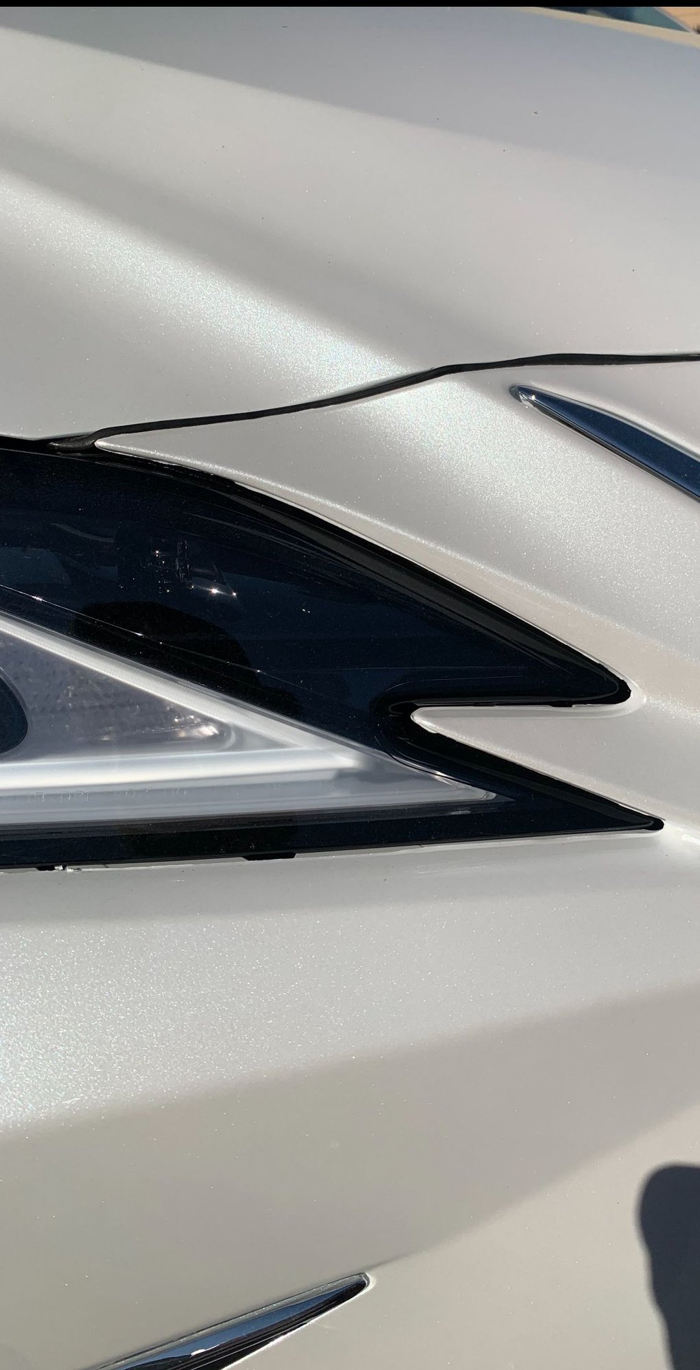

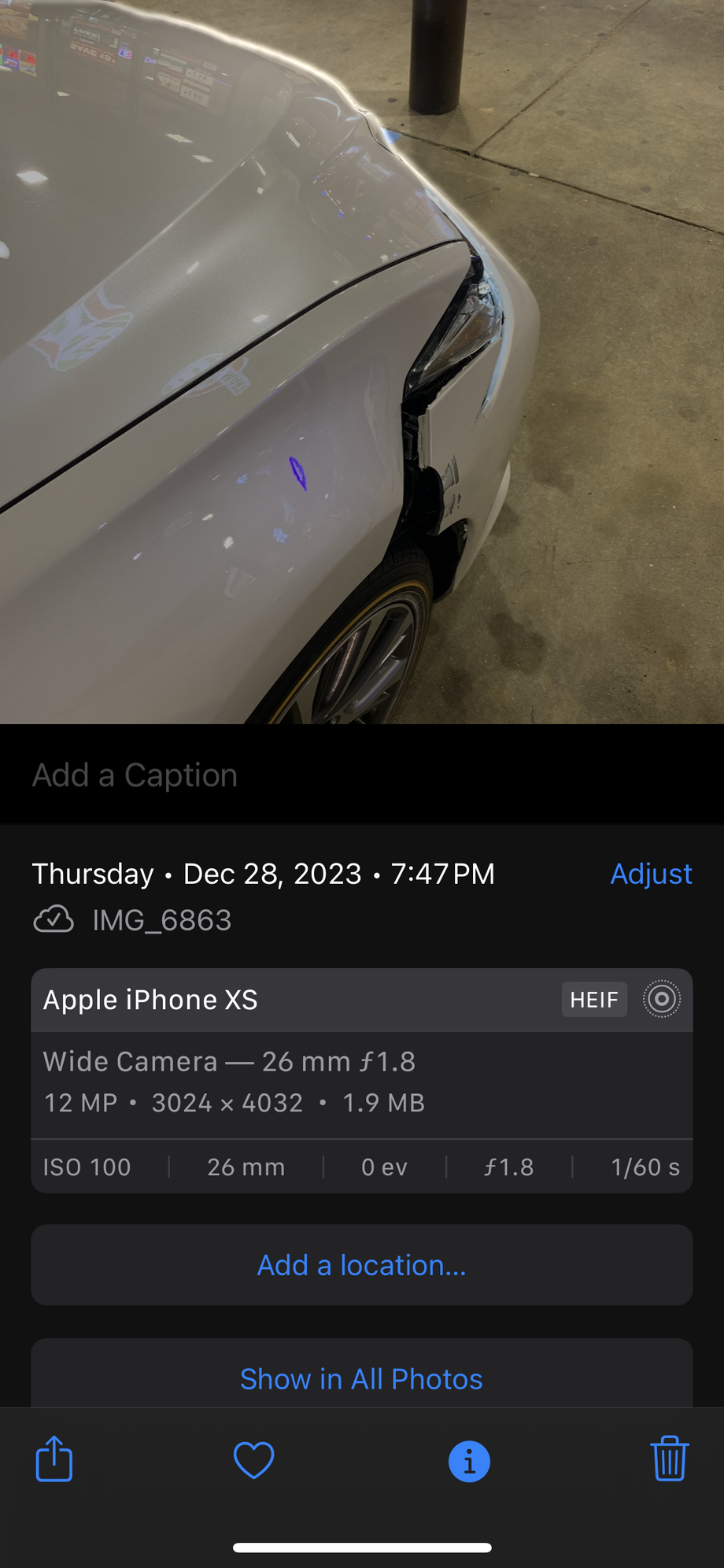

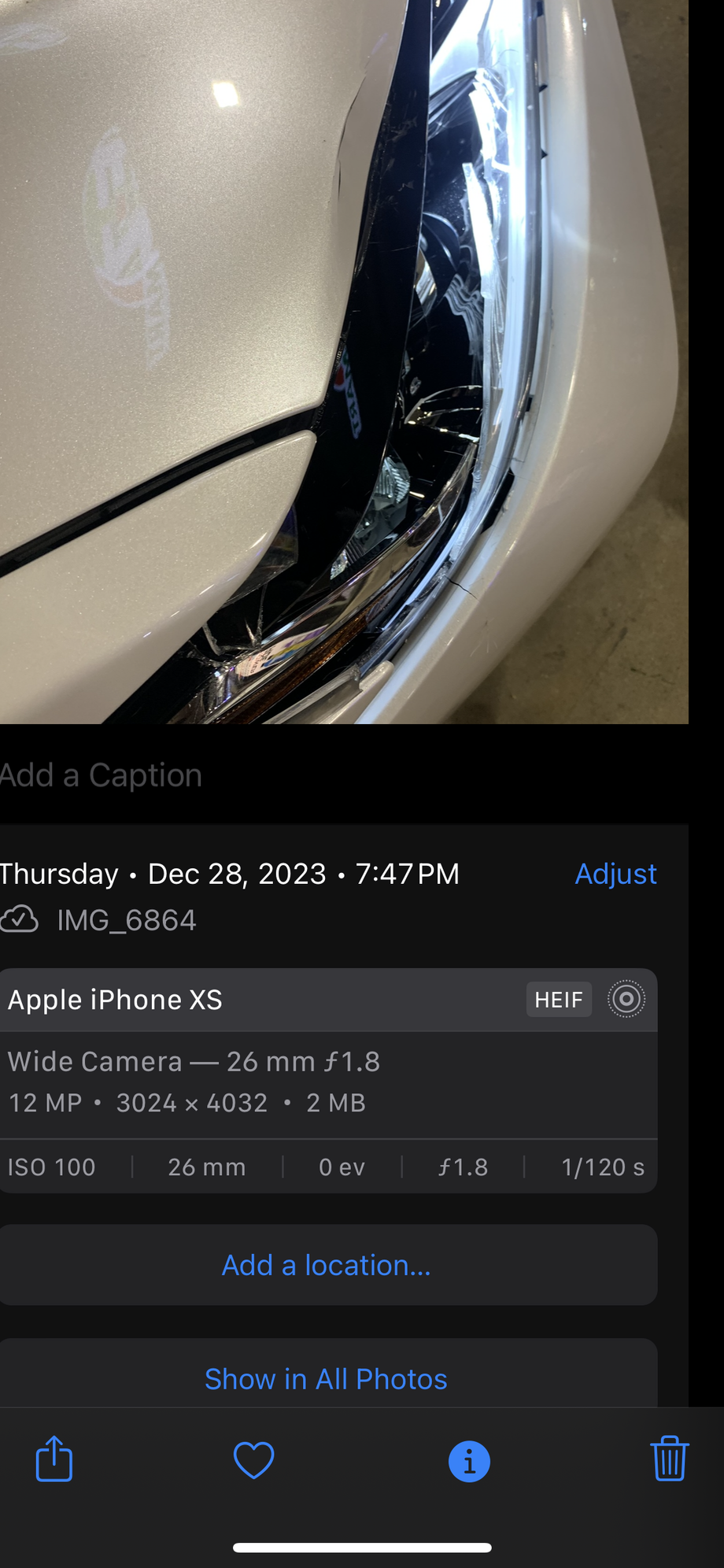

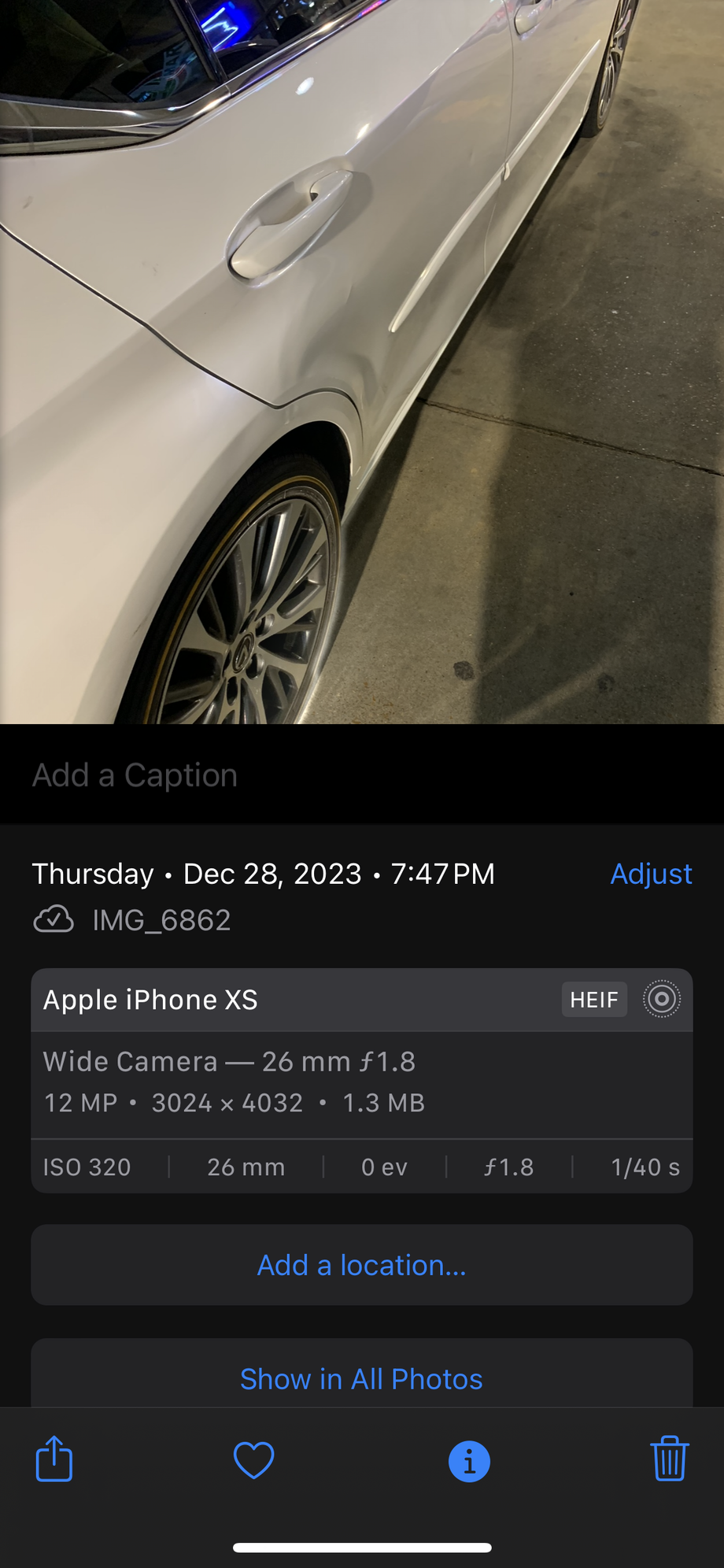

I’m almost afraid to ask, Thomas…are those photos before or after the “repair”!?
