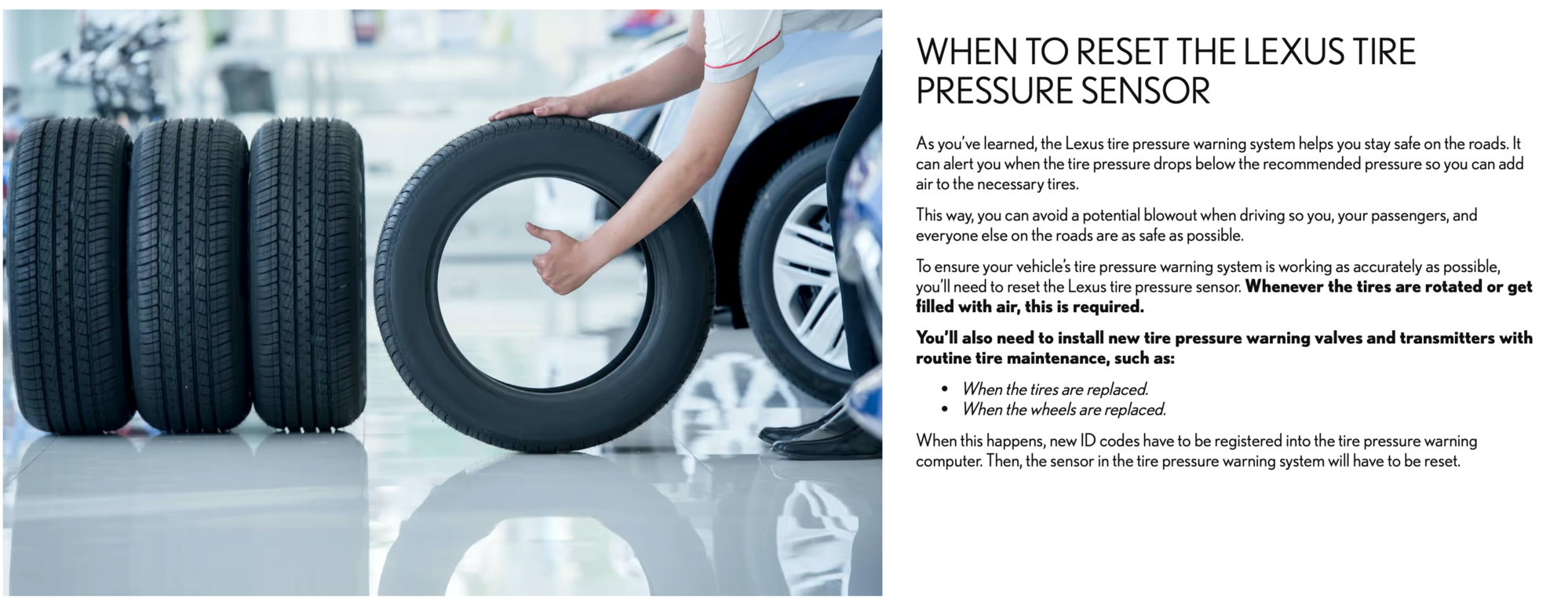

What prompted me to post this thread was Lexus stated on their website that it was necessary to initialize the TPMS system whenever air is added in conjunction with my reading discrepancies.
This made no sense to me but that's what it says here.
https://www.iralexus.com/lexus-tire-...et-danvers-ma/

What prompted me to post this thread was that Lexus stated on their website that it was necessary to initialize the TPMS system whenever you add air.
I agree that statement in the manual is confusing, IMO the manual makes confusing statements on other items and other things. On my ES350 when I read that I ignored it. While driving the TPS read near 33psi so decided to check and determine if TPS sensors are reading correctly. On cold tires checked air pressure with my trusty analog gage and added air to cold tires to 35 with measured with my analog gage (discounting the pump gage). Then drove car and in about couple 100 ft checked dash TPS and readings were very close to 35 I est about 1/2 psi different that my analog gage.

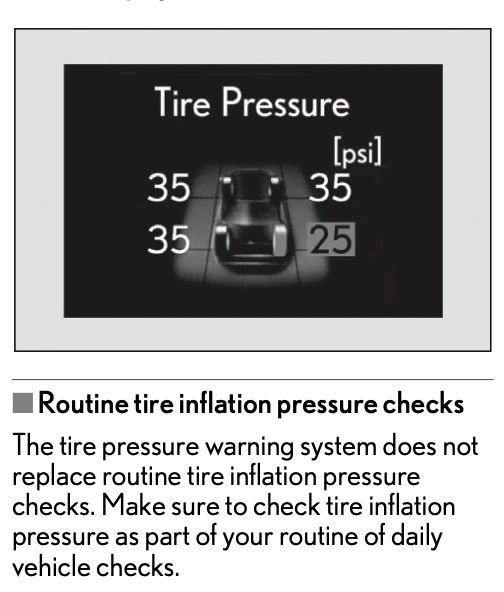

That "advice" is simply an effort to get you to spend money on new sensors and lots of trips back to the dealership for more "work". The sensor batteries typically last somewhere between 8-10 years...much longer than tires last. The only time you need to replace sensors is when the batteries die or they otherwise fail. The only time you need reinitialize is if you want to change the "default" or setpoint pressure setting to give a higher or lower normal range of pressures. I've tried initializing according to the 2020 manual but honestly...who can drive 25 mph for 10 to 30 minutes without ever once having to back up (or who wants to every time you change pressures or rotate your tires? Easier to have your tire dealership (Note: I did not say Lexus dealership), take care of it, provided they have the capability. As long as the car can "see" the four TPMS id codes that it expects to see then the system will work. Pump the tires up to 36 psi, confirm with a couple of different gauges, initialize once, then as time goes on, add or subtract air as needed, and forget it. If you have to change a tire (say, for a flat that can't be repaired), then just leave the TPMS installed on the rim, set the new tire pressure to match the other three, and drive on. If the car readout is consistently way off from the gauges then see the dealer with the evidence to show that there's a problem with the system. If you find the "four dashes... --- --- --- ---" on your car display, but no orange light, then something is wrong and needs to be checked out (most likely a bad battery on one or more of the tire sensors).
ps: when discussing this topic, always remember that "registration" and "initialization" are two entirely different things: "Registration" means telling the car's computor what the individual tire sensor ID codes should be while "Initialization" is simply setting the default pressure with which to calculate the alarm level, and the location of each sensor.
pps: right in the manual it says "Always use a tire pressure gauge". In other words, don't rely on the car display as being the last word!!!

If you follow Lexus guidelines, you should be measuring your car tire pressure every day. Yea right thanks for the $1000 of extra TPMS in the car.
I noticed in you statement above you say to "Pump the tires up to 36 psi, confirm with a couple of different gauges, initialize once, then as time goes on, add or subtract air as needed, and forget it."
This is suggesting initializing? WHY?

Thanks for the URL.
That looks to be something the local dealership composed to provide "simplified", generic guidance attempting to cover all the operating states and procedures of all the implementation variations of Lexus TPMSs. In trying to simplify while still attempting to cover everything, it looks like they may have dropped a bit or two of important qualifying information, especially so in that bolded sentence:
Whenever the tires are rotated or get filled with air, this is required.
Other dealerships providing TPMS rest guidance qualify the "get filled with air" condition with "if the TPMS light remains on after" qualification. For example, Lexus of Cherry Hill's HOW TO RESET TIRE PRESSURE LIGHT qualifies their reset guidance with:
If your tire pressure light remains on after you’ve inflated your tires, you may have to reset it.
That simplified, qualified guidance agrees with the more thorough, detailed information found on page 354 of the 2024 LEXUS ES250, ES350 OWNER'S MANUAL USA AND CANADA ONLY in the "When the tire pressure warning light comes on" section:
► If the tire pressure warning light comes on
1 After the temperature of the tires has lowered sufficiently, check the inflation pressure of each tire and adjust them to the specified level.
2 If the warning light does not turn off even after several minutes have elapsed, check that the inflation pressure of each tire is at the specified level and perform initialization. (→P.321)
I agree that my local dealer's statement regarding the requirement to initialize TPMS after filling the tires dropped critical qualifying language.
That would explain my user manual vs Lexus website confusion.
I am still unsure why adding 4 psi in each tire per my Jaco Gauge and per the Compressor tank gauge did not result in a corresponding increase on the car's display readings. Tomorrow I'll try to measure each tire again with my Jaco gauge and compare against the car's readings. The Jaco gauge matched the car's display readings for all four tires BEFORE I filled air, but not AFTER. It's as though the car's readings simply never updated after filling, although I can see the pressures increase on the car display while I drive as the tires heat up. All four tires currently read 32 PSI per car's display and increase close to 34 psi as I drive.
