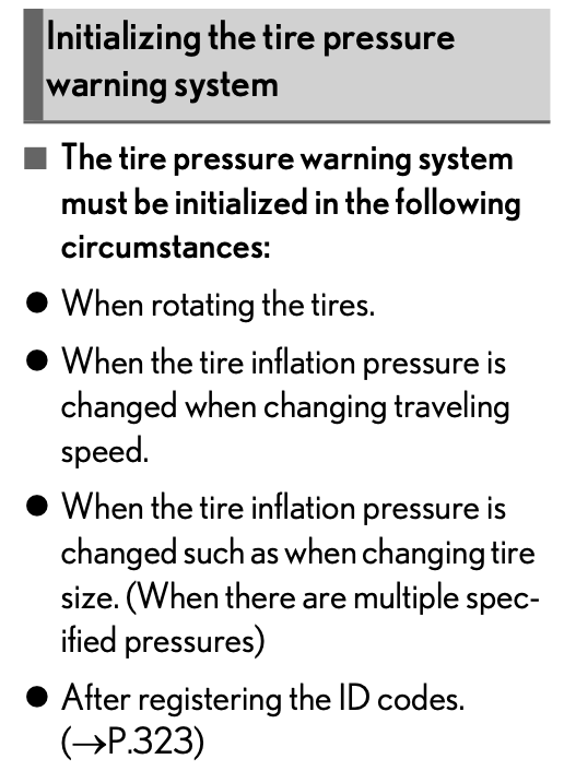

OK so this is my first car with a TPMS, I'm coming out of the stone age so be easy on me
My tire pressures were getting low according to the display screen in the car. They were reading around 31 PSI on each tire, with no warning light but the original pressure when I bought the car was 34 PSI so I decided to top off.
I used a digital JACO tire gauge to measure tire pressures. It confirmed the readings were close to 31 PSI on each tire before I started filling, which was in excellent agreement with the car's display.
I filled to 35 PSI per Lexus door sticker as measured by the Jaco Gauge.
I've run the car for several trips and the display consistency shows 32 PSI on each tire, ambient temperature is the same as when I filled them.
According to my owner's manual I should not have to reinitialize simply because I added air, and I have no idea what they mean by "Initialize the tire pressure warning system when the tire inflation pressure is changed when changing traveling speed".
According to Lexus website I should initialize the TPMS any time I add air.
1. Why does the car display reading now disagree with the Jaco Digital Gauge when they initially agreed? The tires needed a lot of air to reach 35 PSI on the Gauge but the car's display readings barely budged.
2. Why should I have to initialize TPMS simply because I added air and why is there a discrepancy between owner's manual and Lexus website?
Owner's Manual:
Lexus Website:

The sentences are confusing as f***.
When the tire inflation pressure is changed when changing traveling speed.
and
When the tire inflation pressure is changed such as when changing tire size.
What they really mean is that whenever you want to change the value of the normal tire pressure, you need to do the initialization to tell the system about this new value.
If you are going to do a lot of high speed driving --> add more pressure to your tires, teach the system this is your new desired pressure.
If you use different tires that requires a different pressure --> set them at that pressure, teach the system this is your new desired pressure.
There's a sentence explaining that:
When the tire pressure warning system is initialized, the current tire inflation pressure is set as the benchmark pressure.
You don't need to reinitialize when you just add air without changing the value of your target normal pressure.
and
  • Now back to your issue: is this tire pressure discrepancy occuring when the tires are cold?
  • Did you complete a tpms initialization? --> it wouldn't explain the wrong reading, but you might have programmed the system to a new desired normal pressure.
  • Any chance you are far above sea level?

Yes, I started the car after it had been sitting for more than 24 hours and the car display read 32 PSI on three tires and one was 31 PSI. The car had been driven several times before this and read pretty close to 32 PSI for each tire while driving. The ambient temperature when I checked it after sitting for 24 hours was about the same (45º F) as when I filled it. My underground garage's temperature hardly varies much during the Winter.
No, since there was conflicting guidance between the Lexus website and the Owner's manual, I did not perform the initialization. I also watched a Utube video on correcting a low warning TPMS light (which I never had) and it did NOT mention performing initialization.
My sea level according to apple compass is 150 ft Elevation. This makes sense, I am not far from the Atlantic Ocean, can bike there!
All I did was add air, without performing initialization. I expected the Car's screen readings to agree with my JACO gauge after filling the tires, just as it did immediately before filling them. I am positive the tires took a lot of air based on knowing my compressor and the sound of the tire inflating. I also watched the compressor's gauge drop as the tires were filling. There is no way I only added 1 PSI in each tire as displayed by the car's screen.
I believe I added 4 PSI in each tire but the car display tells me I added 1 PSI in each tire.
I'm glad I'm not the only one that found the owner's manual confusing regarding "Initialize the tire pressure warning system when the tire inflation pressure is changed when changing traveling speed"
I think tomorrow I will double check the tire pressure with my Jaco gauge, but like I said I really think I inflated each tire to 35 PSI based on the compressor gauge, Jaco Gauge and sound of the tires filling.

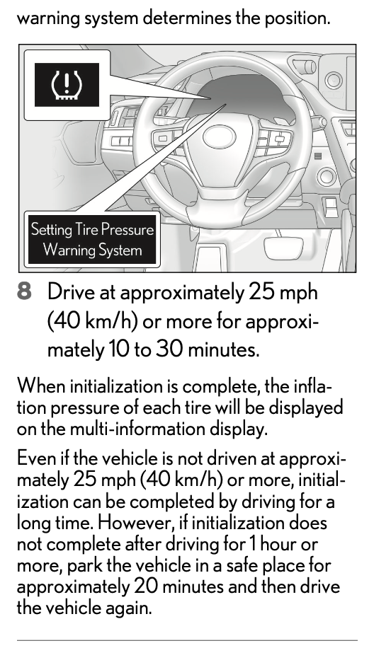

Hmm Ok so it's an absolute measurement and not relative. I understand.
There must be a step during the initialization procedure which prompts the user to set the pressure value to trigger the warning. This was not clear in the user manual as shown below, there is no instruction to enter a pressure value.
Yes I am confused as well, I was pleased when I saw how perfectly my Jaco gauge matched (within 1 psi) with the initial low pressure readings displayed by the car menu before I filled them. Not so pleased after filling them.
Maybe that is a good suggestion to see if the sensors are tracking with a deflated tire. I assume the car does not have to be driven any distance for the readings to be accurate?
What exactly is the initialization procedure accomplishing? I know there is a separate procedure (not the initialization procedure) for registering sensor codes. The car has to be driven for the system to initialize properly according to the manual. I wonder why? Is the initialization process associating each sensor with a specific tire and what tells the system the correct tire after they are rotated?

  1. The initialization is registering your current tire pressure as the normal operating pressure. Let's say you inflate to 36 psi, then you initialize: the car now knows 36 psi is your default pressure. And from there it can calculate at what pressure it should warn you that it's too low. I am not exactly sure how, I think it's 80% of the normal pressure - or maybe it's just a constant psi offset. So your issue should not have anything to do with initialization.
  2. Yes, when driving, the car recognizes which tire has which sensor.
Also sensors go on sleep mode as much as they can to save battery.
When you do the initialization, the car forces the sensor to wake up so that it can read the value.
In normal condition the sensor is off when the car is not moving.
Possibly another way to force the sensor to wake up is to decrease the pressure in the tire: after all that's the main job of the TPMS, it is supposed to quickly alert the car when the pressure decreases fast (do that with the car on so that it can catch that signal)
Another thing to consider: the car might try to avoid showing small variations. It could be that it's what you are dealing with: the pressure before was 32 psi. Now the sensor reads 35 psi but the car think it's just a transient event that should be filtered out.

I looked up the accuracy of my Jaco tire gauge (FloPro) which is specified +/- 1% FS.
FS = 200 PSI so the accuracy is +/- 2 PSI
The Jaco gauge agreed within 1 psi of the car's display for all four tires prior to filling them.
After I filled them by adding 2-3 PSI according to the JACO, the car display only increased by about 1 PSI for each tire which is what confused me.
Perhaps there is a temperature factor I am not accounting for which explains the discrepancy, but I don't think so.
