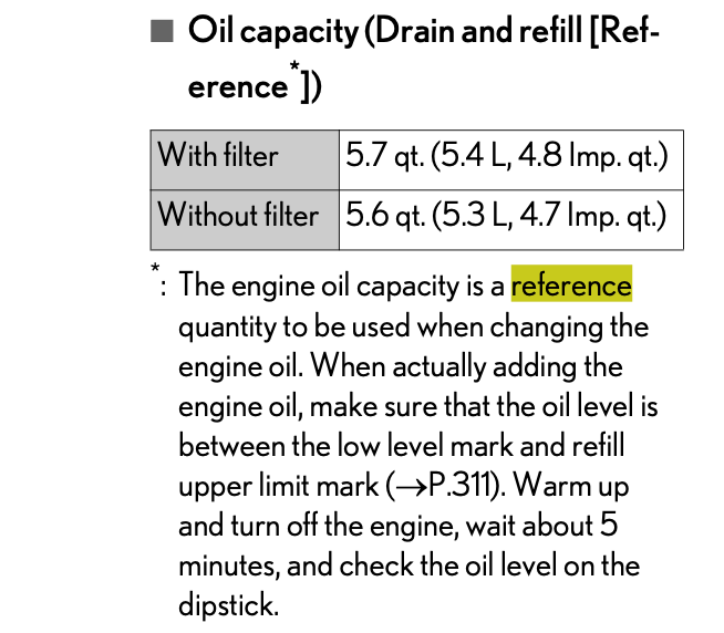

Actually 5.7 quarts on 7th gen ES 350.
To bring my ES to the full mark it takes 6.0 quarts
Technically 5.7 quarts is in the specified dip stick range.
owners manual states capacity is 5.7 WITH filter change.
PLS Excuse my correction, I guess there are unique cars, mine takes a bit over 5.7 qts with the filter
Owner's manual states 5.7 quarts is a REFERENCE quantity but to use DIPSTICK when ACTUALLY adding oil.
