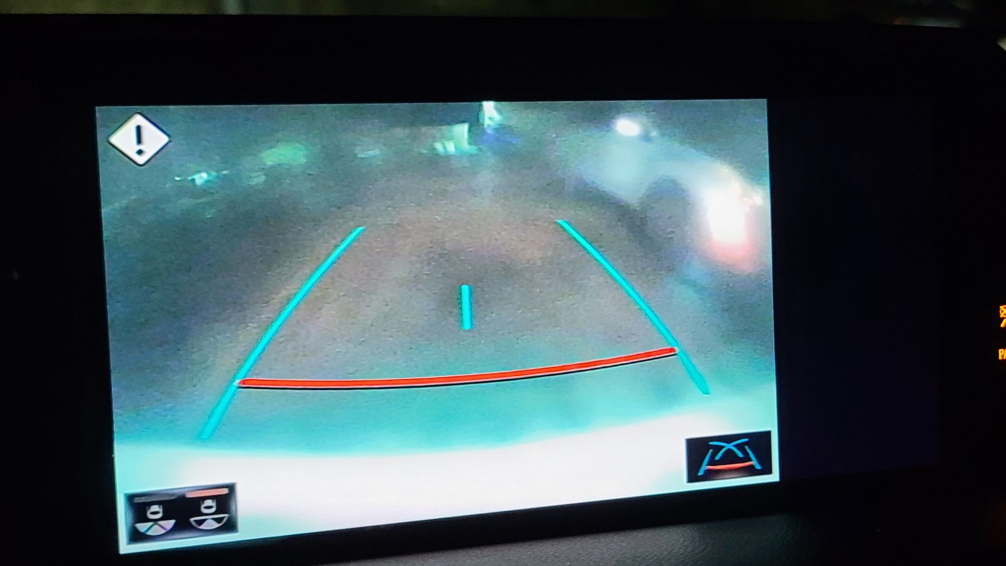

Hello all,
as the title says, reverse yellow lines are missing and unable to bring them back so far.
Would be very thankful if somebody can suggest how to bring them back.
So far i have tired to 're-calibrate' it by doing (Google search):
Steering wheel re-calibration
I also attached the image on how it looks right now.
Please help if you can, thanks

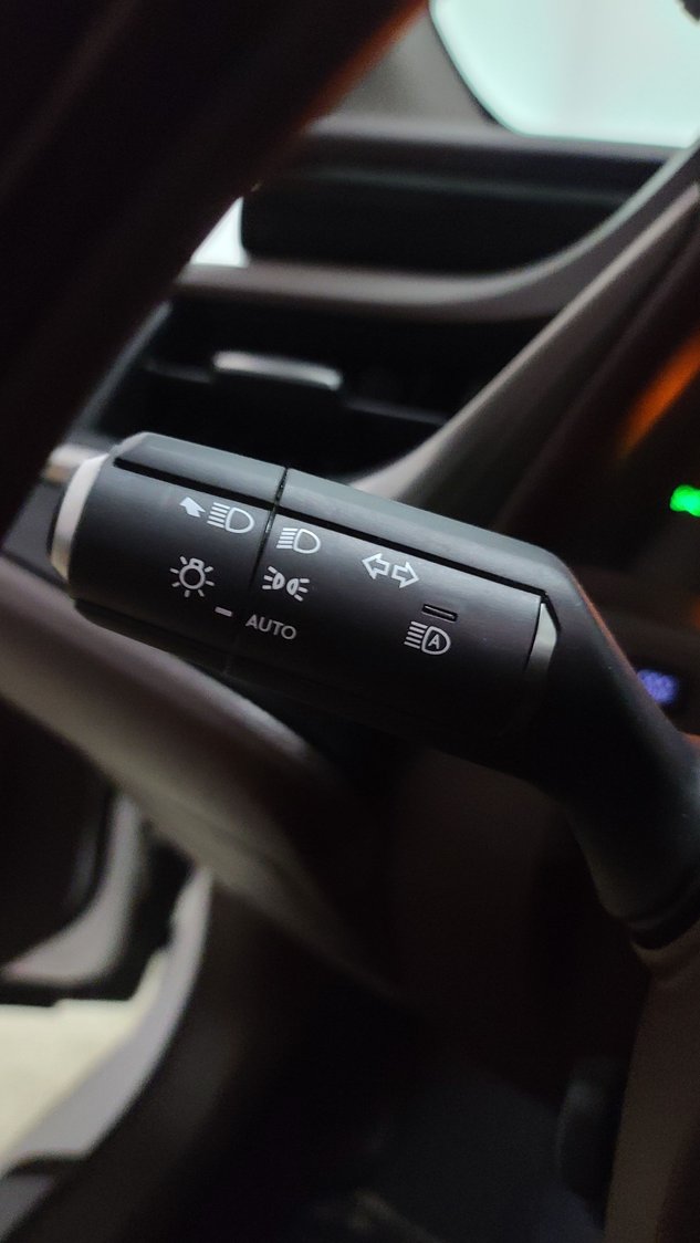

My Vehicle is Canadian version as well, and i do not see OFF on my light switch, mine looks like ( see attached file)
Still unable to get into this mode

Finally figured it out
My vehicle is Canadian version of ES250 (probably the same for ES350).
My first mistake was trying this last night inside the garage ( won't work ).
Light switch has to be on AUTO , vehicle parked outside, so , no lights running.
Press MENU and move one position up from auto on light switch 4 times, and you get into service mode.
From there i did calibration and i got yellow lines back, works like a charm.
