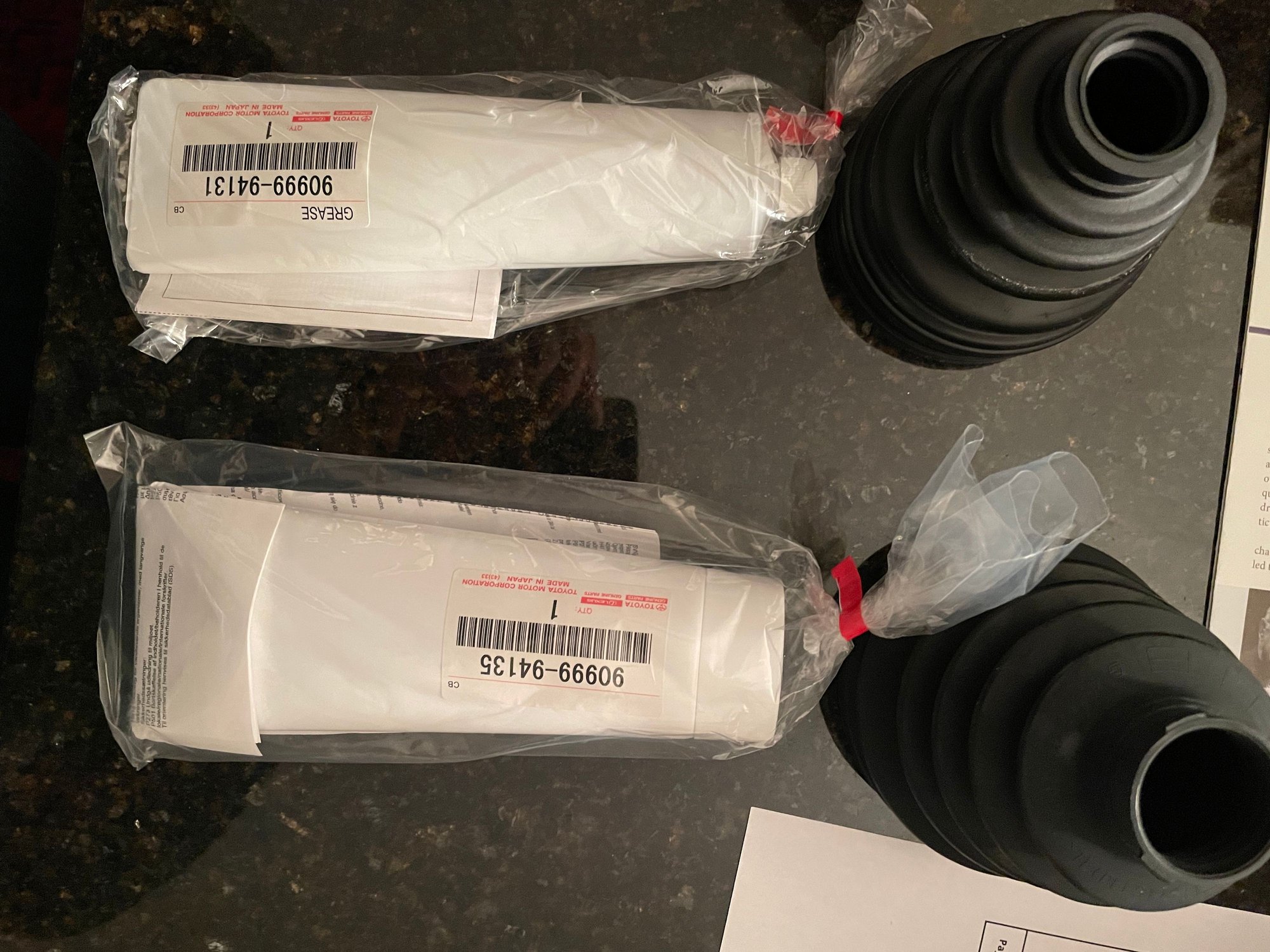

Maybe this will be clearer when I opened the bags. Offhand anyone know which grease goes with which boot? Inner boot is on top.
Thanks
Now I have to arrange to borrow the band crimp tool
Which grease goes where?

If you have green and black, the green is always in the outer boot. if they're both the same probably wont make a difference.
Old Nov 9, 2022 | 07:39 PM
Posts: 26,025
Likes: 4,320
"thinner is inner"
Which as above will be green or maybe black that goes closest to the wheel.

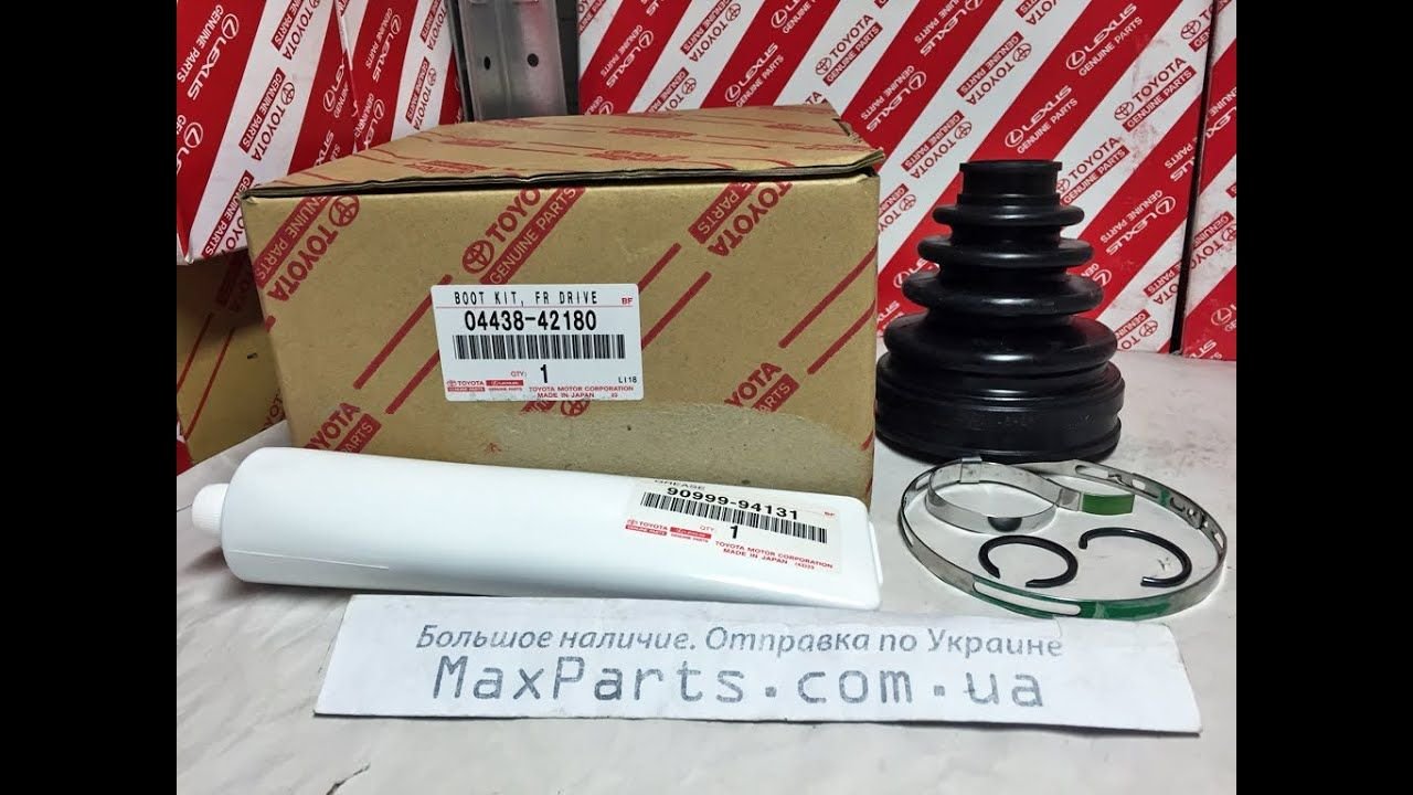

I have known it as thinner to inner as well
Below is a picture showing Inner Boot Kit, RH. (2002es). Shows grease 90999-94131.
FYI - I found this photo on internet so can't vouch for its accuracy
