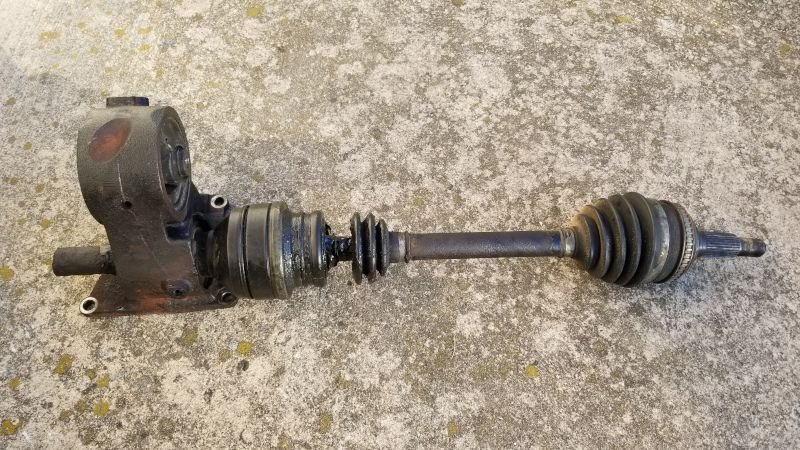

What you can do is take the clamp off the inner boot after removing the axle nut and associated parts to get the outer end out then remove the axle, clean the grease from the inner joint still attached to the bearing housing...take the other clamps off and remove the boots and purge the old grease from the outer joint with a small grease gun with cv joint grease in it(large grease needle works best between the bearings and cage) then reinstall outer boot. install inner clamp on the axle and just let it flop there, then inner boot.
Install some boot grease in the inner joint housing and inside the boot, not so much that both are close to full then install the axle partially into the inner joint just enough to be able to get the boot fitted on the inner housing( hanging the axle with a bungee cord works well if you are by yourself but don't put the outer end in the hub yet)
If you have the type of axle with only 3 bearings make sure the boot clamp in sitting on an spot where the rubber is thinnest, you will see what I mean, if the inner housing is round like the one in that picture it doesn't matter where the clamp area is.
When the large clamp is properly installed push the axle into the housing, use a small screwdriver to insert under the small end of the boot to release any air...install the clamp...put the axle in the hub and badaboom.
It sounds like alot but it's the same procedure when you take the whole assy out but less work and way fewer cuss words. Also wipe any grease off the inner joint area if you squeeze any out.
If there is a snap ring on the inner joint you will take that and the bearings off to change that boot.
