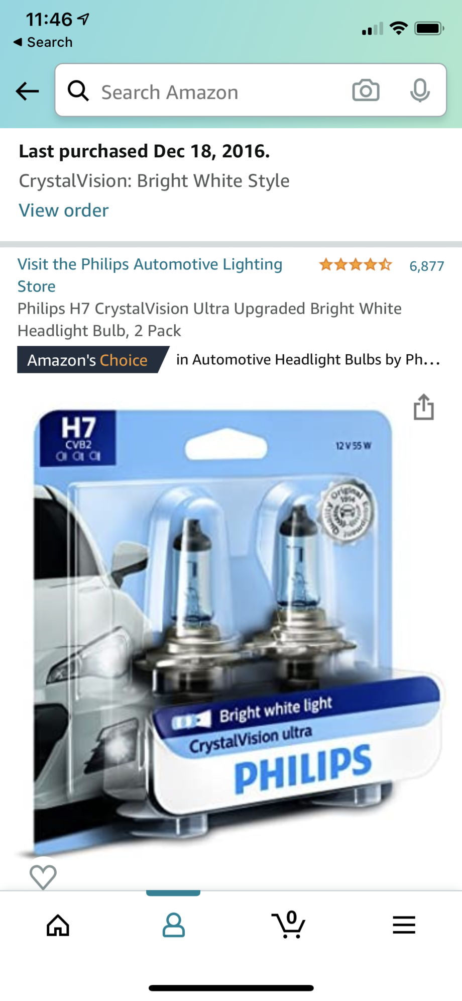

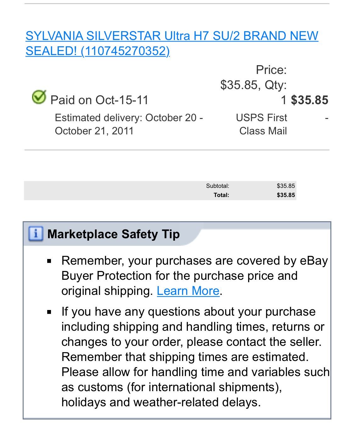

Here are the Philips and Sylvania bulbs that I’ve had in the past. The last Philips purchase lasted the longest at 4.5 years vs the other 2-3 years.

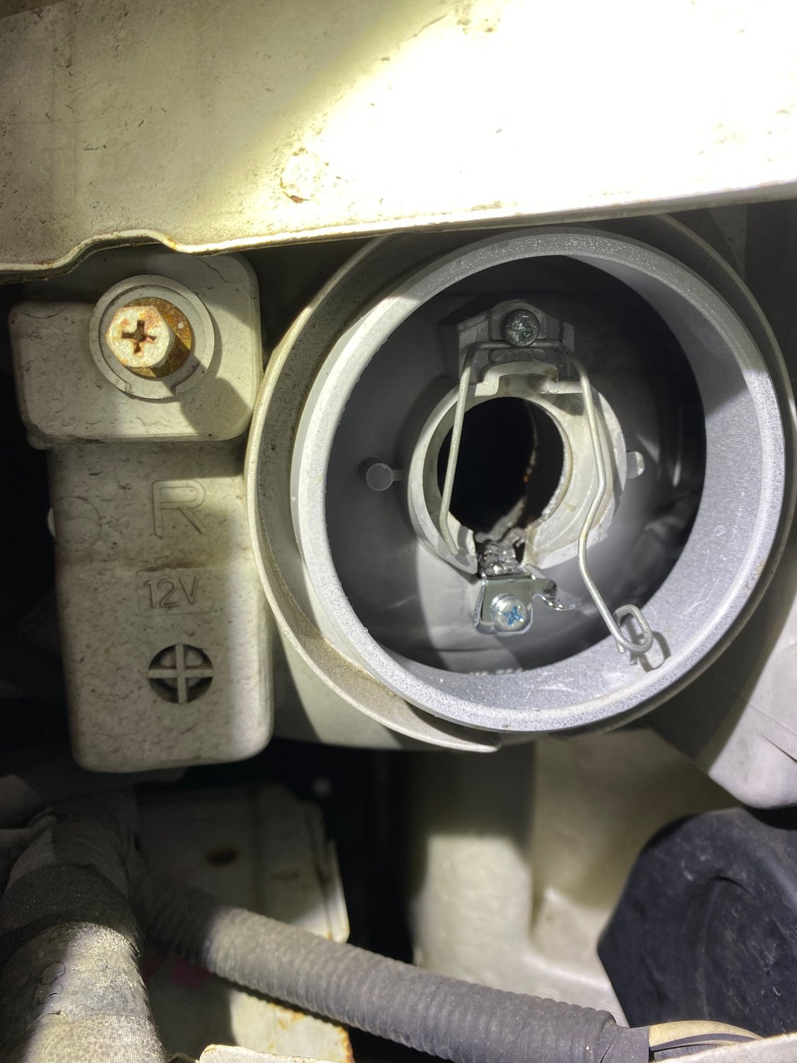

So I got the Auxbeam LED bulbs, they do not fit on the 98 ES300. Unless I'm missing something, I couldn't figure out how they would fit without modifying the gasket that seals the low beam bulbs from the elements. See pictures for reference.
I ended up ordering OSRAM H7 Night Breaker Laser bulbs.

Remove collar, put on the boot, put collar back and clip into the housing?

Tried that, the boot is very thick and it’s in the shape of a cylinder so there is a lot of pressure in the collar and it feels like you’re gonna tear the boot. Also clipping the bulb into housing would be extremely difficult with the boot in the way.
I wasn’t sure if you had these bulbs on a 97-01 ES or you simply suggested that I try them because they’re on your other vehicles. Have you run into the same installation issues?

I put them in an Avalon, and in two of my cars but none of them have a boot to worry about. Generally with LED bulbs you have to get creative for the ES I would grab some boots from a salvage yard or maybe from a different car. The effort is worth it you'll have way better light.
edit - the boot 90075-65002 is $5/each could grab some new ones and modify. Going by your picture if you cut some off the end of the small part it should work. Did you at least try them out to see what the output was like?

Gotcha. I’m gonna try fitting them one more time without the boot, I got stuck trying to figure out how they would fit on my car with the extra wire and module in the way so never got around to fitting them inside the lamp. I was only able to see if they turn on, which they did.
