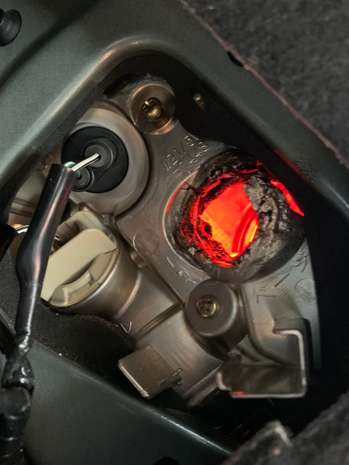

Hello, the socket to insert the brake bulbs is melted. I'm not sure how that occurred but now I need to replace it.
Where can I find the replacement for this whole part?
Here's a photo.

Can you give us a little info about your vehicle? Year, model etc.

Oh sorry, 2005 ES330
I bought it recently last October sitting at 240k mileage.

You need a new tail light. This happened because of high resistance meaning a poor connection between the bulb and socket. Not a difficult part to find on Ebay.
