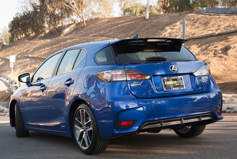

If your Fuelly is correct, you're at 970k, so I imagine you're quiet cause you're waiting to make that 1M mile post. but wow that's crazy, you're filling up once, sometimes twice a day. i guess it makes sense. Ever consider a aux fuel tank? i don't know how that would work but i'm sure one could be rigged up.
When you do make your 1M mile post, please include a list of items replaced. i'm sure people will ask. And of course pics! So we can see how a car wears after 1M miles.
here's mine from back in the day! 2016 brand new. great experience. one of my happiest car purchases
