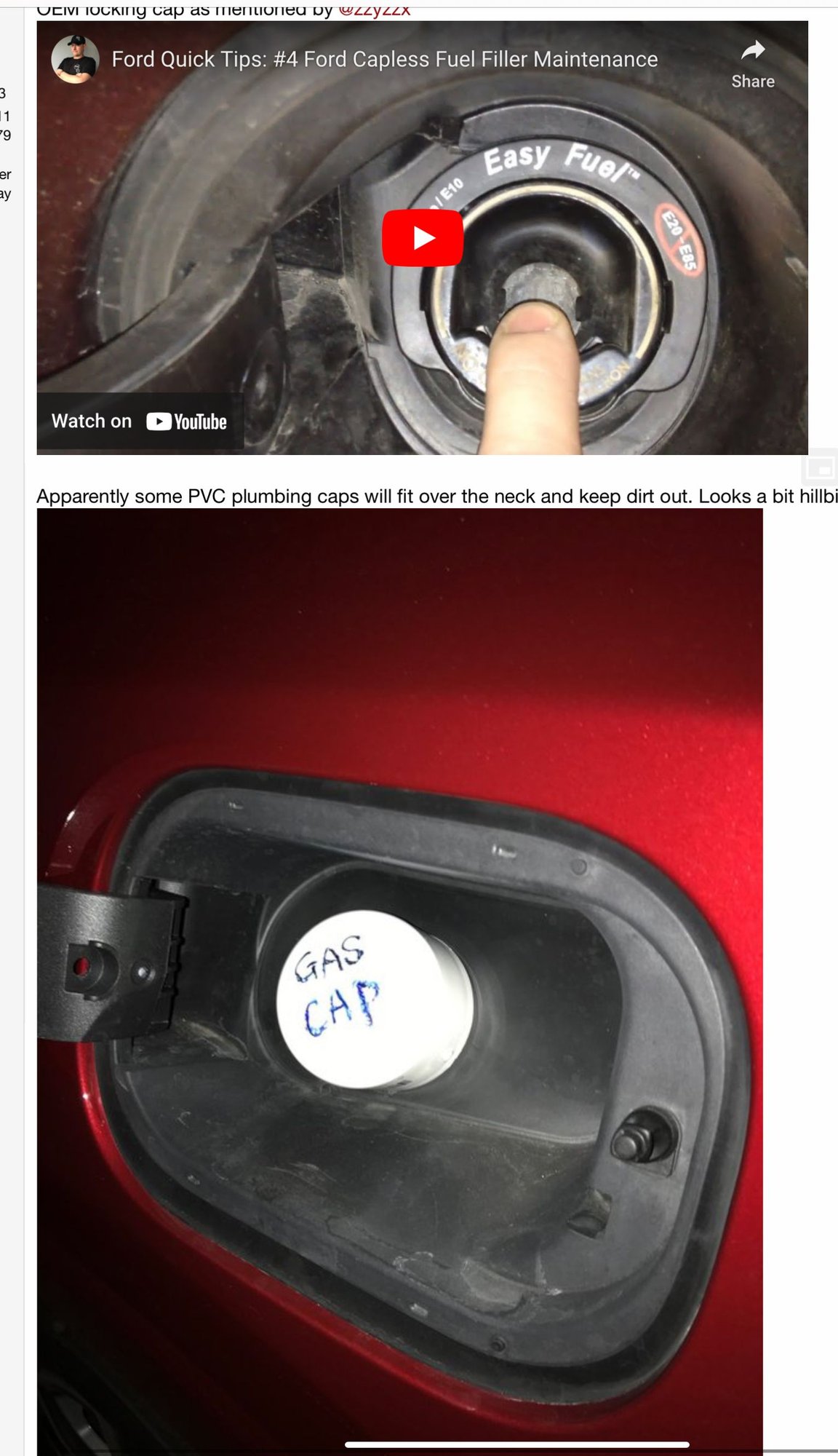

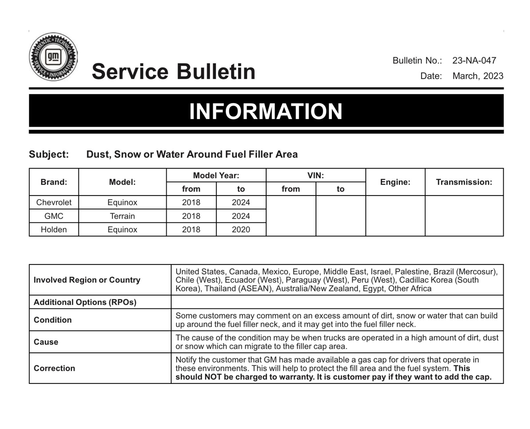

Things can happen to any setup, but thats not a common issue. Remember I post on forums for vehicles that have these capless fillers and it’s just not a common issue at all even on older cars.
They are crap
a gas cap is the fix

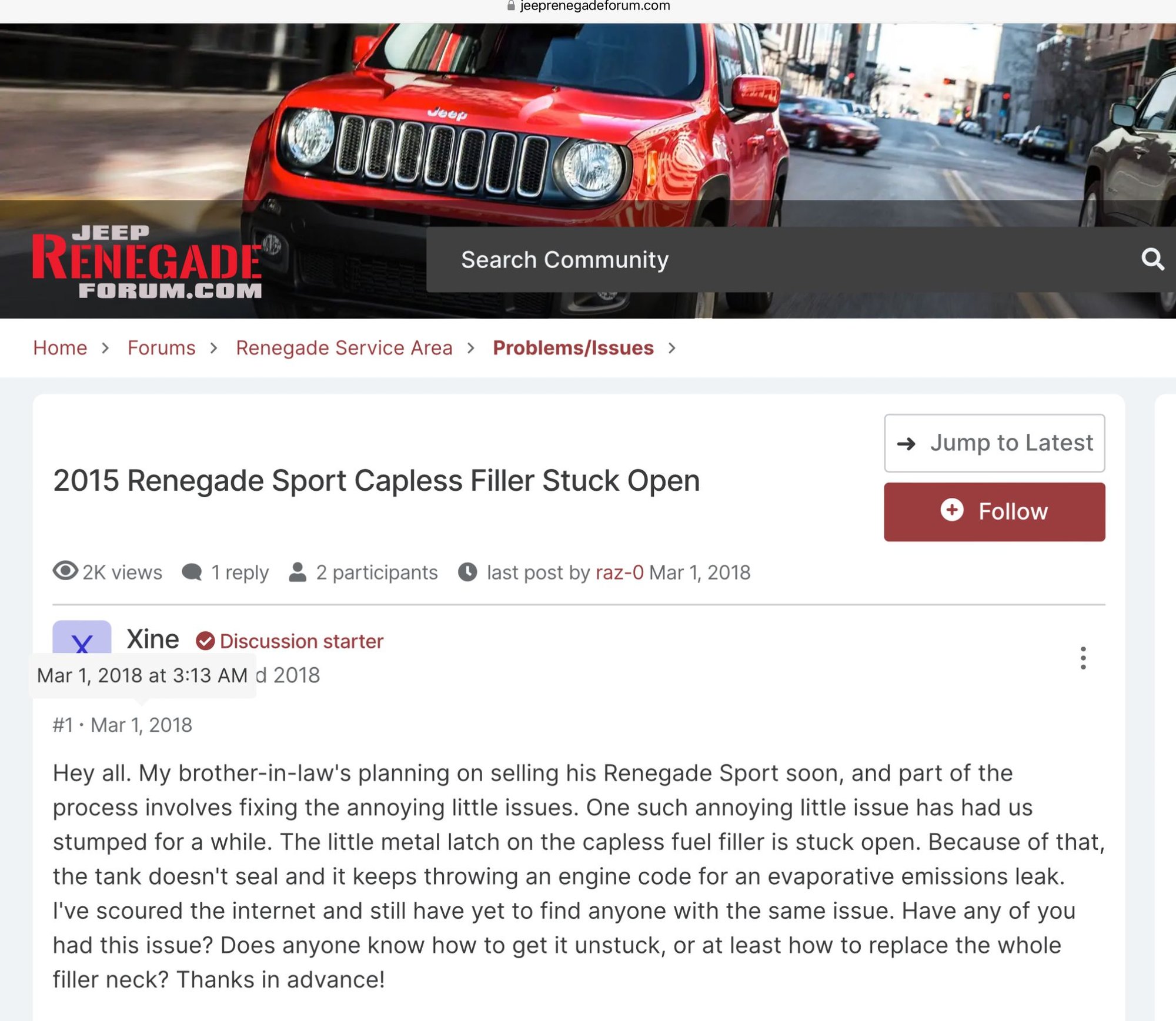

had no issue with capless on my jeep.
https://www.jeeprenegadeforum.com/th...ck-open.91985/
