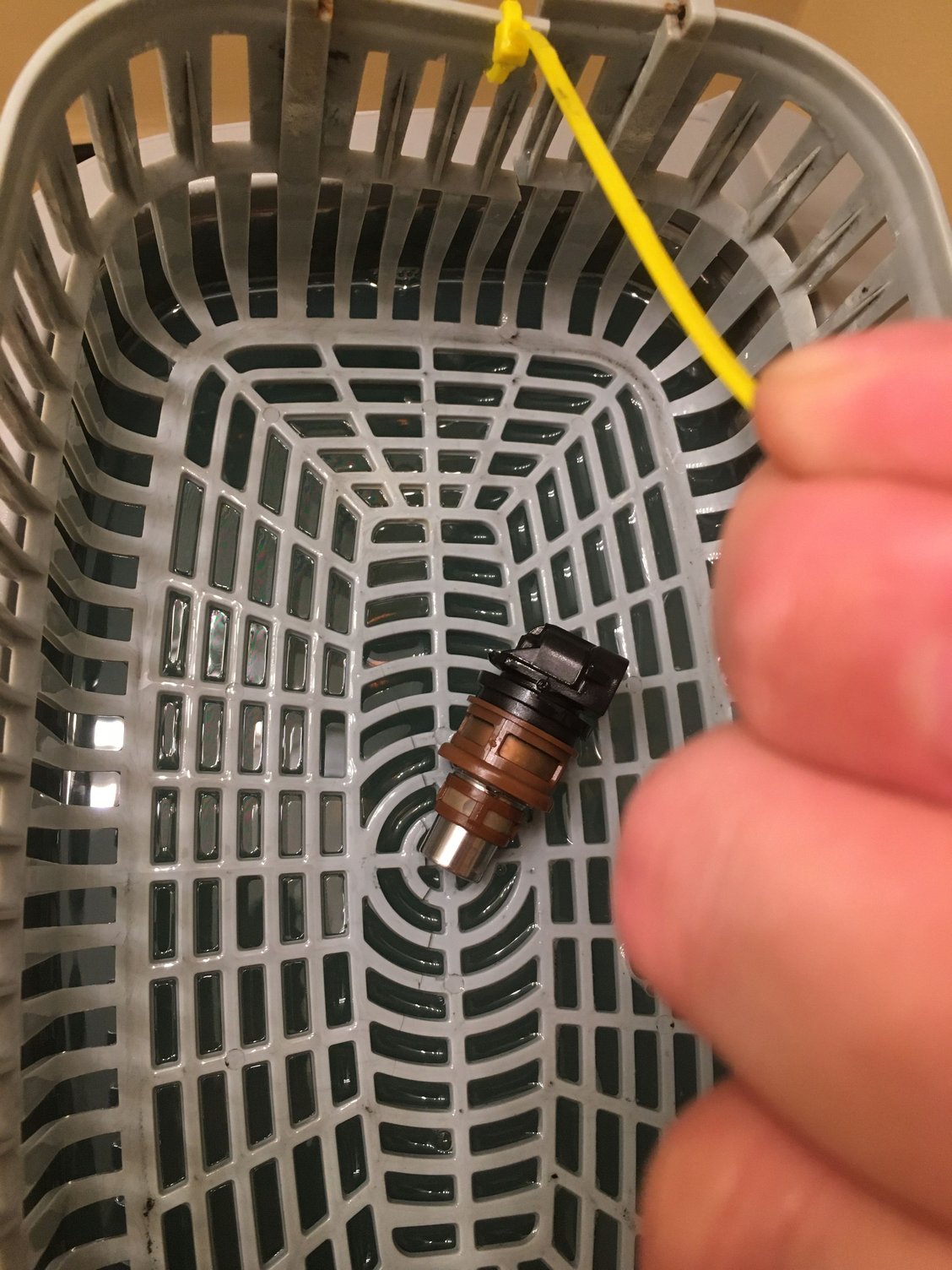

The entire fuel system sans intermediate lines and the injector that was instead ultrasonic cleaned.

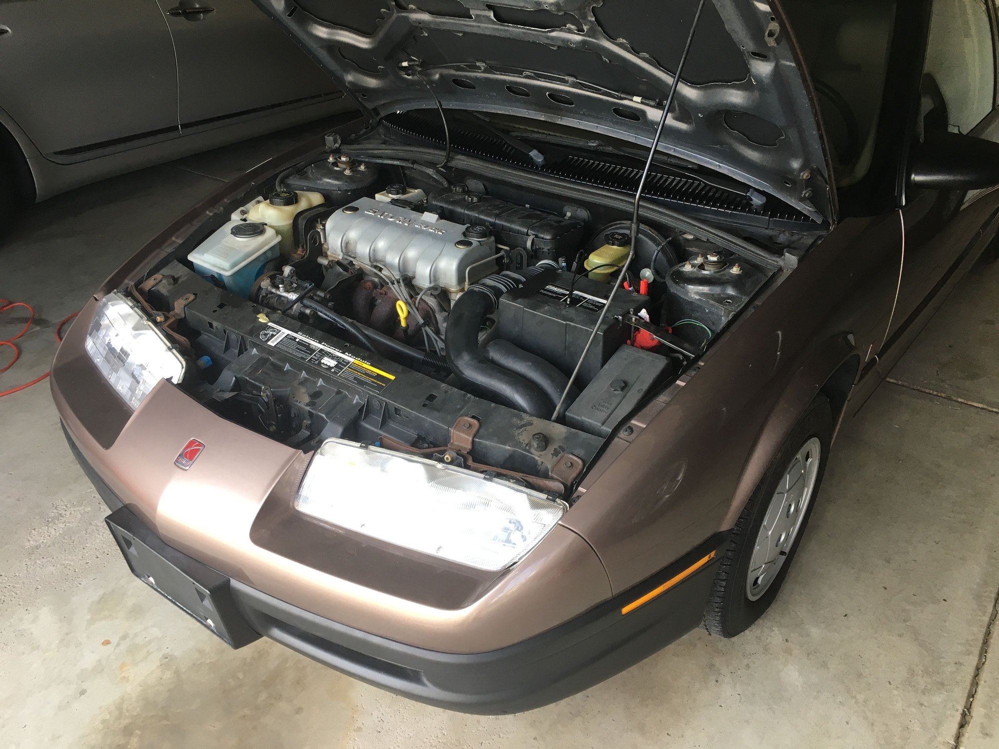

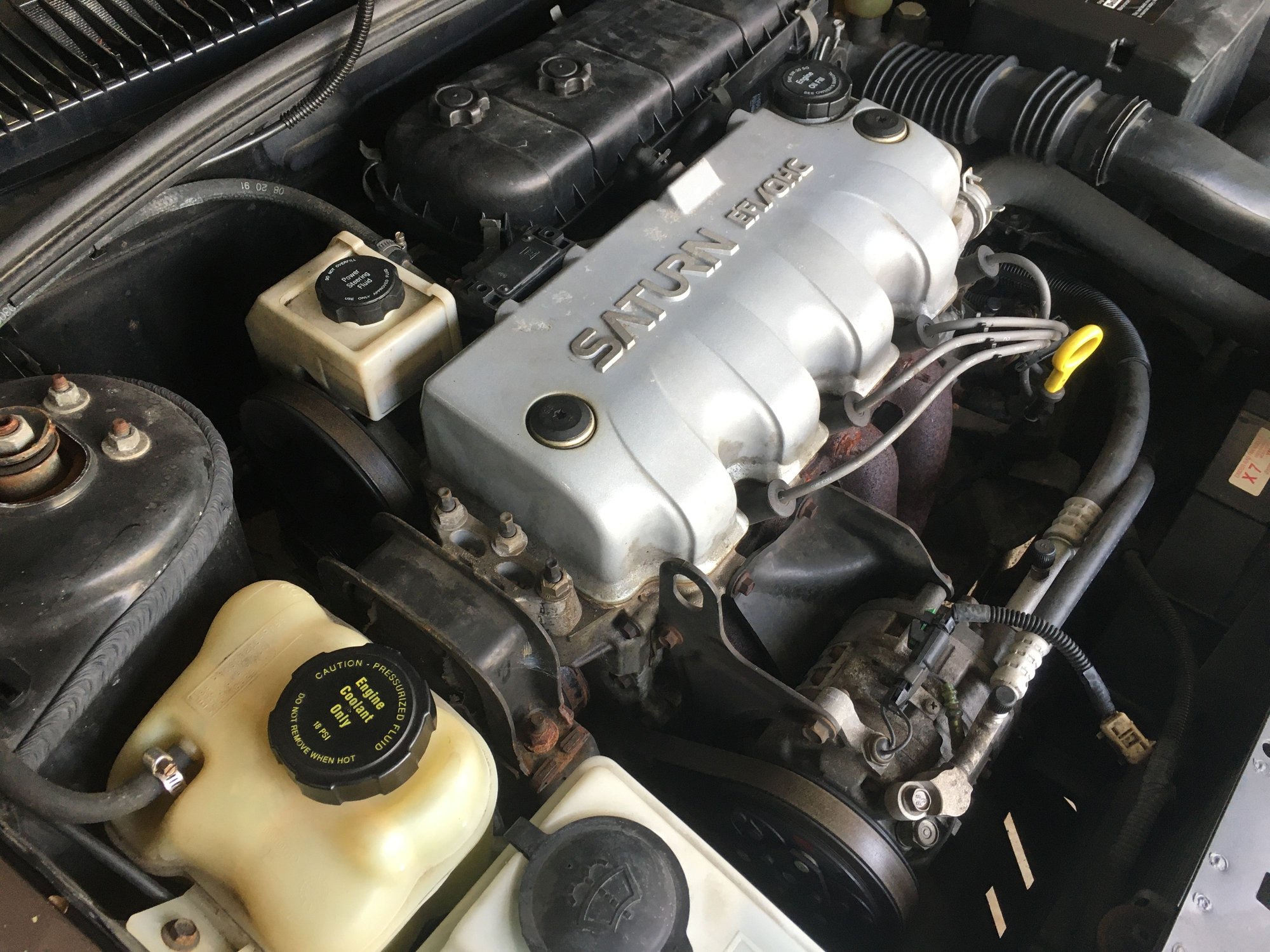

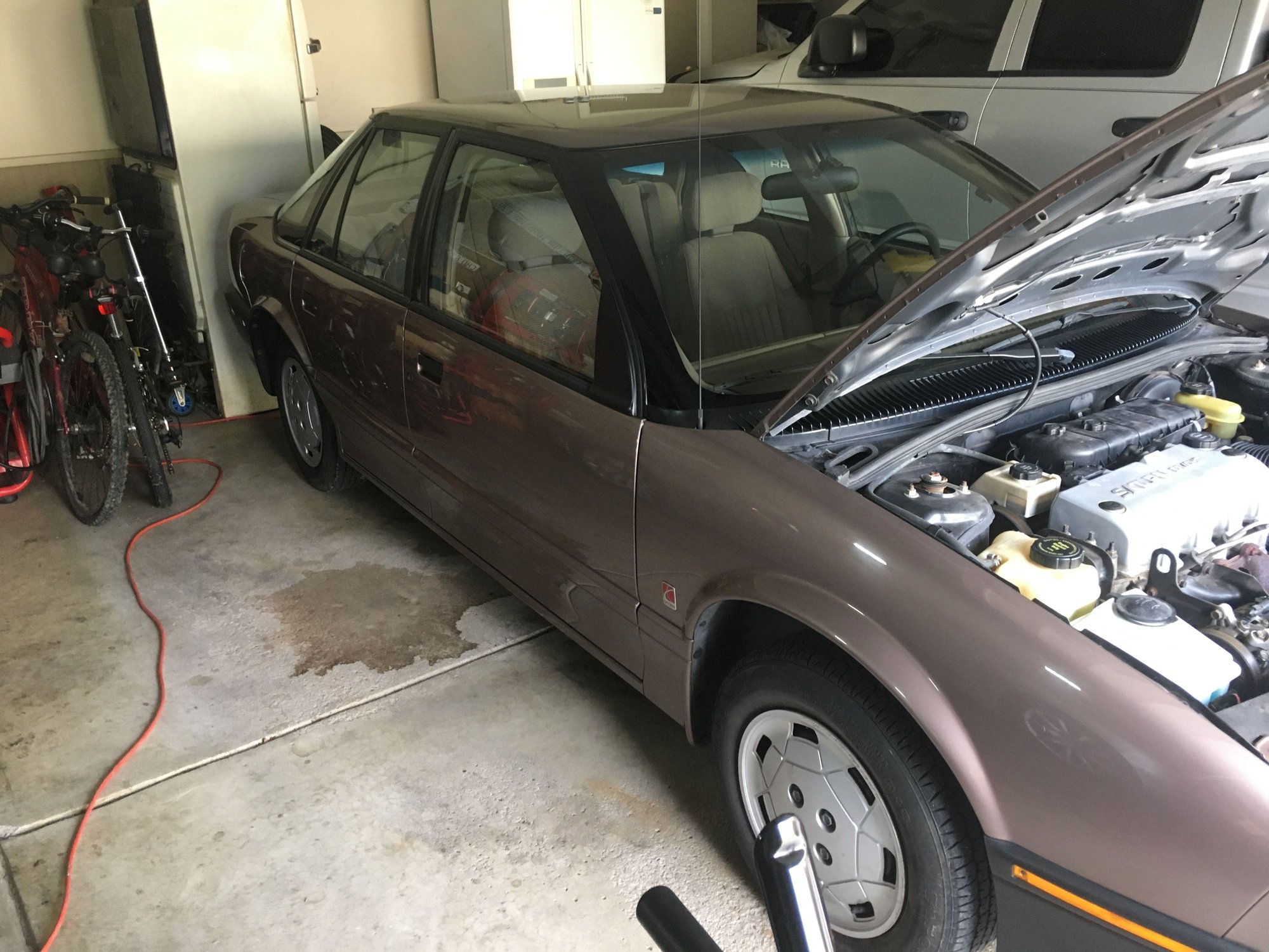

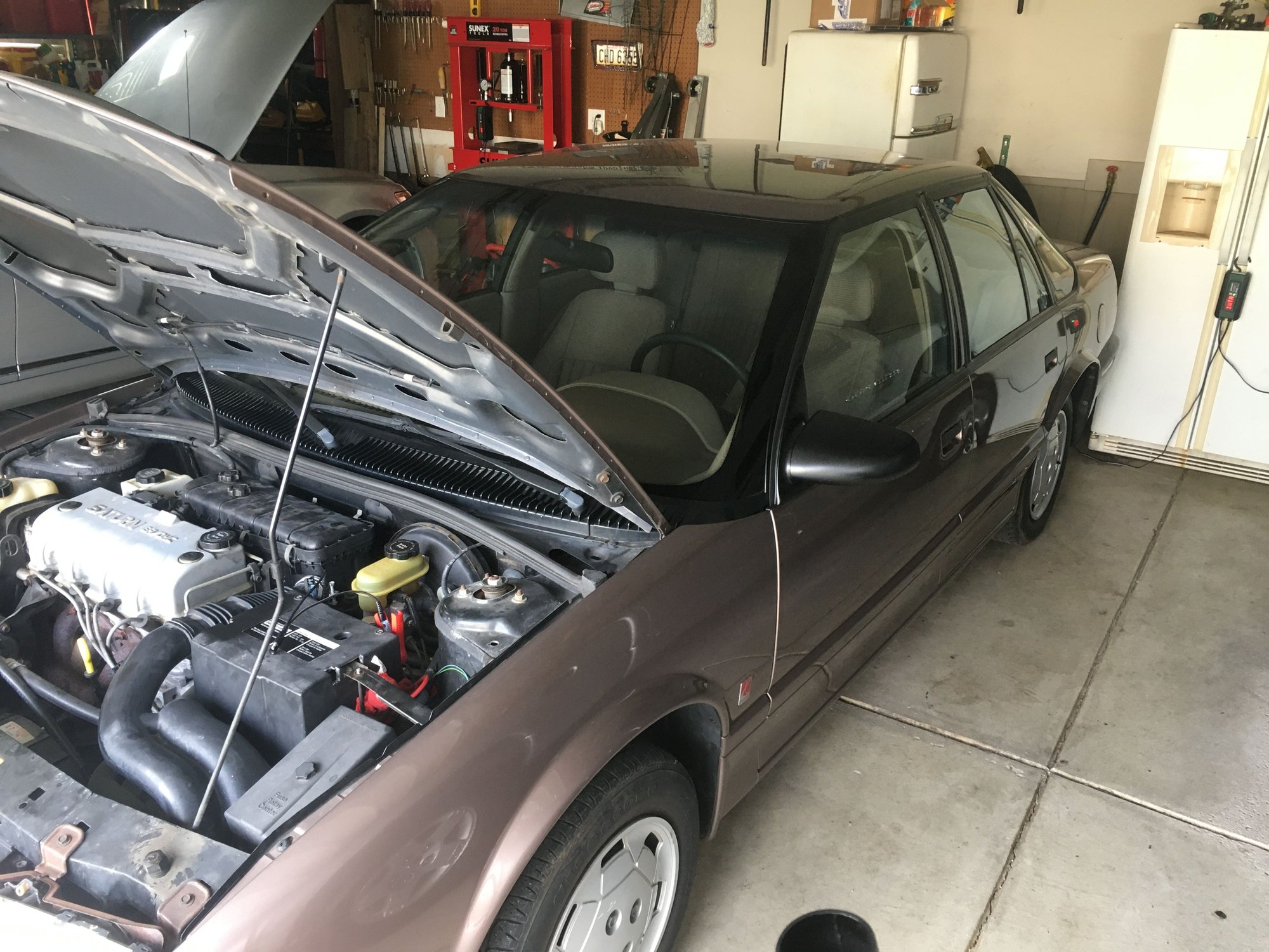

Here are some pictures as the car sits following its drive, today I pulled the alternator off while waiting for the replacement to arrive.

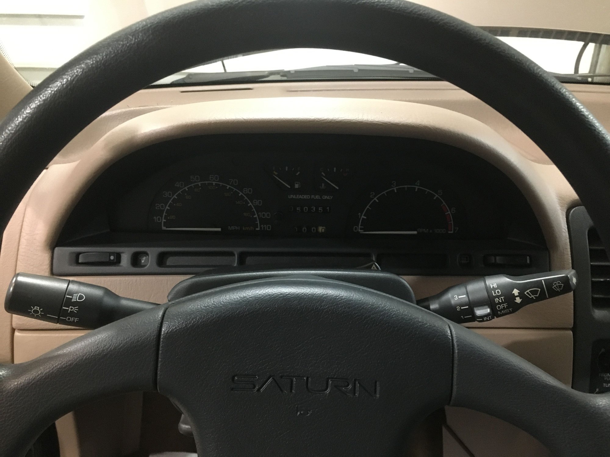

Needs the left side bulb replaced, I may have done that on accident when I had the dash out

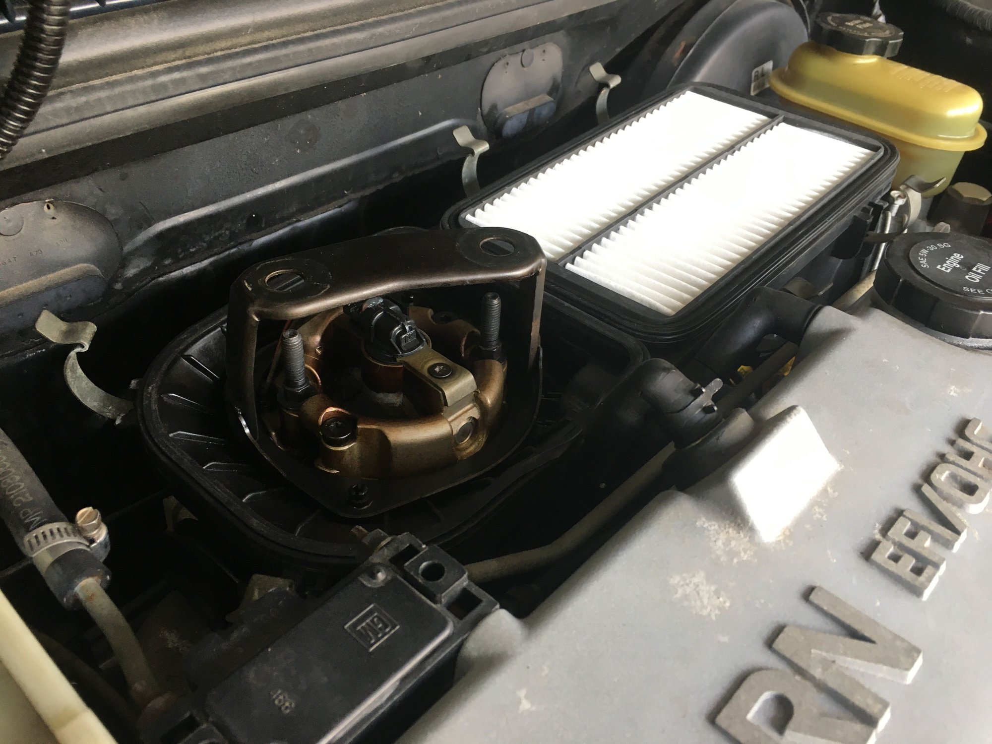

Good old TBI injection, never thought I would own of one these and I've only worked on about 5 total. You just never see this system anymore but I'm glad it's TBI since I only had to clean one injector vs 4

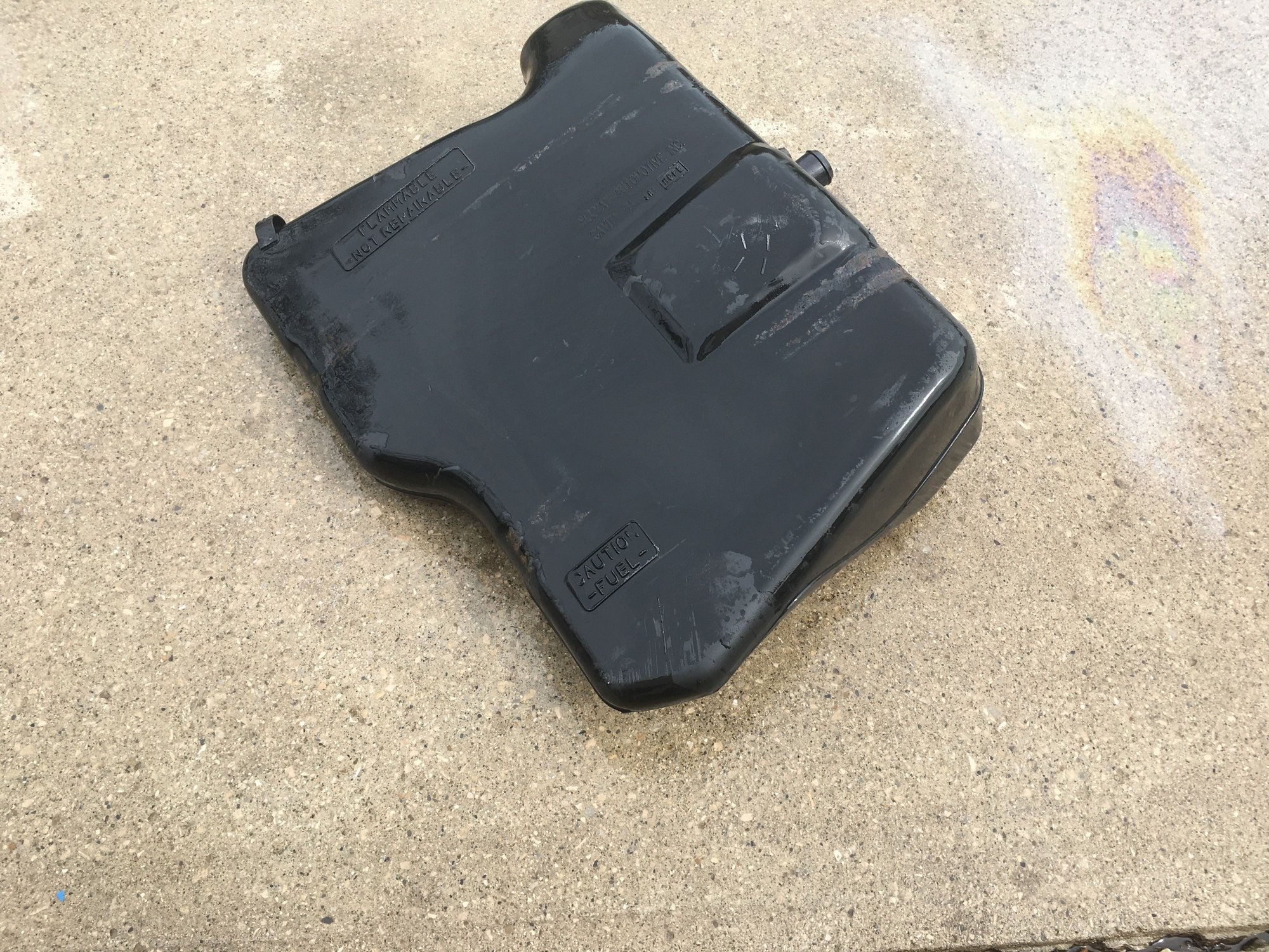

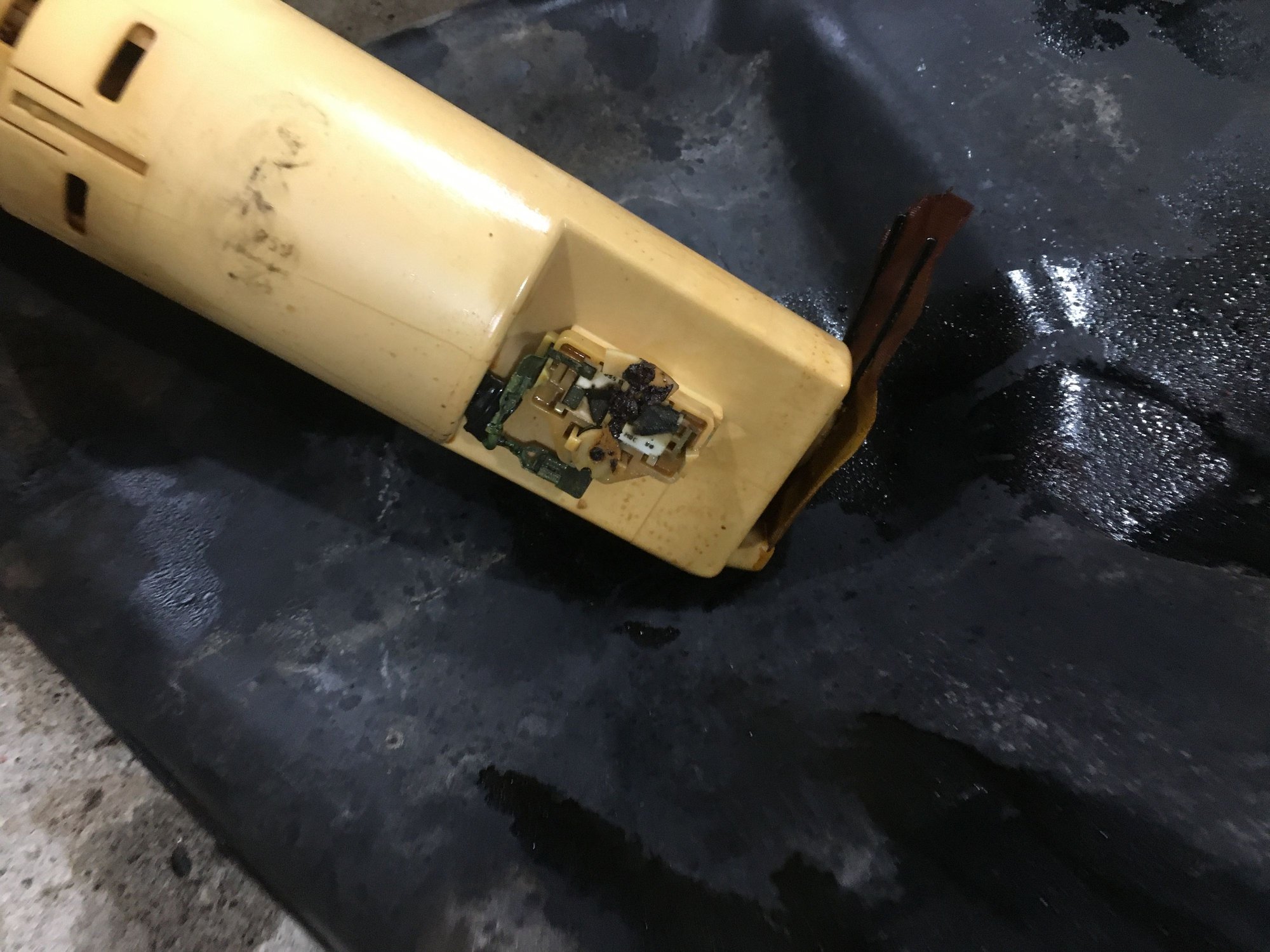

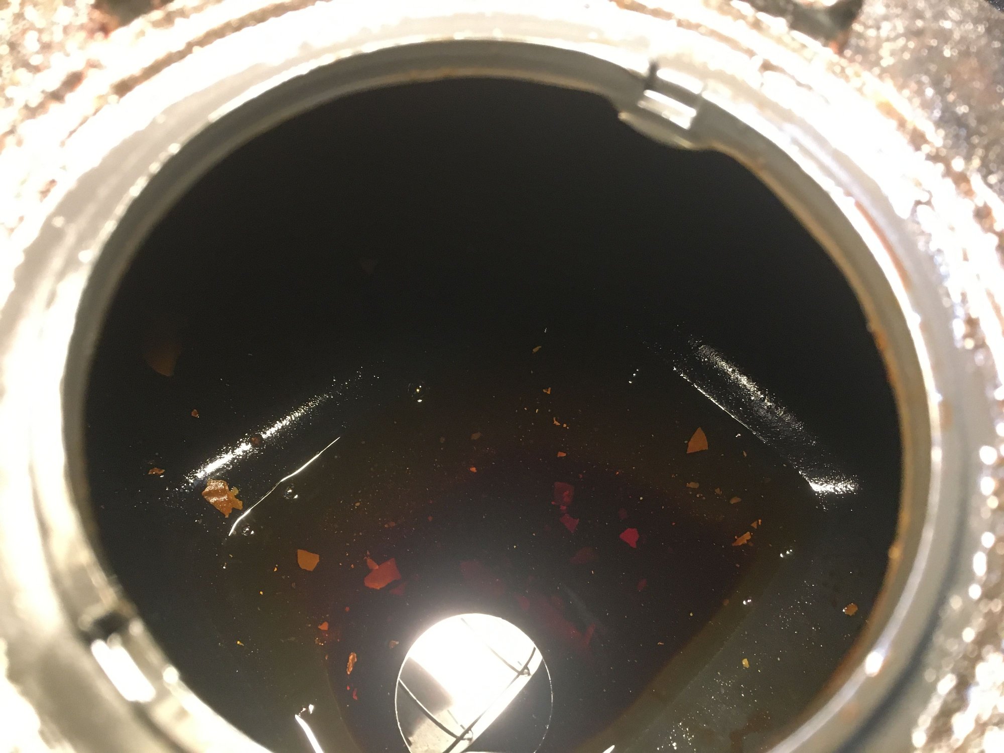

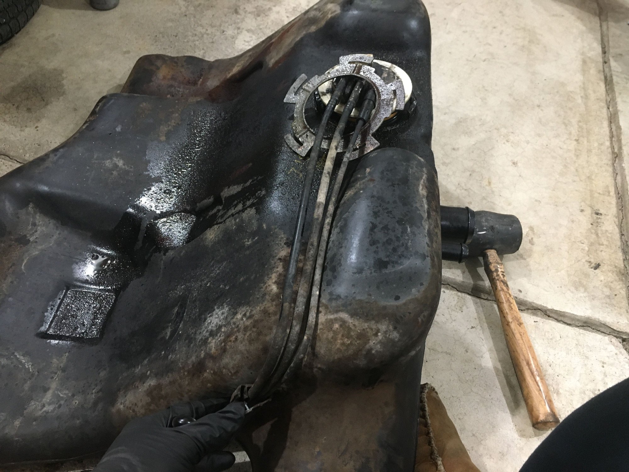

First 30 min, the old gas was so soildified I couldn't get the filter screens off at first.
Somehow I found a new pump, only $27
Tank is in good shape minus dirt
Old pump was seized solid, the fuel float arm rusted away off the sender entirely, despite being made of stainless
Tank getting power washed on the outside
Horrible amount of hard varnish and denatured fuel, closer to crude oil near the bottom

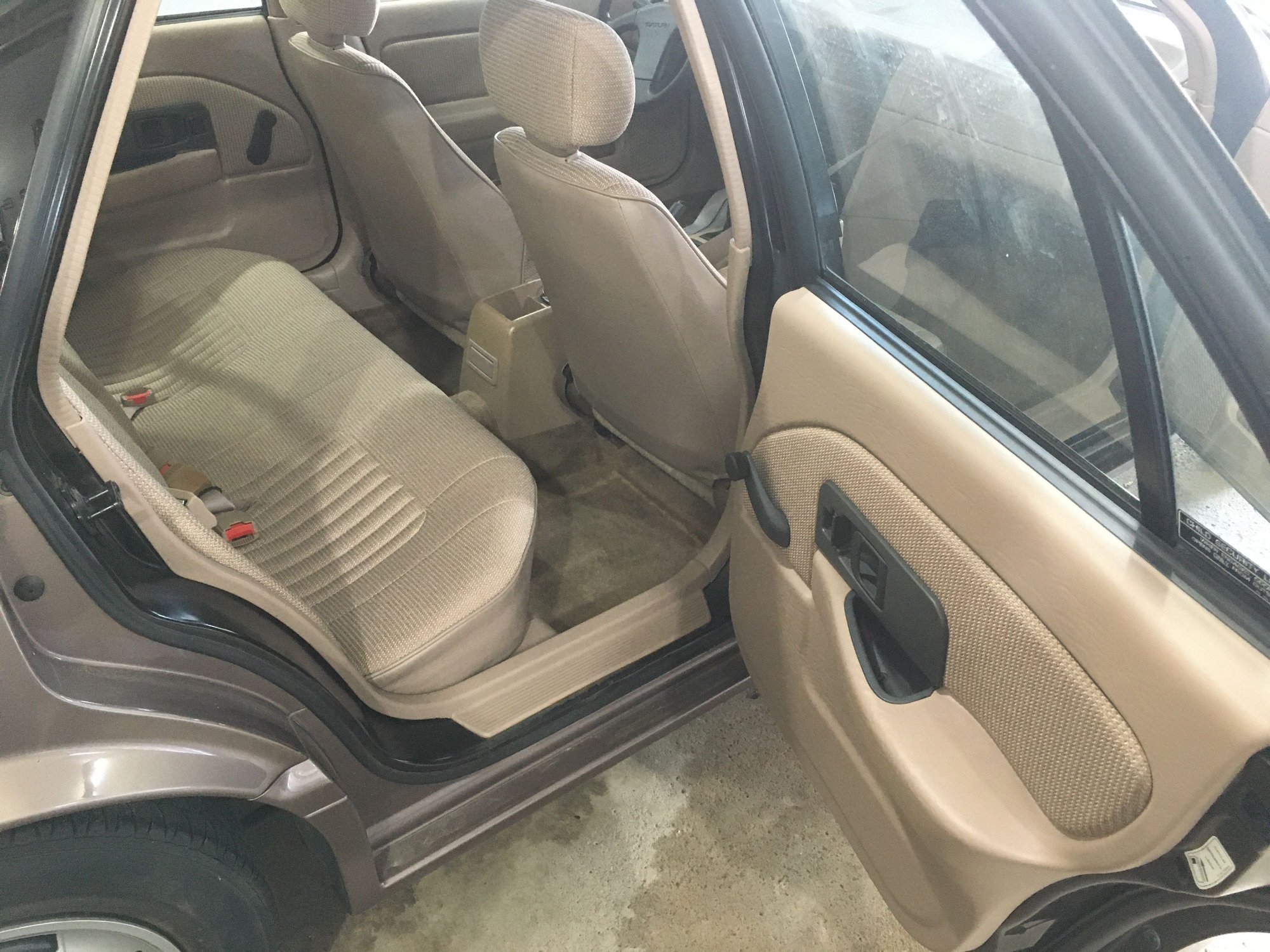

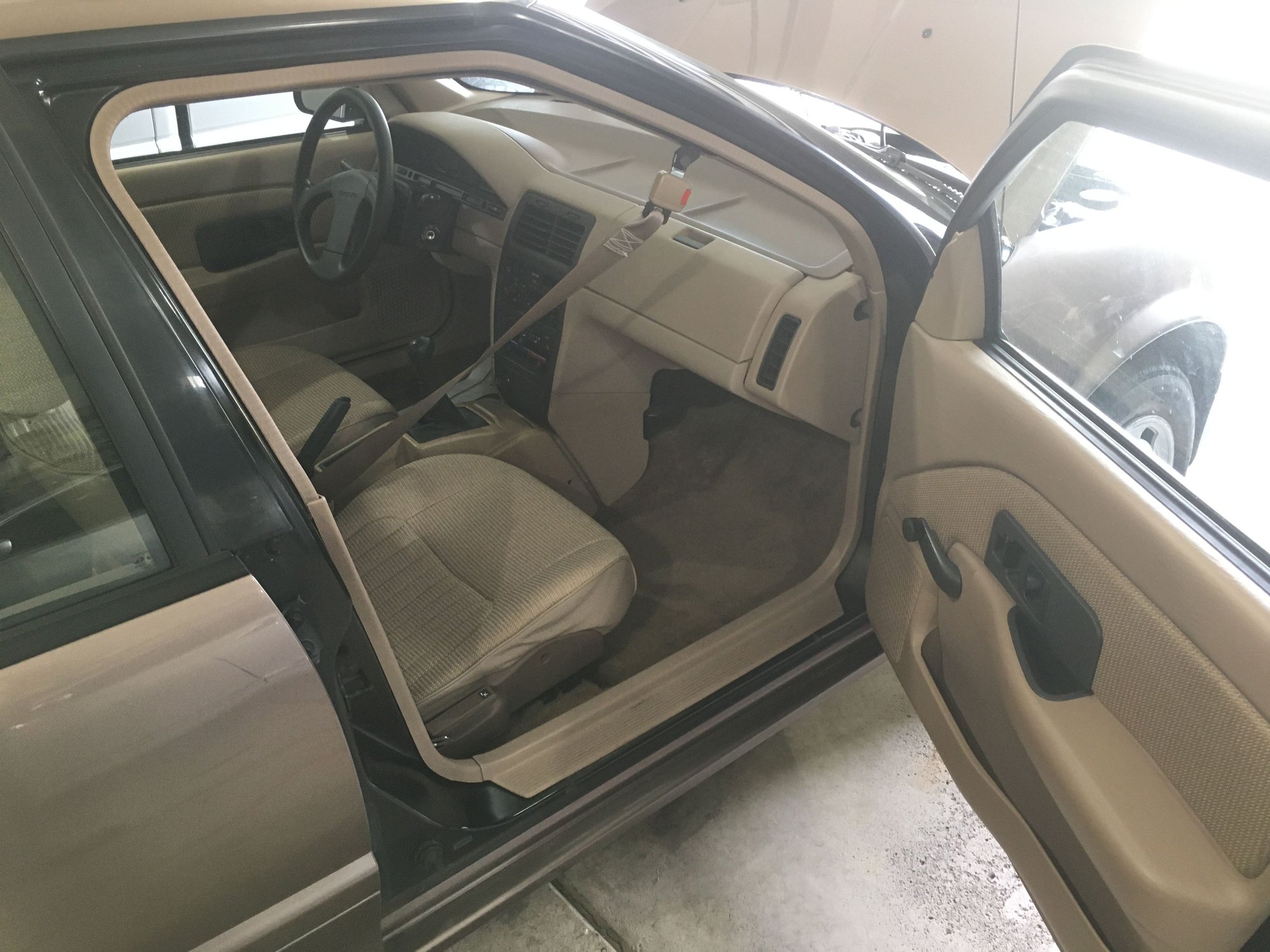

The interior was not that nice when I got it, I'll have to find the pictures of it as it sat when I first saw it. The set I linked here looks good since I removed the entire interior and really cleaned it up then put it back.

100% USA made, everything on this car was made here including the pump. It just couldn't withstand the fuel turning bad, it started out so with what looks like a 3/4 tank worth of gas when it was parked in 2000. The gas turning took out a lot of stuff in the system, I'm just happy I was able to find a pump and get the injector working again.
