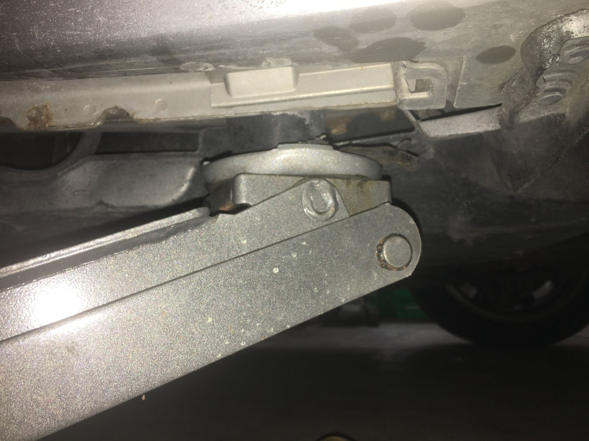

We've discussed this a little in some other threads, but I had an experience today that really made this point well.
As you know I have owned many Asian cars (primarily Japanese Toyota and Lexus cars, but I did also have a Korean Kia) and American cars (Ford, GM and Chrysler), but my 2020 S560 is my first German car. The difference in philosophy is really interesting, Asian and American are typically very similar.
My wife's family was in town until today, they have a 2017 Honda Odyssey. After they were all packed up they found that it wouldn't start. Battery was totally dead. I have a ultracapacitor jump starter, but other than that I don't have any jumper cables or jump box or anything like that.
Looking at the engine compartments for the three vehicles here, the thought that went into how one goes about jump starting each car is a really good barometer of the difference.
The Honda you just have regular battery terminals, and you have to struggle to find a neutral ground, none is labeled or straightforward, which is common with Asian and American cars in my experience. We screwed around with the Ultracapacitor and it wouldn't work, which I chocked up to it being faulty. So, we had to get in the Mercedes and go buy jumper cables. Hooked the Odyssey up to the Pacifica (Ain't jumping a car off the Mercedes) and, no go. Figured out, it was a grounding issue, and we tried another screw and it fired up. But, that lack of a well labeled neutral ground cost us over an hour and a trip to an auto parts store. Other issue was big terminals and the cable clamps not hooking on well, the Pacifica was better in this regard as it has a little post off the positive terminal for that, and you had a nice neutral ground but there was no bright label (it is labeled, just doesnt jump out at you). On the Odyssey clamps popping off leads to danger which leads to people getting shocked, and the lack of an easy to find neutral ground leads to people hooking the negative clamp to the negative terminal of the dead battery which risks frying the electrical system. These issues were thought through in the Pacifica and moreso on the Mercedes.
When you look at the Mercedes, theres a red slding door with a positive logo that reveals a simple flat metal tag the jumper cable perfectly clips onto. Then there is a negative logo, and removal of that panel reveals a big, beautiful neutral ground to clamp on to. Simple, well laid out, foolproof, safe. Why don't Honda and Lexus/Toyota lay it out this way? They certainly can...but its a little mechanical detail thing that shows you that Mercedes gives these things a little additional thought.
Is Chrysler unique among other American cars in this way? I know none of my Lexus/Toyota cars ever were, you always had to deal with the terminal and finding a ground in them too. I wonder if this is a result of Chrysler's time spent partnering with Mercedes or if Fords etc are laid out this well now too?
Mercedes positive jump point:
Mercedes neutral ground:
Chrysler positive jump point:
Chrysler neutral ground:
Kind of interesting, because (maybe just in my mind), I've always thought of the Japanese to be more straightforward and user friendly in their craftsmanship, with Germans tending to be more "over-engineered" (sometimes for the better, sometimes not). Maybe a bad example, but think cup holders - the Japanese started using this simple feature in a more widespread fashion; Germans (and other Euro brands) had these flimsy, retract-out-of-the-dash worthless cupholders, which seemed to be added begrudgingly.
Even now - BMW has all these features and options in their cars that are available that need to be "coded" to enable - instead of just the ability to change in a menu. I'd love to have my car automatically unlock when I put it in park, but I just don't want to order a cable, hook up to a laptop, and then decipher all the codes. I can enable auto lock in iDrive, but not auto unlock - why so complicated?
My $.02.
