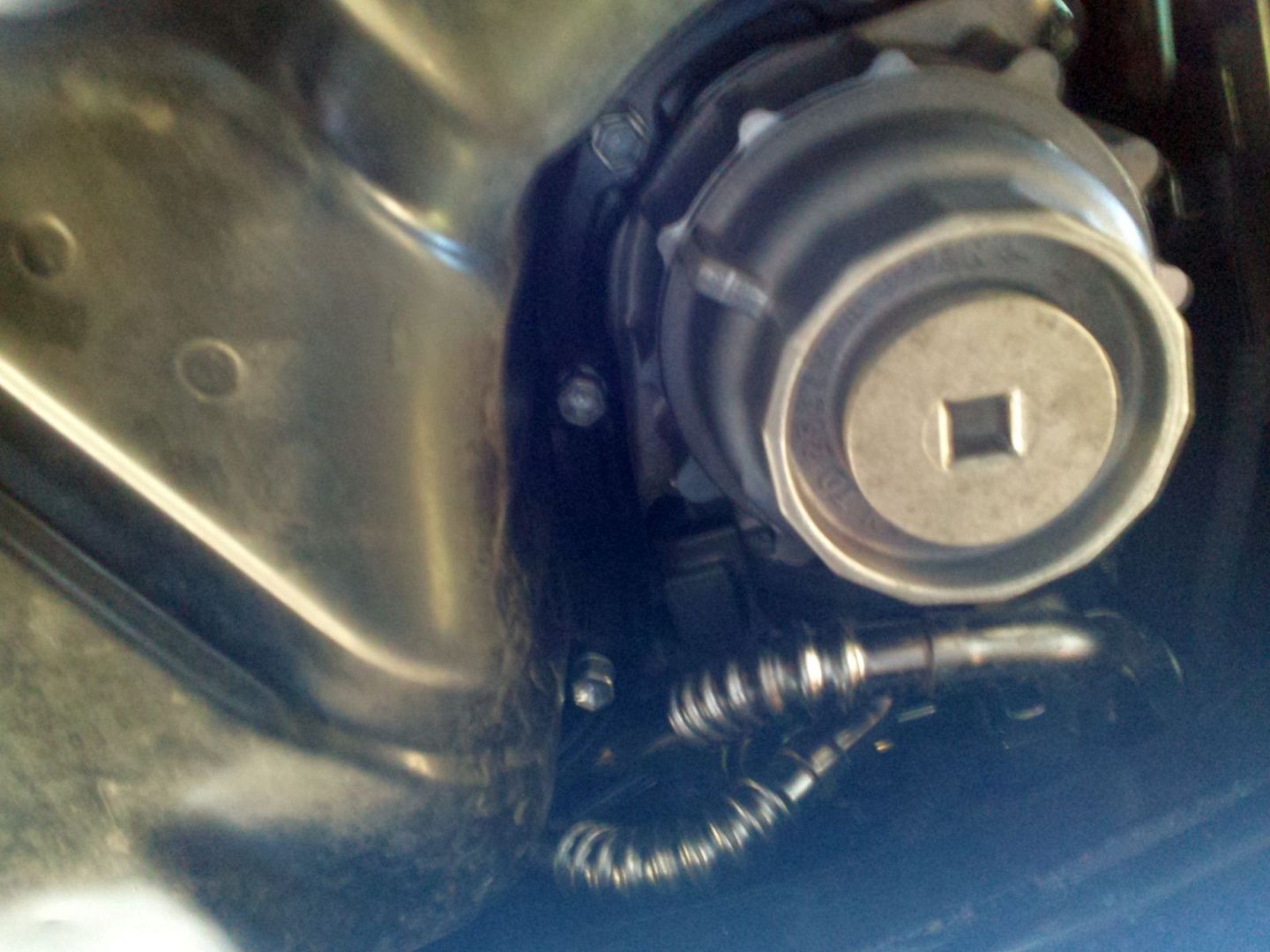

Interesting write up What was the reason it lost on its oil on the roadway?
They mentioned the "catastrophic VVT-I oil hose failure", which is one of two "defective by design" oil hoses with the 2GRs of that era that could result in a loss of oil and significant engine damage. This one is the feed line for the VVT-i actuator. The fix is to replace the faulty hybrid unit on the right with the all-metal one on the left:
There was a limited service campaign to replace them, but Toyota's VIN tracking system did not work properly, so many vehicles that should have been eligible (and the owners notified) were not. Here is a DIY for the replacement: https://www.toyotanation.com/threads...l-line.432008/
The other was the feed line to the oil cooler on vehicles equipped with the towing prep package, like my 07 RX350. This was a pair of rubber hoses that had a tendency to rupture when aged, dumping all your crankcase oil on the pavement in a matter of seconds, often resulting in seizure of the engine shortly thereafter.
Like with the VVT-i hose, the fix is to replace it with a revised unit, one actually suitable for transporting hot oil under pressure:
Since mine had not failed, Lexus would not cover the replacement. So I purchased the part myself, and had an independent mechanic install it for me at my regular oil change interval.

That is interesting. So was it ever determined as to what causes the defective part to break? There are so many vehicles out there that some must still be on the road with no issues. Was it only limited to Lexus RX or was it on HL or other 3.5 applications?
The VVT-I hose was on all 2GRs in all Toyota/Lexus models for several years. The oil cooler hose was only on vehicles like the RX, Highlander, Venza, and Sienna, that could be configured to tow a trailer. I agree that there are probably some on the road that have not failed or been replaced. I mean, my oil cooler hose had not failed by 140k. But I wasn't going to take the chance of catastrophic engine failure to save myself $180. Lexus had already replaced my VVT-i hose under the TSB.

That is an interesting defect. I like to ask these questions. I wonder if there is a US/Canada supplier connection vs a Japan-made part. So I read that Toyota would replace it for free (if failed) I wonder if there is a leakage detection type thing to warn about a possible failure.
Doubt it. for the oil cooler hose (the one pictured above, and the failure that occurred on my car) you were able to take the vehicle in before the failure happend and get it replaced. For the VVT-I hose, i was told it was limited to only failures that already happened. I was able to get it replaced at my dealership somehow though. I believe most of the recalls happened on early implementations of 2GR engines (2006 Avalon is included as well if iremember correctly)
