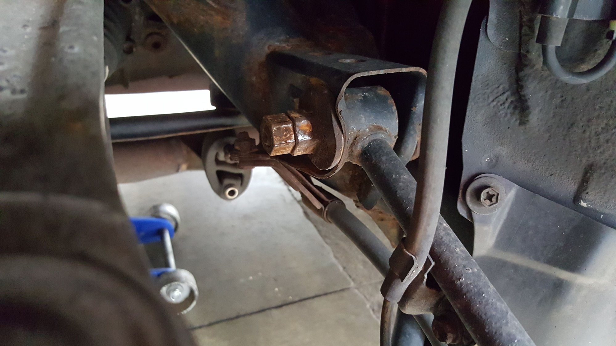

I had gotten new tires and had the local lexus dealer install them.
first fronts with an alignment all around.
then 2 weeks later had rears installed.
next morning the tire is rubbing my right rear fender lip. It Has never done that before.
I took the car back immediately and it was Saturday. There was nobody there to look at it until Monday.
I got the call from the dealer saying there was nothing a matter and I could pick it up.
long story short they told me to take it to my local performance shop and have them look at it. And this is what we found.
Right rear
Left rear
so now I have to go back to the dealer tomorrow morning. And drop the car off so they can look at what we found. We figure the toll was so far out it pushed the tire past the fender when they adjusted the camber to compensate.
any thoughts of how I should handle it tomorrow?
by the way it is a 2001 Lexus gs430 lowered with 19 inch staggered wheels. Bought from dealer with 11,000 miles they are the only ones that ever have done an alignment on it.

here are two more photos

Old Apr 24, 2018 | 08:14 AM
Posts: 80,810
Likes: 3,998
929rider, i've looked at your photos and have no idea what they're supposed to be telling me.
Old Apr 24, 2018 | 08:30 AM
929rider's Avatar
929rider
Joined: Jan 2011
Posts: 181
From: ohio
My service advisor just called me. They installed that nut and cam washer on an angle like that to get it into toe. They're telling me that's the only way they can get it into alignment.
+1, not seeing anything outta wack.
Old Apr 24, 2018 | 08:49 AM
929rider's Avatar
929rider
Joined: Jan 2011
Posts: 181
From: ohio
in the first photo the bolts with the cam washer is supposed to be sitting flush like the second photo.
the third and fourth photos are different angles of it the rounded lip that the cam washer is sitting on should have been placed flush.
they just told me they did it this way so the toe was within spec.
