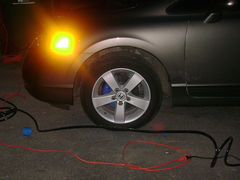

Going with metallic blue. the car is galaxy gray, but if it doesnt look right, i have a can of black rustoleum high heat, it goes over anything . i decided on Subaru World Rally Blue Metallic. I will do a How-To if anyone is interested. It really isnt that hard to do.

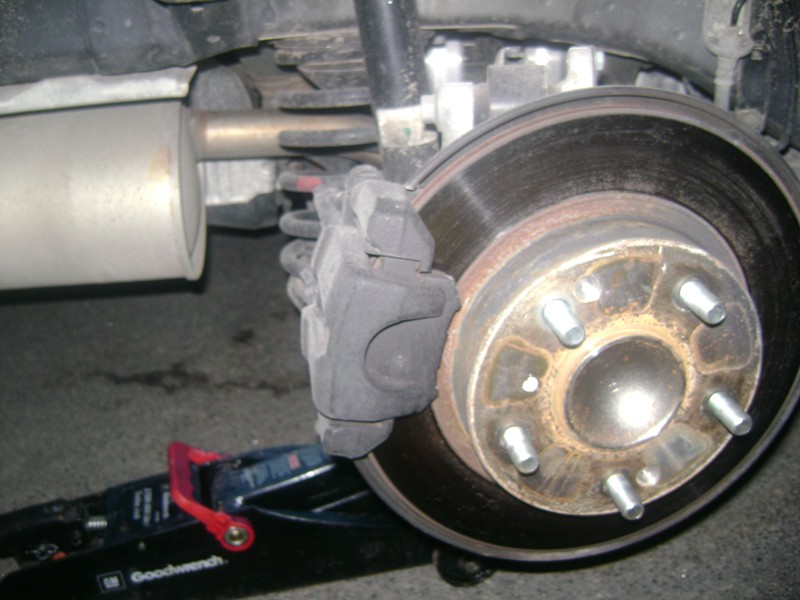

Before:

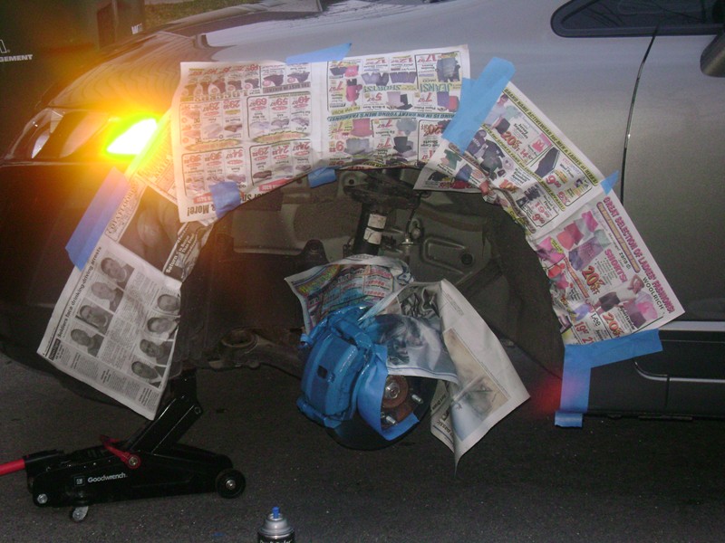

During:
Old Apr 13, 2008 | 08:17 PM
ArmyofOne's Avatar
ArmyofOne
Dysfunctional Veteran
Veteran: Army
Joined: Sep 2004
Posts: 8,101
Likes: 317
From: Van Alstyne, TX
(^This was base coat only)

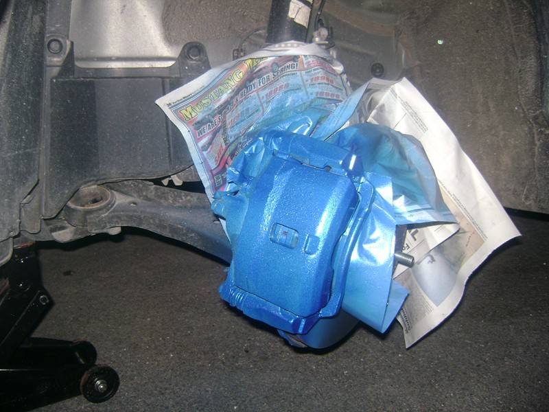

After:
^got a little overspray, thats ok it will burn off.
^oops, more overspray...:SHOCKED:

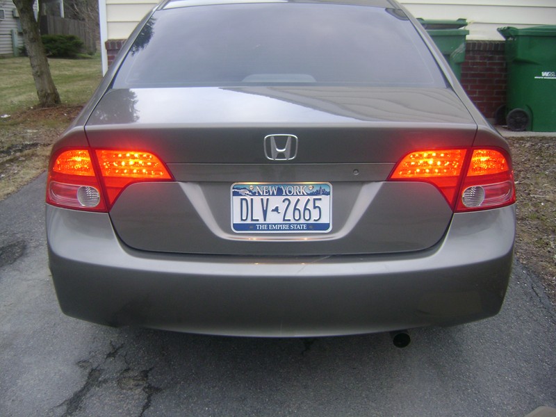

Oh, and the newly Debadged Rear...
Should i lose the giant "H" on the back too?
questions, comments?

i think i'd loose the "H" but i'm partial to complete removal of decals

Not bad. Maybe a little darker blue would have blended in a little. Anyway, I think you needed to mask off more area. You got blue paint everywhere

Well, there are 3 ways you can do it.
You can take the caliper completely off and apart, this is the correct way to do it. This takes ALOT of time and you will have to bleed the brakes and top off the fluid afterwards.
#2 is to take the caliper off the rotor and remove the pads...but if you are gonna do this you might as well change pads while in there.
#3 (the way i did it), just mask and paint. dont worry about a little overspray, as it will burn off or be covered anyway. make sure if you are using a multi stage paint system (primer, base, top and clear) like i did, that its warm enough and your calipers are clean. I primed with flat black rustoleum (i had rust on mine) then i basecoated a couple days later with WR Blue Base coat, then went with WR Blue Topcoat, then the clear, the last 3 i did within 20 mins of each other, taking care not to let the paint dry all the way for maximum adhesion of the paint.

just found out, cant lose the "H"...holes behind it...
