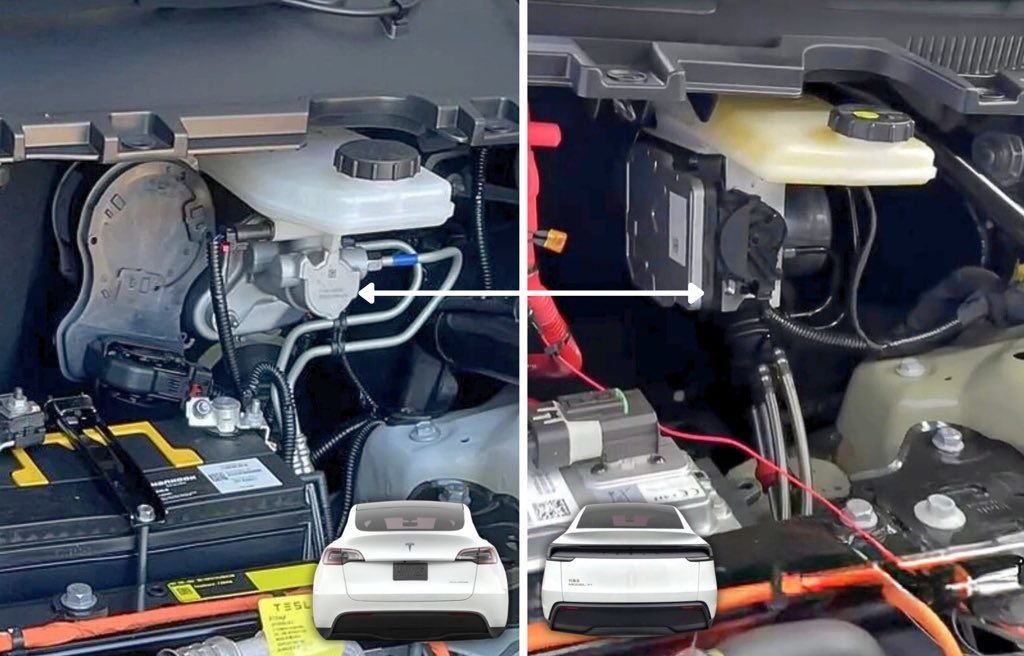

Two master cylinders but where? In one unit or separate? That clips gives me more questions than answers.
....old vs new
....old vs new
That brake package on the right looks interesting.
Looks like a master cylinder with brake actuator & skid control module all bolted together as one unit.

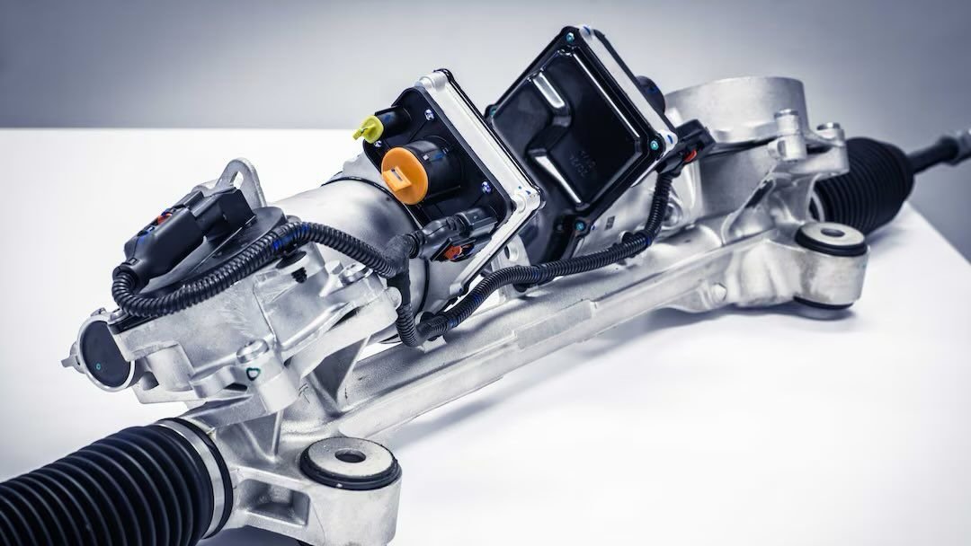

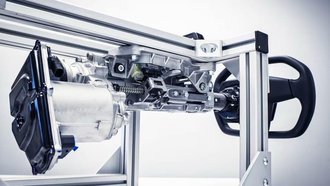

Originally Posted by LeX2K
Cybertruck steer by wire components.
That looks dramatically more similar to a "traditional" steering setup than I expected it to for some reason. Very recognizable column, rack, etc. Interesting stuff, thanks for sharing!
Motor turns steering rack controlled by angle sensor on steering wheel. Easy.
I'll post a vid explaining the system if I find one. This should be in every Tesla except it requires 48 volt architecture, supply chain can't do it at scale currently.
my lc500 has toyota's vgrs (variable gear ratio steering) - i believe it is entirely mechanical... pros/cons? i guess a big pro on the tesla one is it can be reprogrammed/tuned via software.
but i do love the vgrs on my lc in combination with rear steering.
