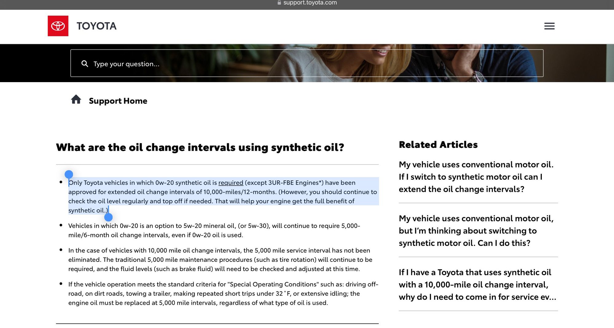

Likes: 409
Yet the car we are talking about is a Lexus lol
No comment about the vehicle engineers in those videos that agree with us? Got it! We’ll just pretend those weren’t posted. Who’s the one saying they know more than engineers now?
I’m criteria A with a twist, 10K LET.IT.RIDE!!!🎲🎲. You’re criteria C and following criteria A according to this guy.
