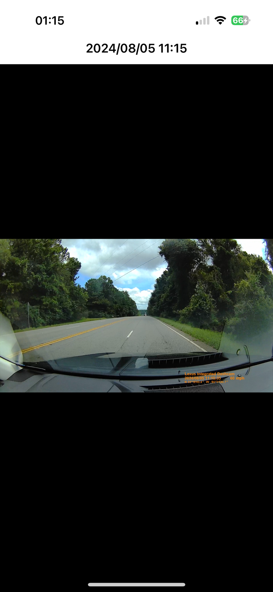

I don’t know why they make the app so difficult but on the first screenshot below, you’ll see that you can select a downloaded video but the only option is to delete it. If you actually start watching the video (on screenshot 2), there are non-marked areas of the white header area with the date/time. If you click on the left corner, it will return you to the previous screen. If you click on the right corner, it will once again allow you to delete the video. If you click just to the right of the time then it will actually pull up the screen where you can save it to files and then you go to files to save it to video.

On iPhone it’s a process. Downloading it will only allow you to view it through the Lexus app. In order to actually be able to view it outside of the app and therefore upload it to an insurance adjuster or whatever you need it for, you’ll need to re-download it again. I figured it out but the user interface is terrible. Surprisingly, the download didn’t take very long which I had heard was a complaint. It downloaded 183mb’s pretty quickly for me.

So you can view all videos in the app. You can then download any video(s) to your phone that you obviously don’t want to be overwritten on the SD card. You will see the file download because you’ll watch the file size and download just like any other download. They will be in your download file in the app and you can then view the video — but again, only through the app. It doesn’t download to your files or photos app. So there isn’t any way to transfer/upload the video to someone else (e.g. Insurance or whoever else may need to see the video besides watching it with you on your phone).
Now you can obviously remove the SD card and pull it that way. My issue was trying to export it outside of the app. Holding down on the video itself with your finger didn’t pop up any options and all of the options on the main download screen only allowed you to select videos to delete. It was only after I realized that there are non-marked areas in the header that will actually pop up the normal option to save it to your files where you can access the video outside of the app.

I was having the same issue with iphone. I tried and this is how I got it. You tap to watch the video on your iphone app. On the top of the screen you see date and white background bar. I tap once on the far right corner of the white background and it pops Iphone delete / cancel option. I tap just left of the far right corner of the white background bar and it pops Iphone screen where you can select to text, save etc.. This looks like invisible tap options which is really weird... Hope this works on your iphone.
