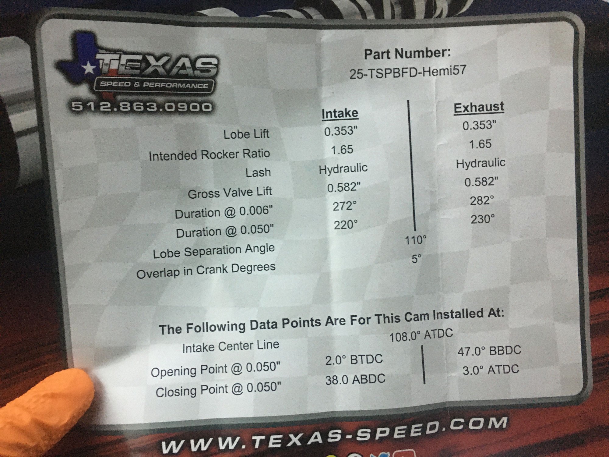

Since we are talking about them we slammed another cam into a retired interceptor recently actually.....

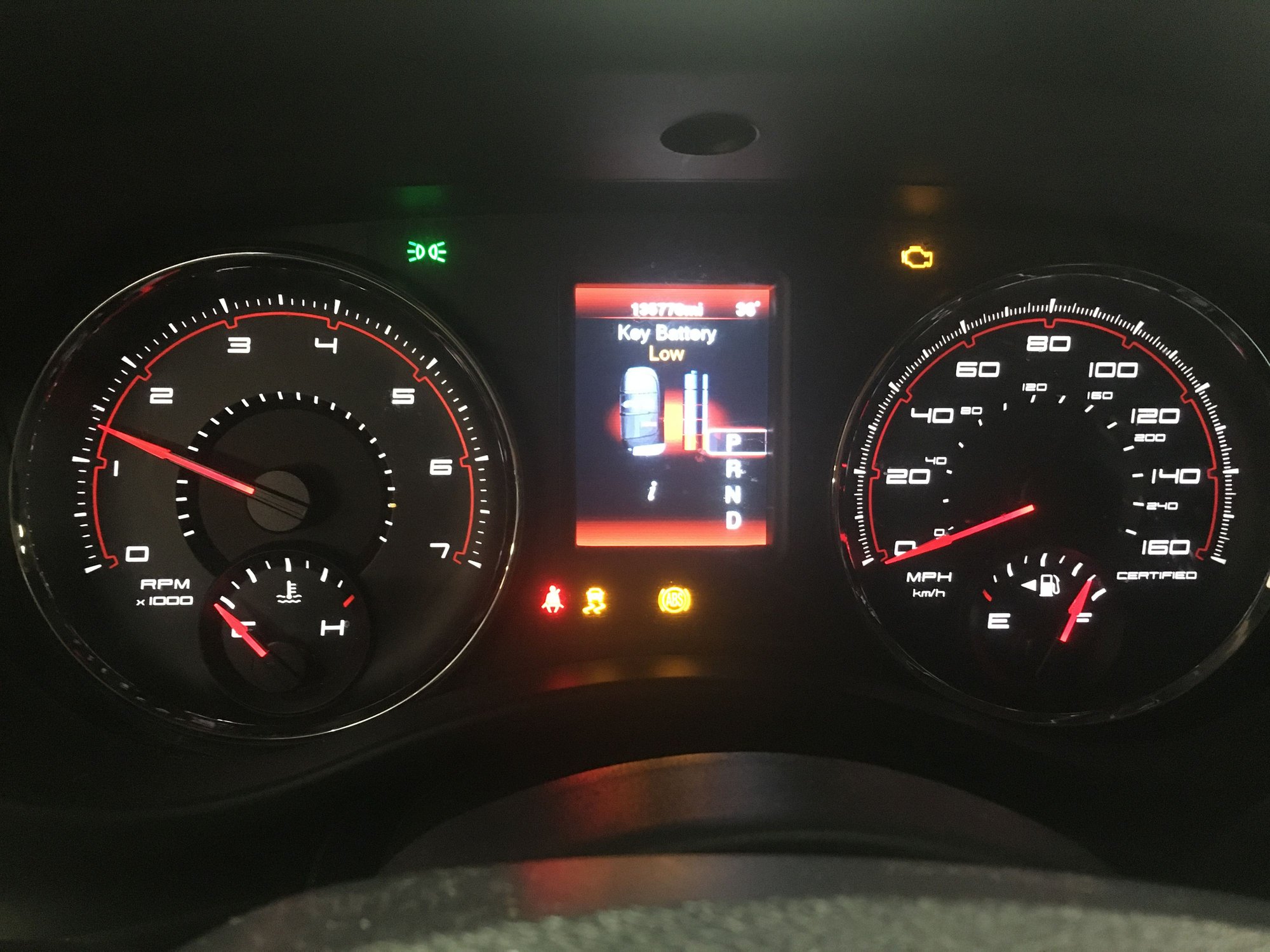

These warn if the keys are low as well

Texas Speed is a shop that sells engines and parts nationwide.

As stated they are a performance shop that offers a magnitude of after market parts for various platforms ford gm dodge etc. They had built the motor for the worlds fastest stick shift corvette a few years ago.

That's just cool lol nothing crazy either 272/282 did you tune it or reflash the stock computer?
This is immediately after a base tune reflash, engine was built for more revs and a slightly higher CR etc etc since the owner blew up the stock bottom end. He didn't want the usual stage 4 cam for some reason so he bought that one, I usually recommend the max NA cam since it's a known 380whp combo.
Its on him now to take it somewhere for proper custom tuning
