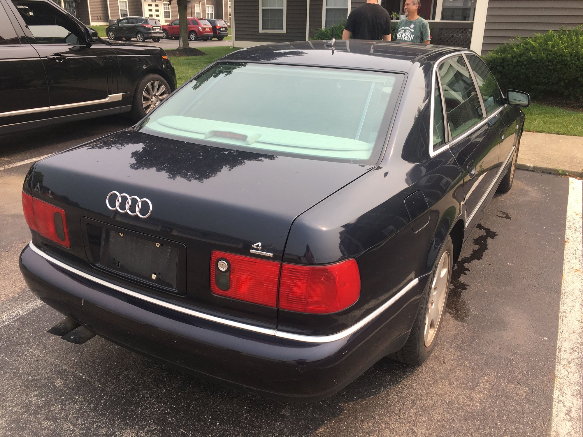

Anyhow here are initial pictures! I am so looking forward to this! So cool to have a D2 in my immediate circle/have a key to one!

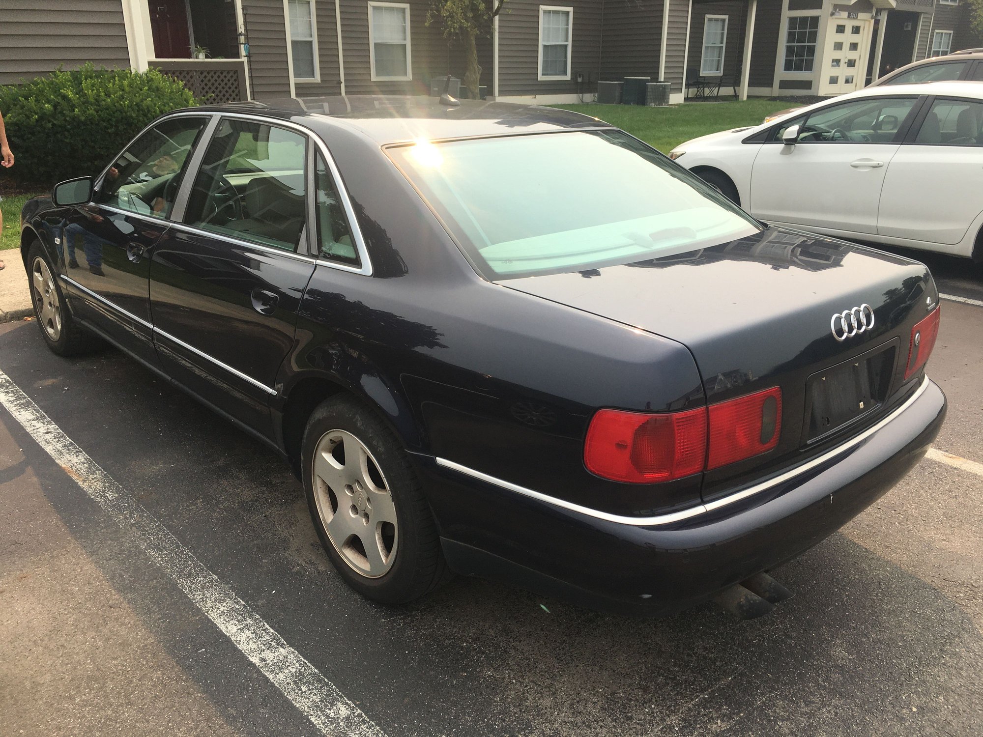

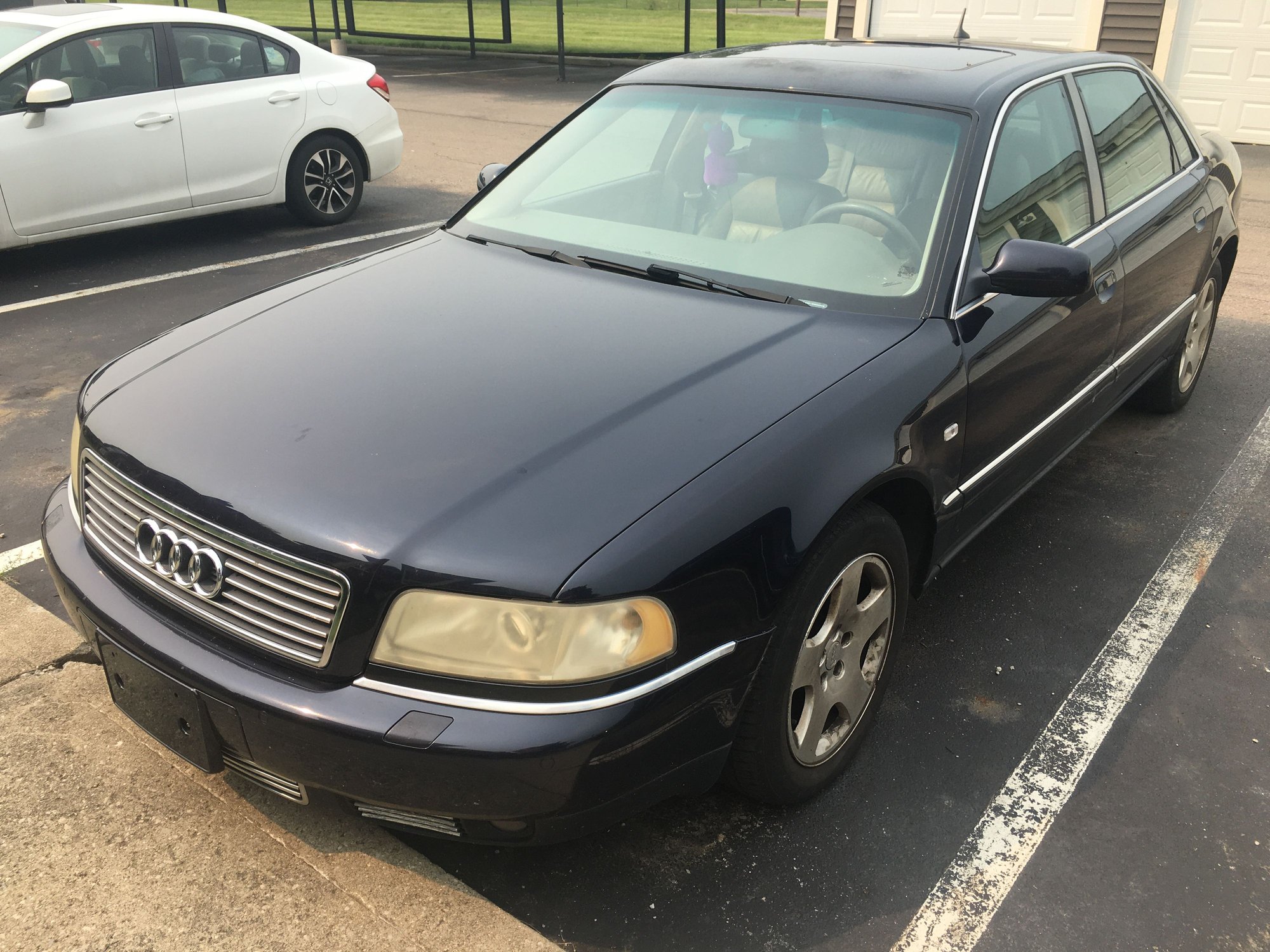

Paint is not as far gone as my other best friends XJR was so it will end up looking amazing once I'm done with it.
Some idiot put a flowmaster muffler on it.....that's getting cut off and replaced with stock or a high end valved unit. Totally unacceptable for this type of car
Badges fell off but we have them all, it will be up to him if they end up back on the car or not.
Headlight are \"cheap" so he may chose to just replace them outright. They are only $300 or so each vs $970-3800 on my cars meaning there is actually a valid decision to be made lol!
Rims are meh, plan is to use the alternate set and have these professionally restored and equipped with PSAS4s

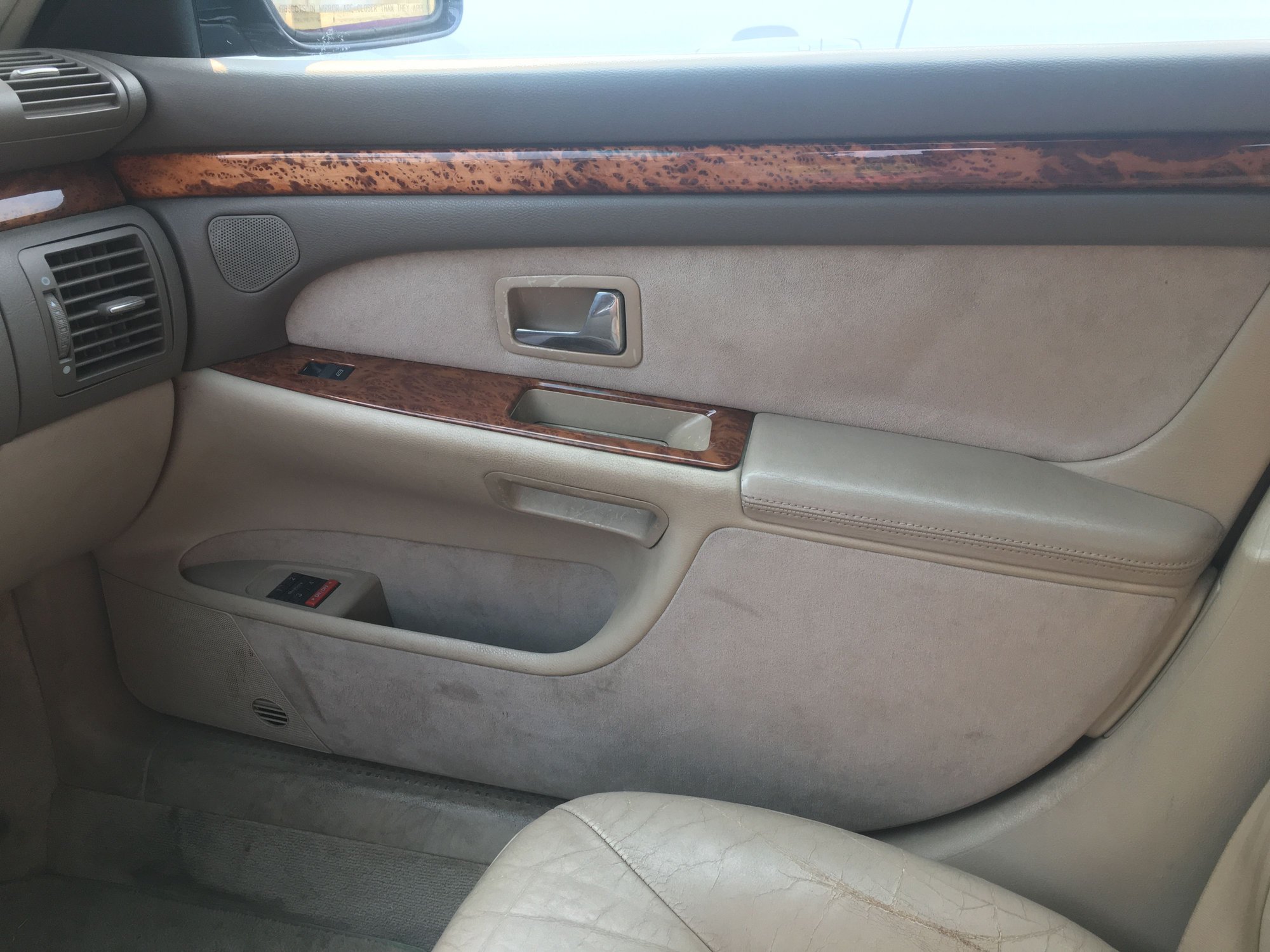

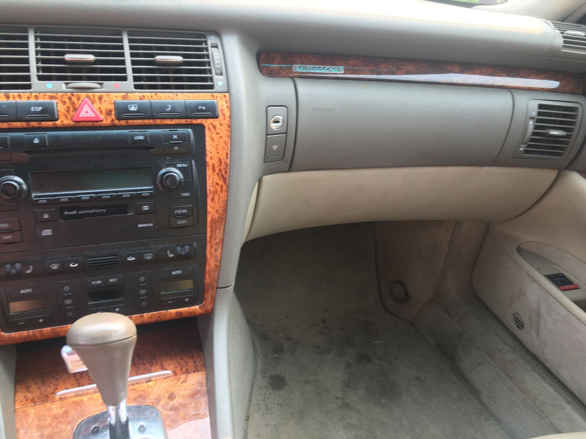

Interior is dirty but has held up well, the huge amount of suede and soft touch is a double edged sword. Amazing when correct but god it looks back and eats your time to correct if left go.
Not my favorite color combo but he may just import a full Audi exclusive interior from Germany.

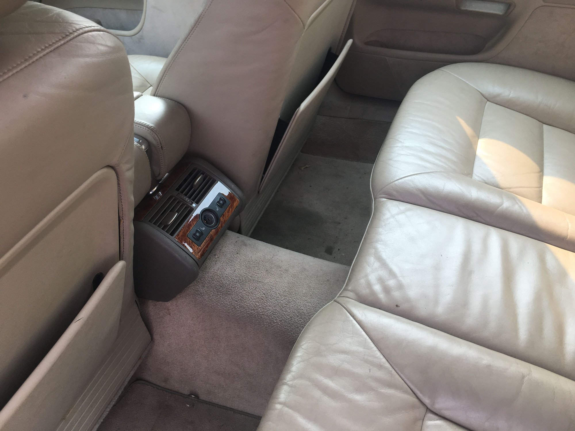

Rear seats are meh as well, doesn't need outright replaced like the front but we will see how recovery goes.
Rear heated and lumbar adjustments, nothing insane these days but this car does have ALL original equipment and all rear sunshades plus the full laminated glass package.

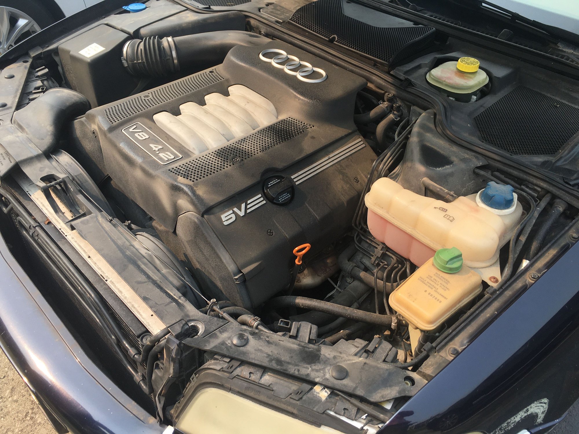

The legendary Audi V8. Easy to work on, very reliable, and decently powerful with long legs.....the RS6 engine fits in here as well as a manual trans option.... I think you guys can tell why I wanted to buy this myself lol!
Very roomy, the front end comes off very quickly so it's a snap to work on stuff. Again note that somehow all covers are present, that's very rare with these cars.

5 valves per cylinder?! i didn't realize this car was a 4-door F355!

The 5v engines sound really really cool at redline, much smoother than the 3uz in terms of power delivery as well and longer legs. Low end power is less though, the VVT-i system really helped Lexus in these years

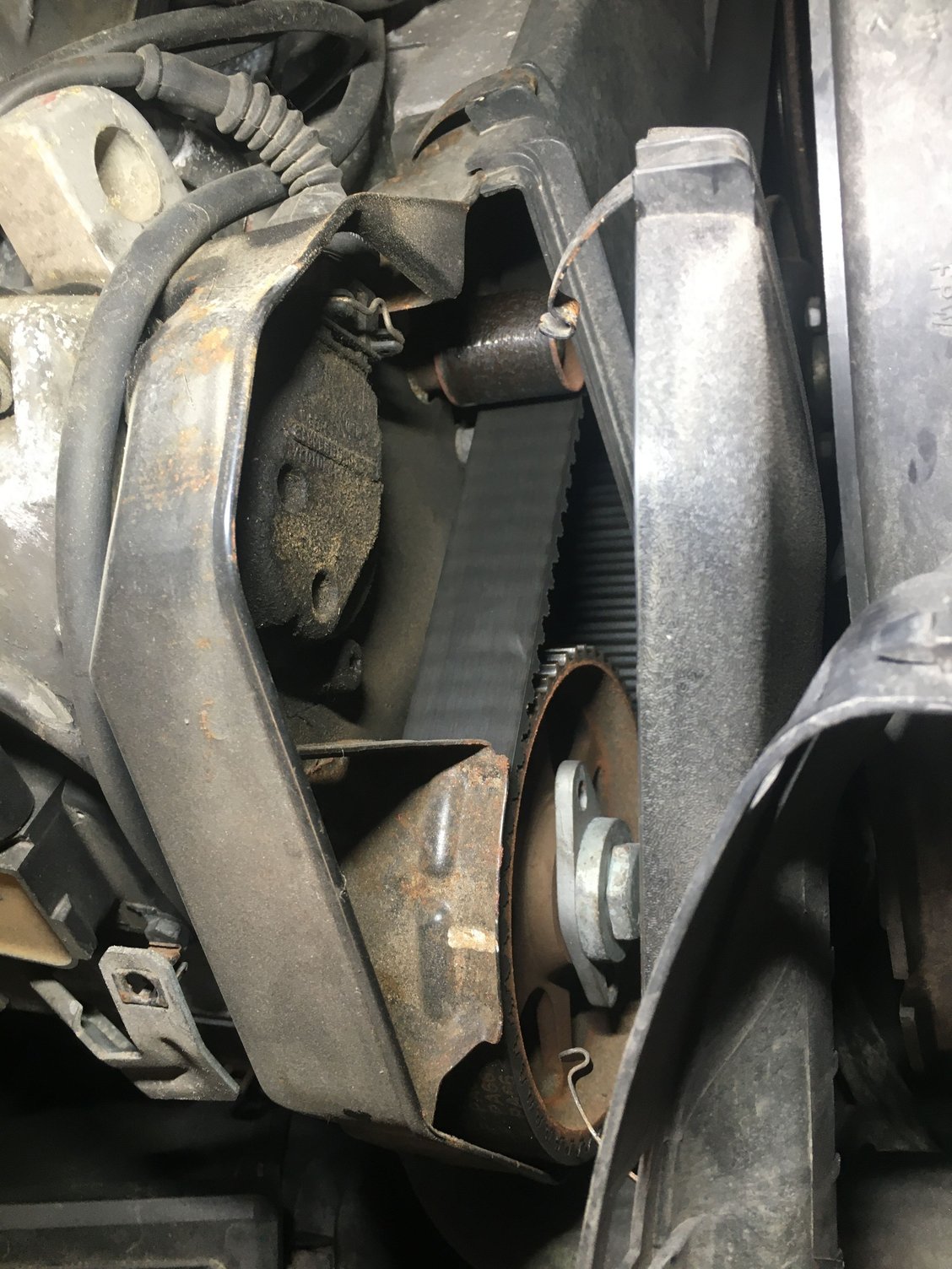

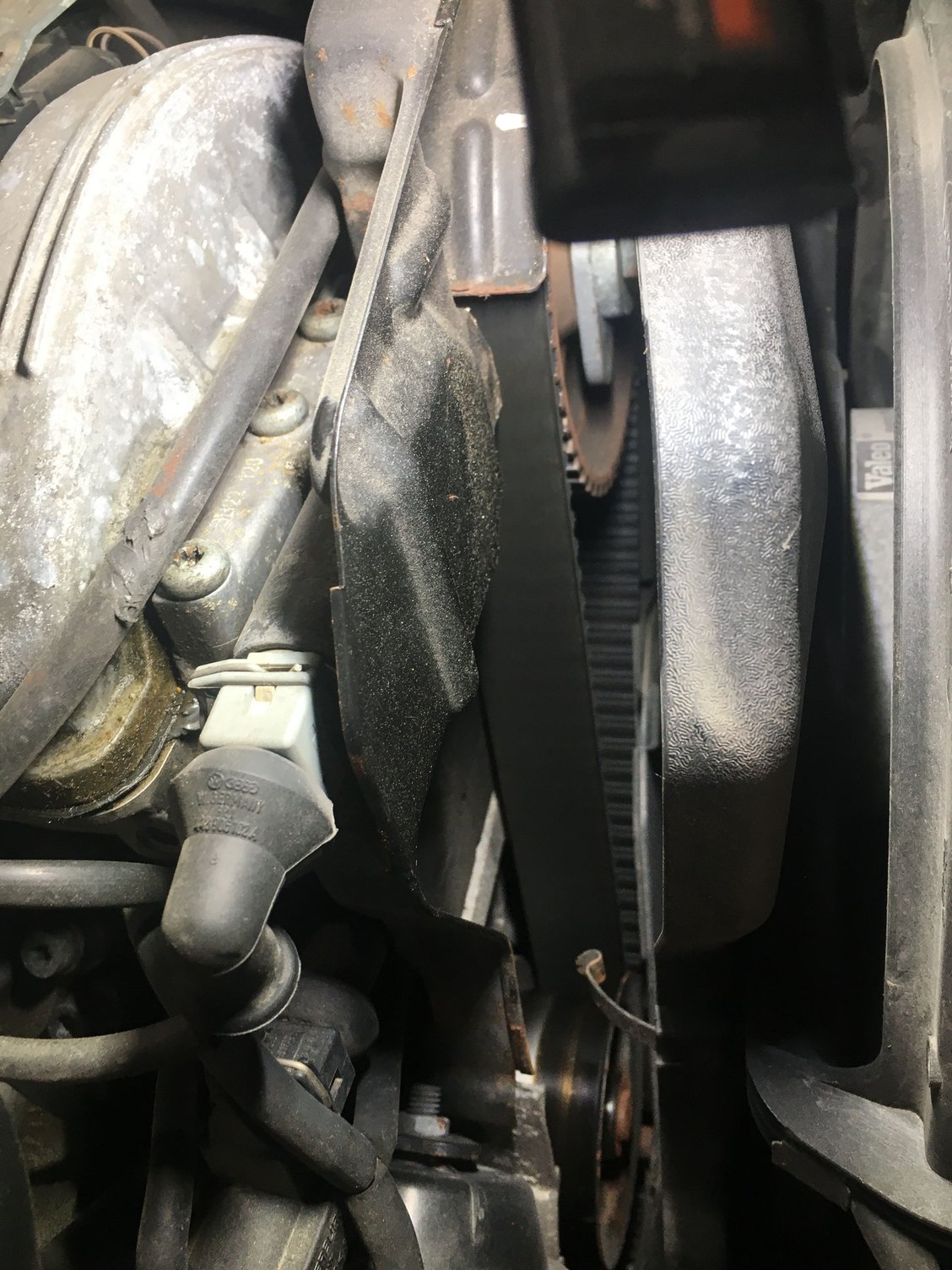

Timing belt was replaced when the prior owner said it was but they never replaced the idler or tensioners
Still, it's insanely easy to check and also by far easier to actually do than the LS430 or any Lexus belt engine.

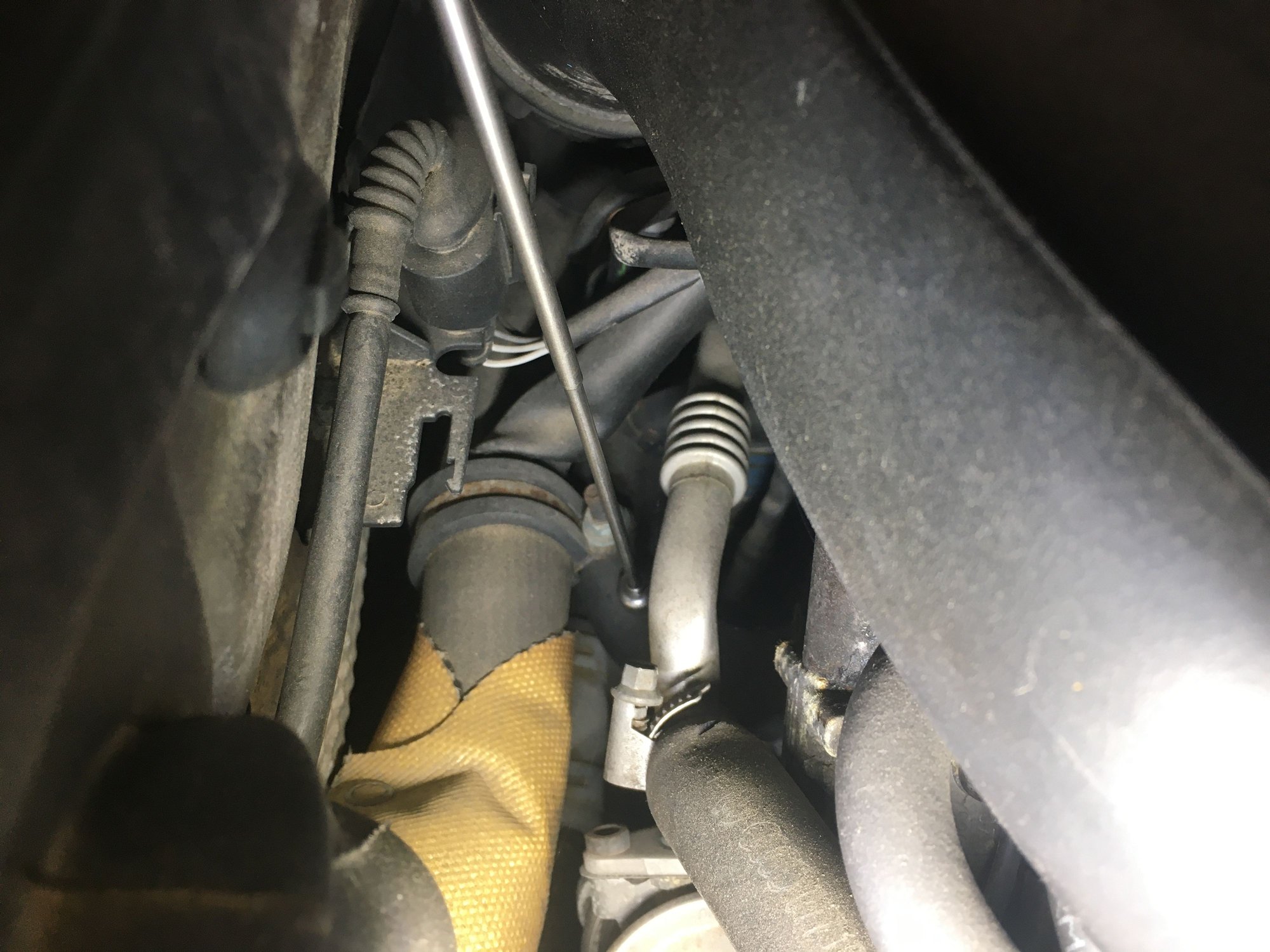

Rear coolant pipe we were concerned about is actually metal from factory on this car, so that's one major annoyance avoided

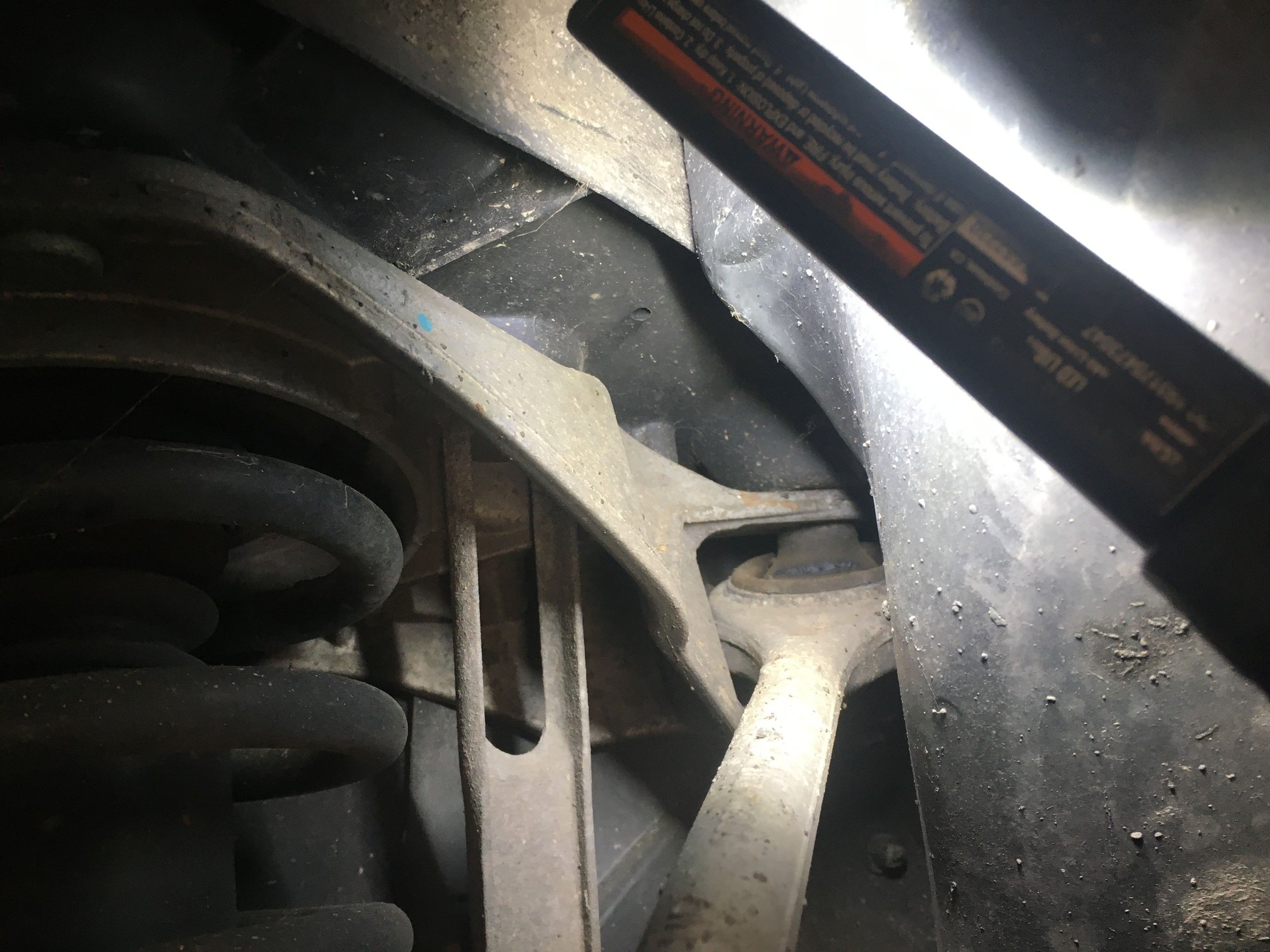

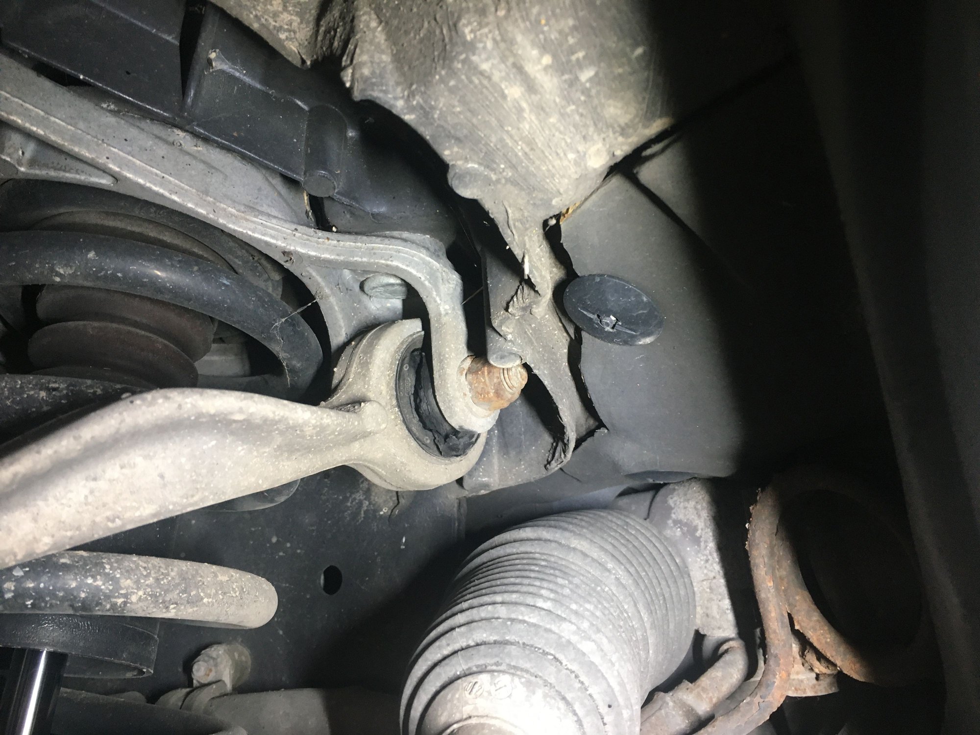

Front upper arms are torn, you can't feel it yet but they are way past the point of needing replaced

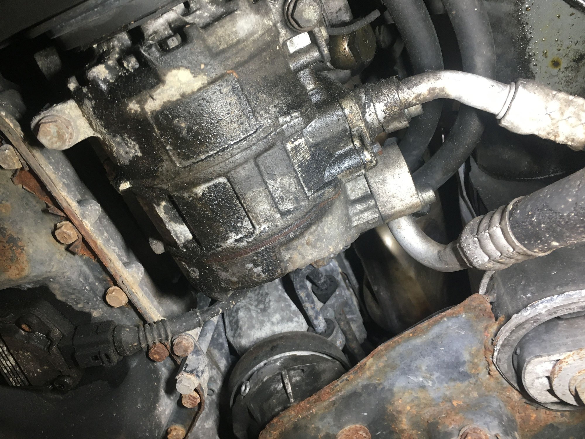

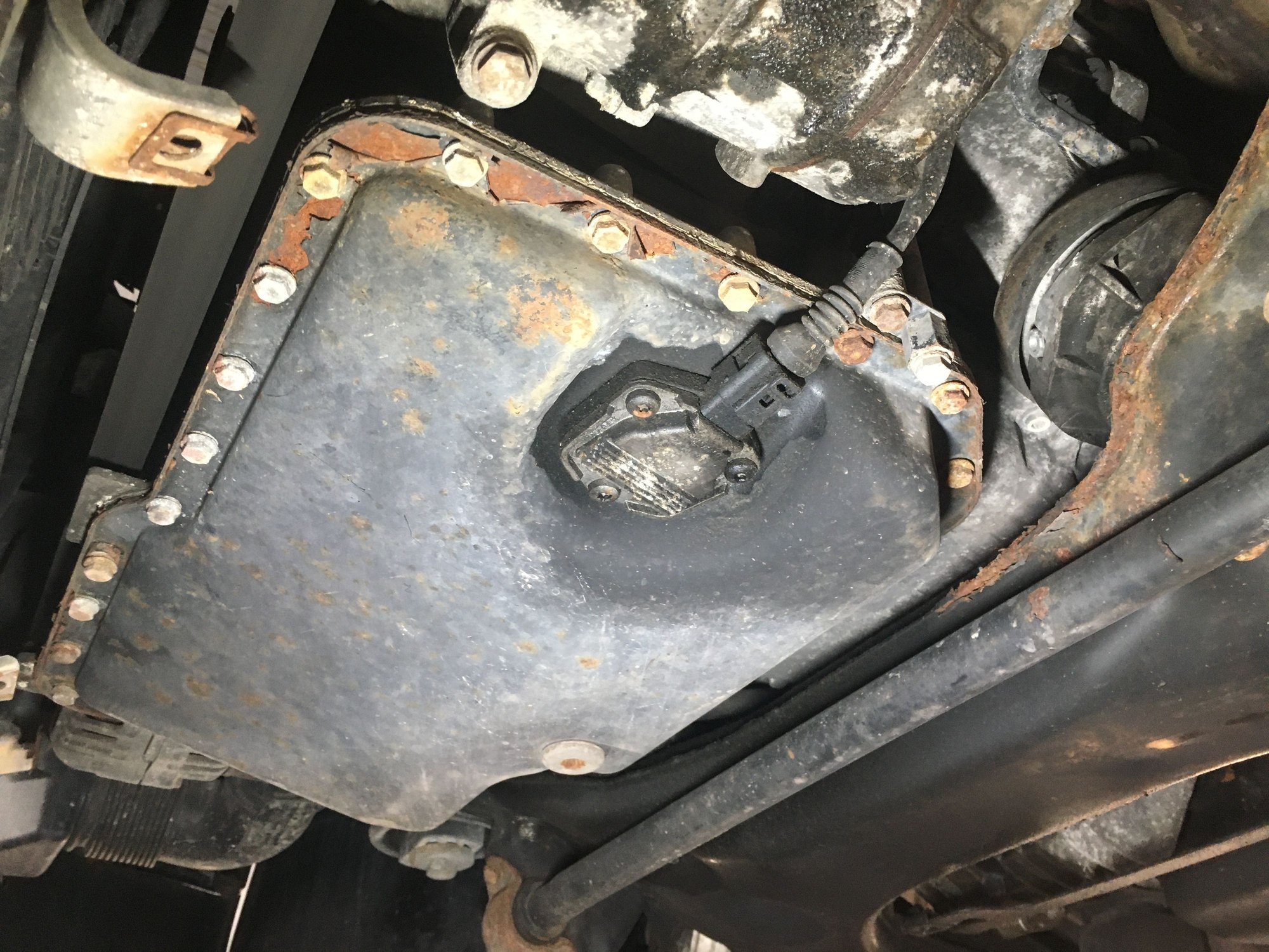

Oil leak on drivers side looks bad but it's just the leading edge of the valve cover. Only 2 hours book time to do both
Otherwise dry/good
