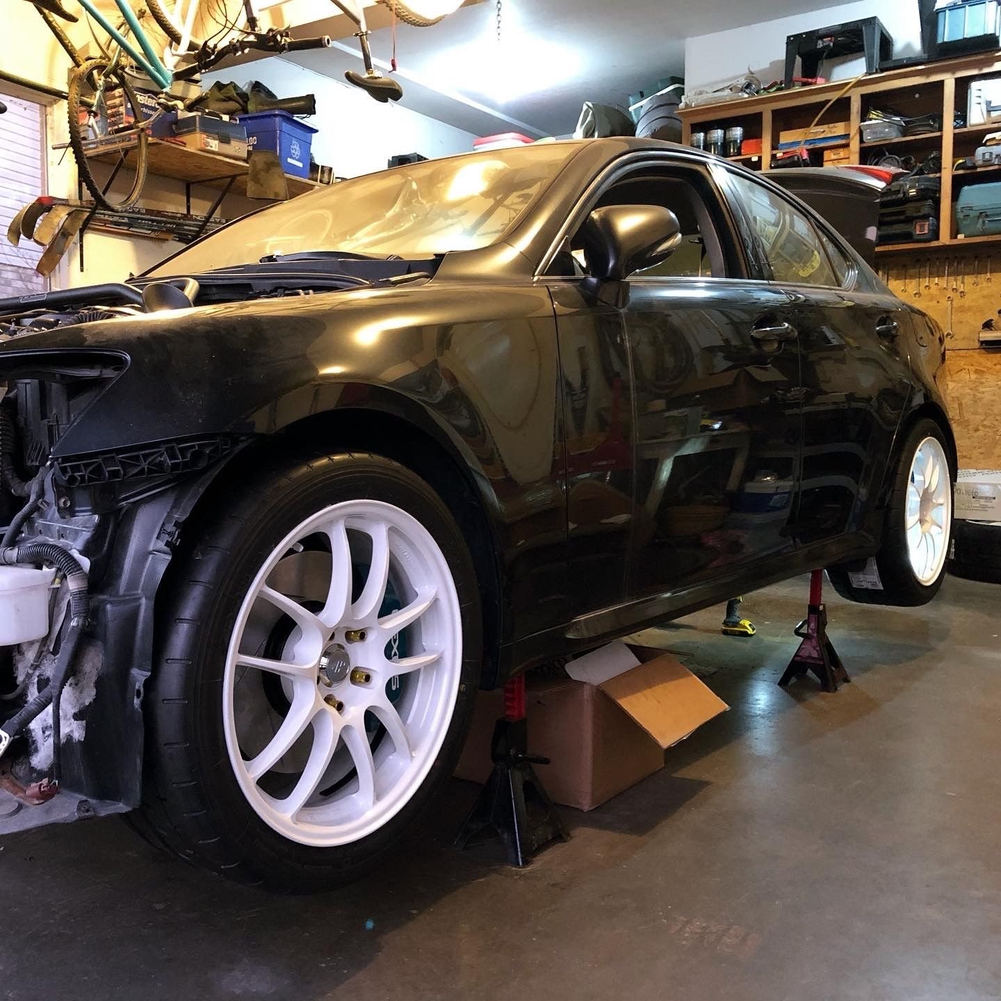

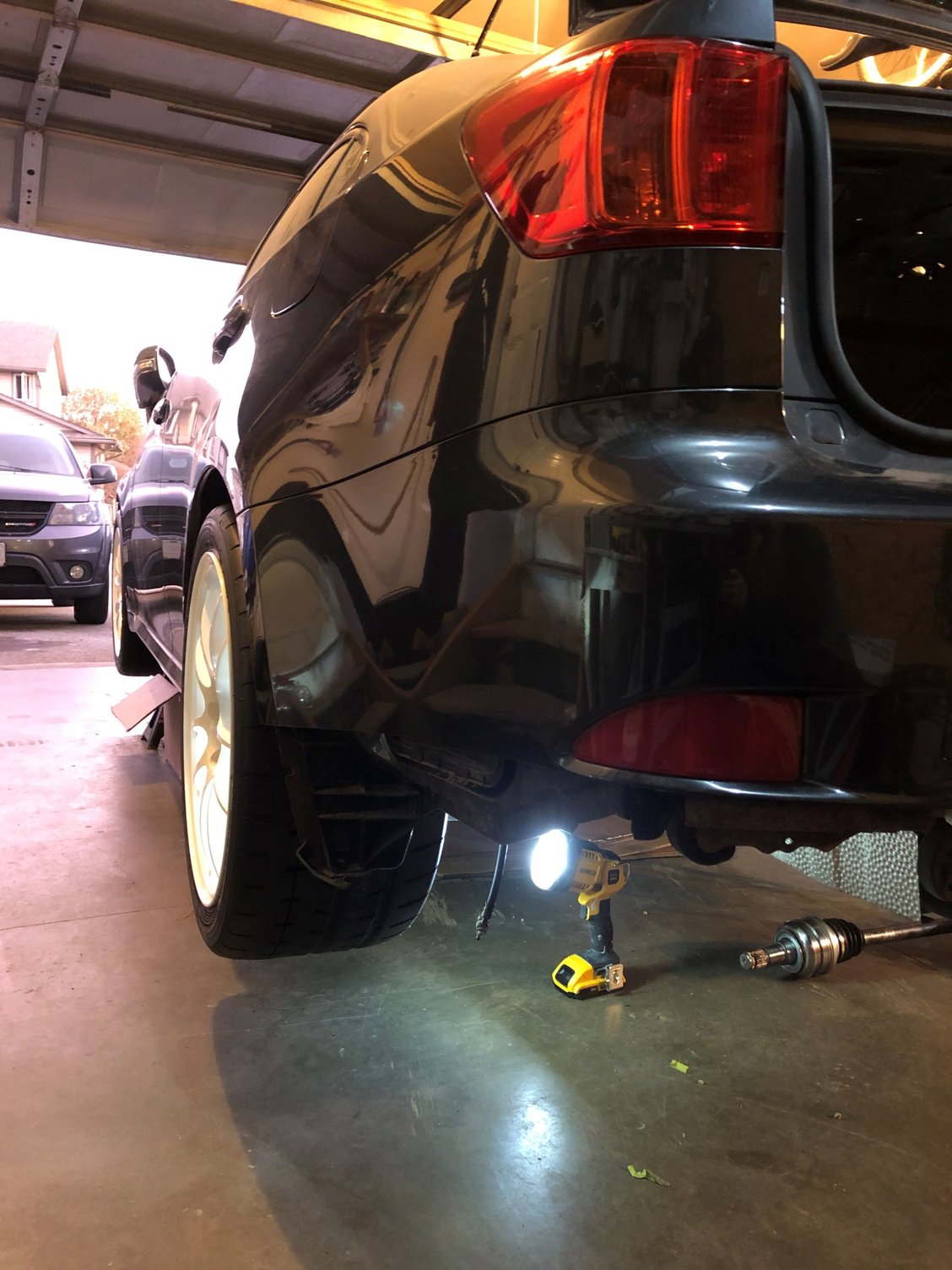

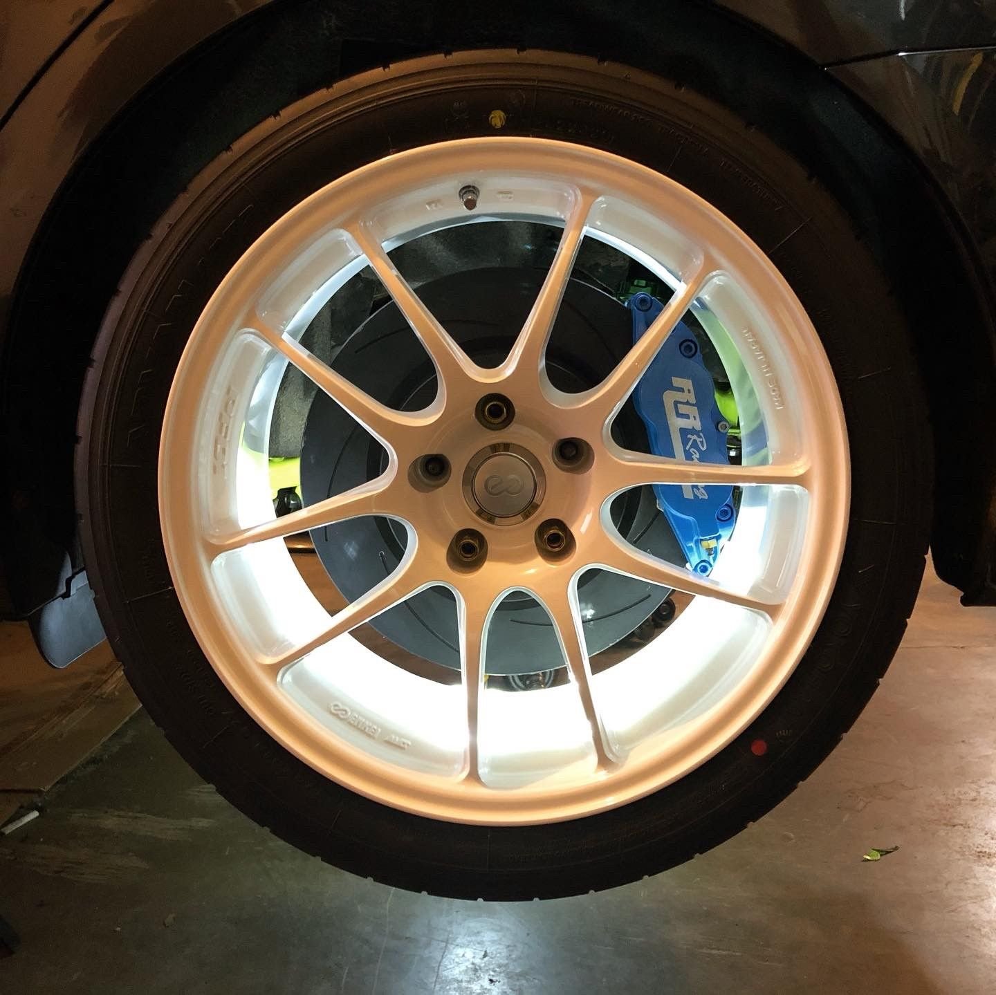

Car is really close to being put back on the ground and sent out for alignment/suspension setup. Last time I mentioned some confusion with the front brakes and not knowing what they actually were. So, because I'm an idiot and don't check part numbers when I receive parts I failed to notice that the first pair of rotors I received from the performance shop were actually for the standard single piston front brakes making them 12.6" or something along those lines (even though I specified several times to the guy that I needed the bigger 4 piston caliper rotors). I just ***-u-me'd that they were the 13.1" variants which lead me to believe that the calipers were off a GS350 which needed a 14" rotor. Was still super confused because they didn't look like the GS calipers. After getting the proper 13.1" rotors from the fsport IS350, now the front brakes fit perfectly.
Also while I was putting the rear end together I bought new CV axels off ebay (aftermarket) and the advertisement had the left and right mixed up. So when I first put them on the right side CV was way too far into the wheel well, and the left was sticking out past the fender. If anyone buys new CV's remember the longer CV goes on the passenger side and the shorter one on the driver side.
I'm really pleased with how everything is coming together. Now that I'm almost done all the boring **** such as bushing and arms, the fun can begin with aero and custom fabrication.
( Notice the back bumper )
Props to RR-Racing for engineering great products such as this rear BBK utilizing Wilwood calipers.
