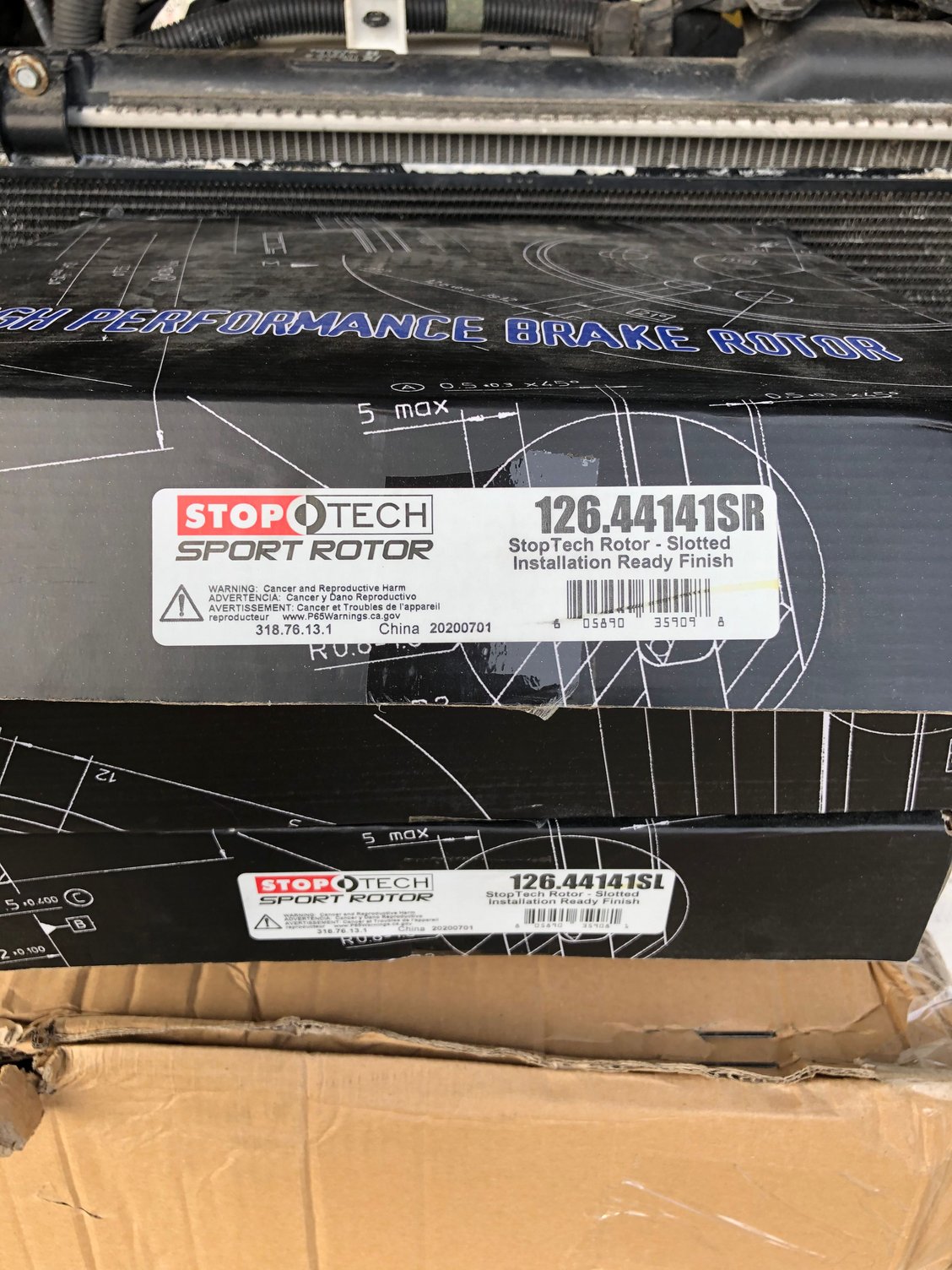

Wheels came in today! They'll be going in for powder coating soon which is why tires aren't mounted yet, but couldn't resist putting one on the car. I'm seriously considering upgrading the brakes to the RR-Racing Wilwood kit front and back now instead of the IS350 upgrade. I know the car is currently under-powered for large BBK kits but ultimately the stock engine is going to be removed for something more powerful. So if anyone would like to buy this setup send me an offer!!
They're IS350 4 piston Advics Calipers powder coated, comes with Lexus oem rebuild seal kit for both sides. Brand new Stop Tech sport rotors. No pads.
Backs are used IS350 single piston calipers, with brand new Stop Tech sport rotors. No pads.
Excited to start playing with ride height once the tires are mounted. Advan A052 245/40/18, 265/35/18!

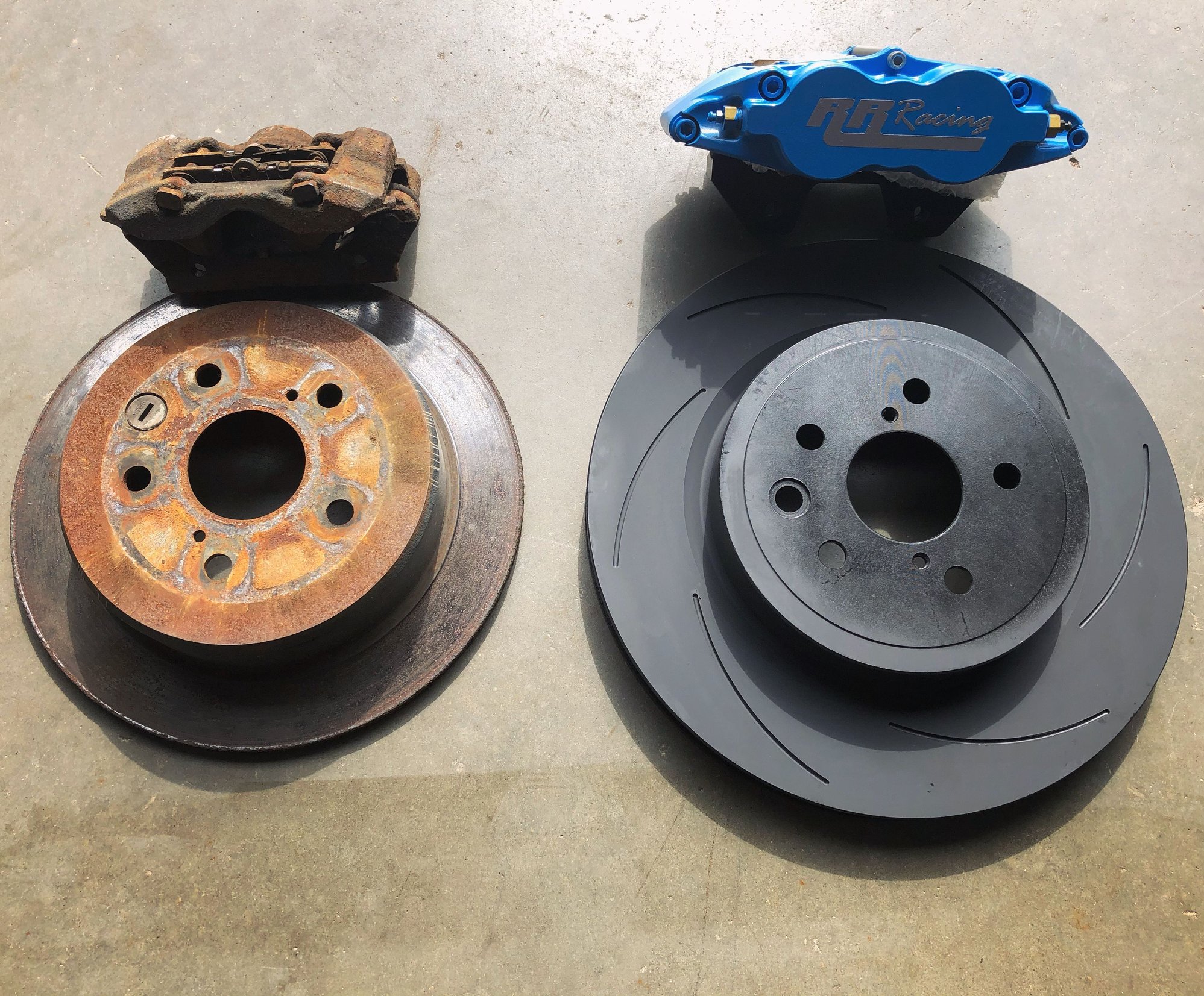

The build has slowed down a bit because my work has started to get quite busy causing me to work overtime and on the weekends. On the plus side it's more money for the car, but on the down side I have no time to make it over to my dad's house where Lexy is being built.
As mentioned before I decided to pull the trigger on the RR-Racing rear brake kit. Massive difference in size compared to my oem non-ventilated rotors. Can't wait to feel the results!
I rebuilt the front calipers with new seals, shims, pins, and pads. Unfortunately when I went to put them on today I noticed that there's about a half inch gap at the top of the pads where the rotor ends making the rotors too small. I bought these calipers second hand off Kijiji and the guy said he bought them off ebay then while they were getting powder coated, he totalled his car before he had a chance to put them on. Also said they were from a 2IS 350. The problem with sites like Kijiji and Craigslist is who actually knows the real story on why they're selling them and where they came from. After doing some more digging and research I've come to the conclusion that they're actually from a GS350 which has a 14" rotor, which makes sense with the half inch gap difference on the 13.1 inch rotors. So I'm going to try and get some Stoptech 14" rotors for the front from a GS and see how that goes?...
At lease now my back brakes won't be bigger than my front brakes lol.
I also decided to get Figs rear LCAs instead of my Megan Racing ones just to keep it all Figs in the back.
So currently for sale I have Megan Racing rear LCAs in 99% mint condition.
And brand new Rear ventilated brake rotors for a 2IS 350.
