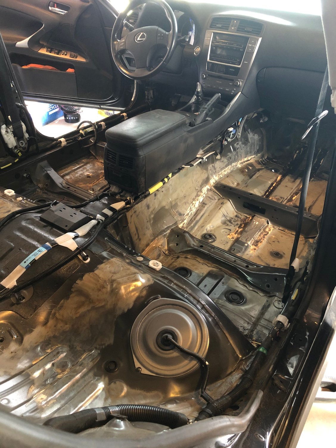

In the past couple months I've slowly been working on the car over weekends. I've stripped out the interior bits from the cab and the trunk at an attempt to lighten this pig up. Eventually a custom 6 point cage will be put installed to stiffen everything up.

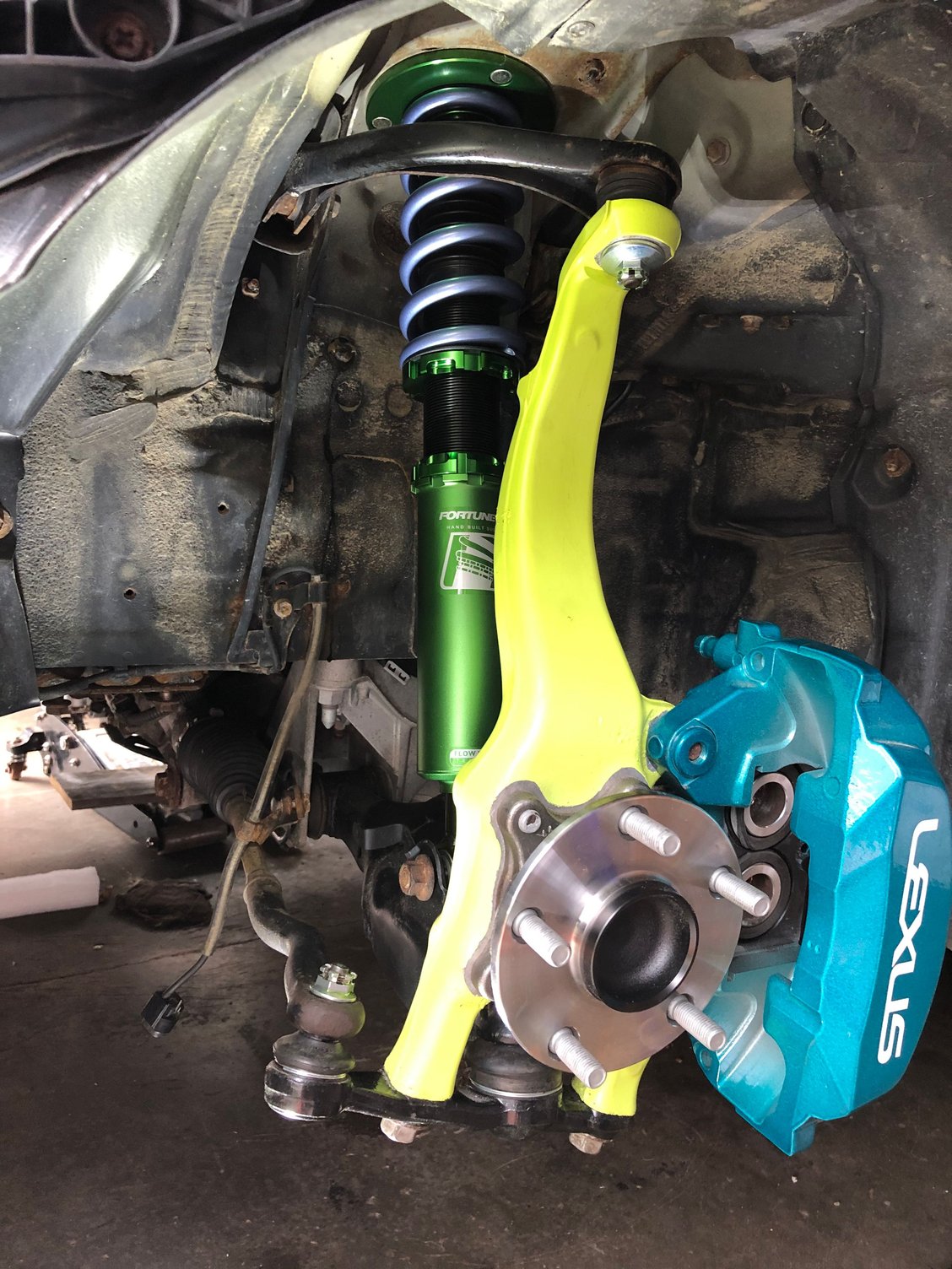

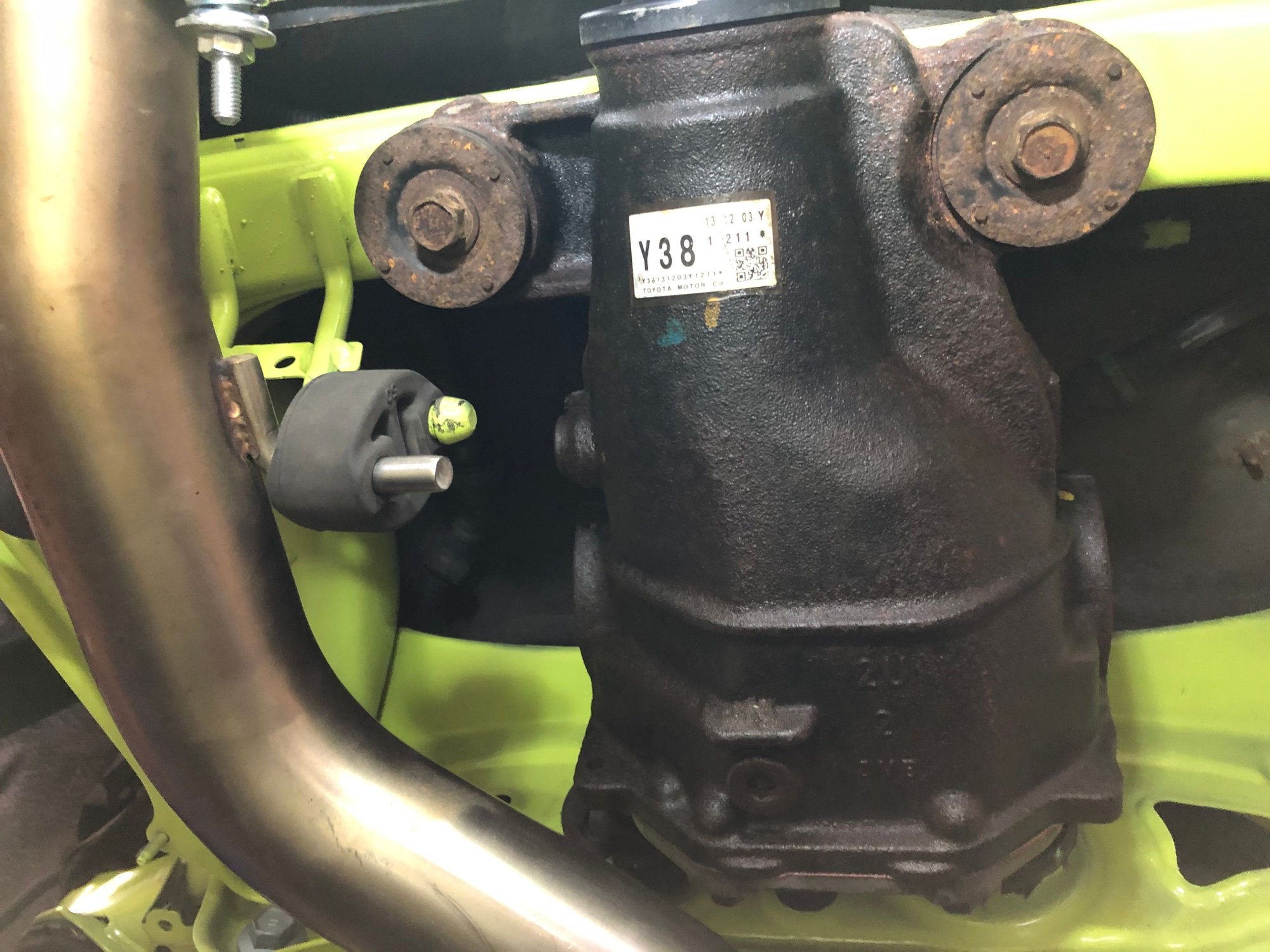

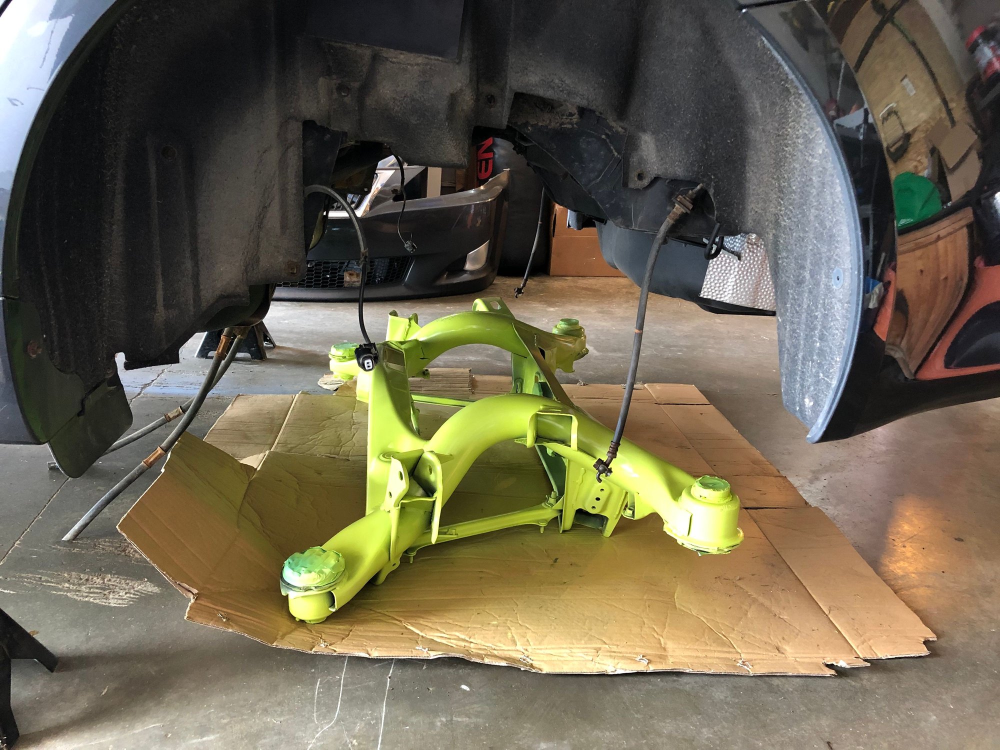

I've completely dismantled the rear end. Bought the carrier assembly from a BRZ to get that torsen LSD setup. Ordered many parts from Figs Engineering and RR-Racing to really dial in the new Fortune Auto suspension setup. Also upgraded to IS350 brakes with the larger 4 piston front calipers and vented rears to hopefully eliminate brake warping...which I've done a couple times with the stock 250 brakes .

You might see about mounting the rear sub-frame solid and using either poly or aluminum bushings for the rear diff. It should make it more predictable.

Definitely looking into getting different bushing for the sub!

Still waiting for my wheel setup, brake rebuild kits, and sway bars to arrive so the car is still on jack stands for now.
Here's some other things I've been working on lately.
Installed Dual Wideband from Glowshift into the driver side air vent. Made a custom adapter out of PC-ABS plastic that fits perfectly with no gaps!
Installed BRZ Y38 Torsen LSD differential into subframe. Still looking at getting poly or aluminum bushings made for the subframe mounts.

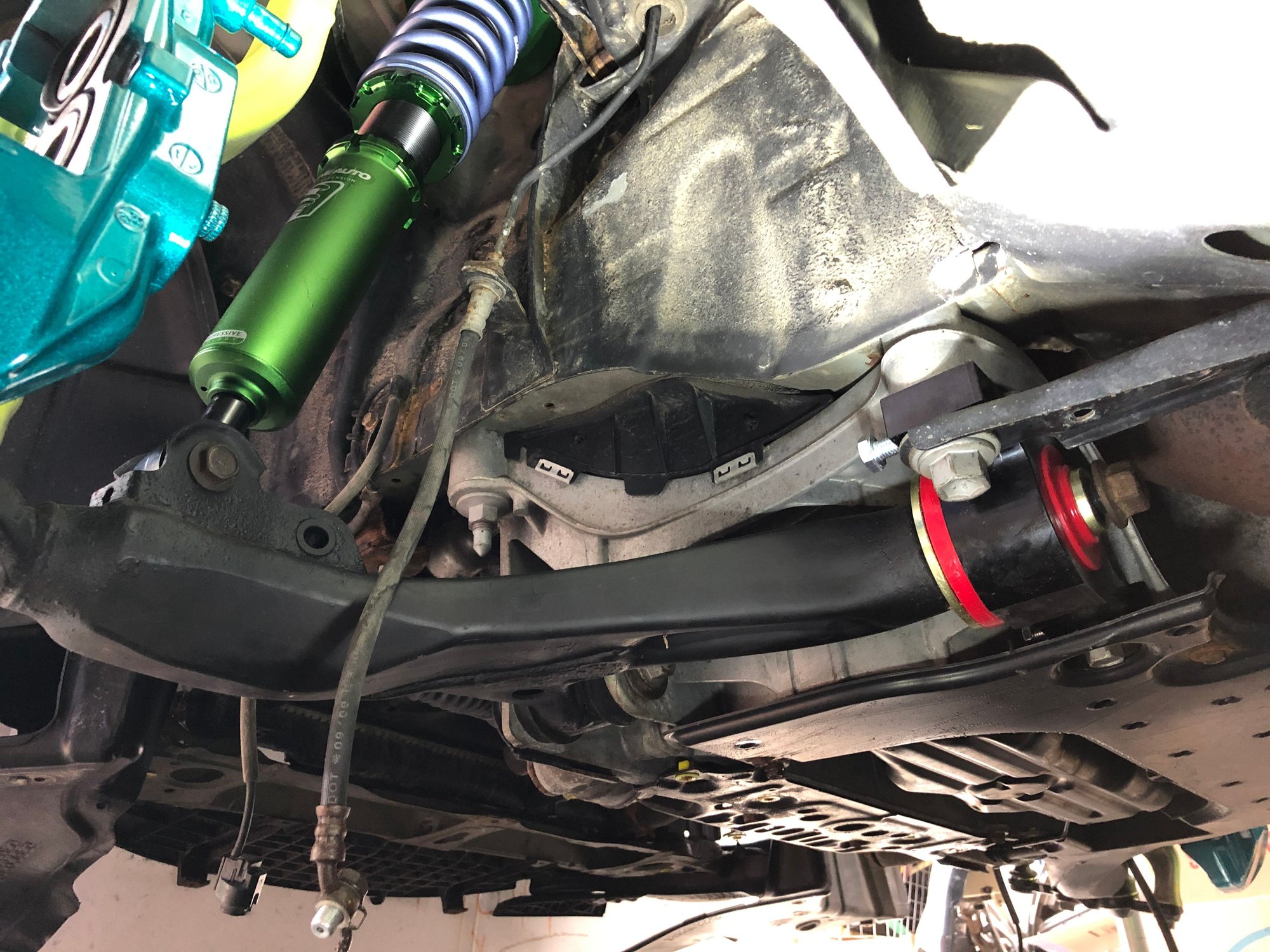

Installed RR-Racing LCA rear bushing to minimize the front wheel movement where there should be no movement.
Test fitting. Note, I didn't plan on these colours, things just kind of happened this way. But I'm not upset about it, looks tropical.
Also got a front tower brace from RR-Racing. Not only adds strength to the front end, but looks badass while doing it!

I hear ya dude. Building a car without a lift sucks! To be honest though, changing the diff wasn't too bad with two people. I used a floor jack to get it up to the level it needed to be, then gave it the ol' heave-ho with one arm while my little brother got the bolts in the ears. Worst part was getting the driveshaft to line up into the locator ring.
